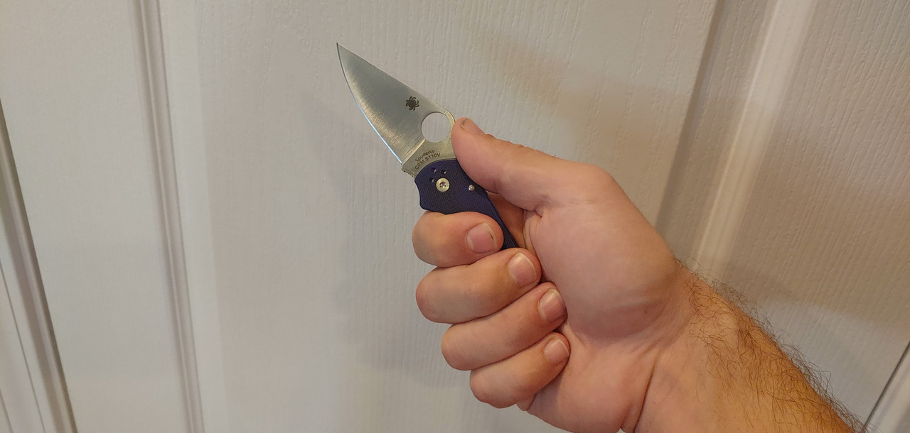

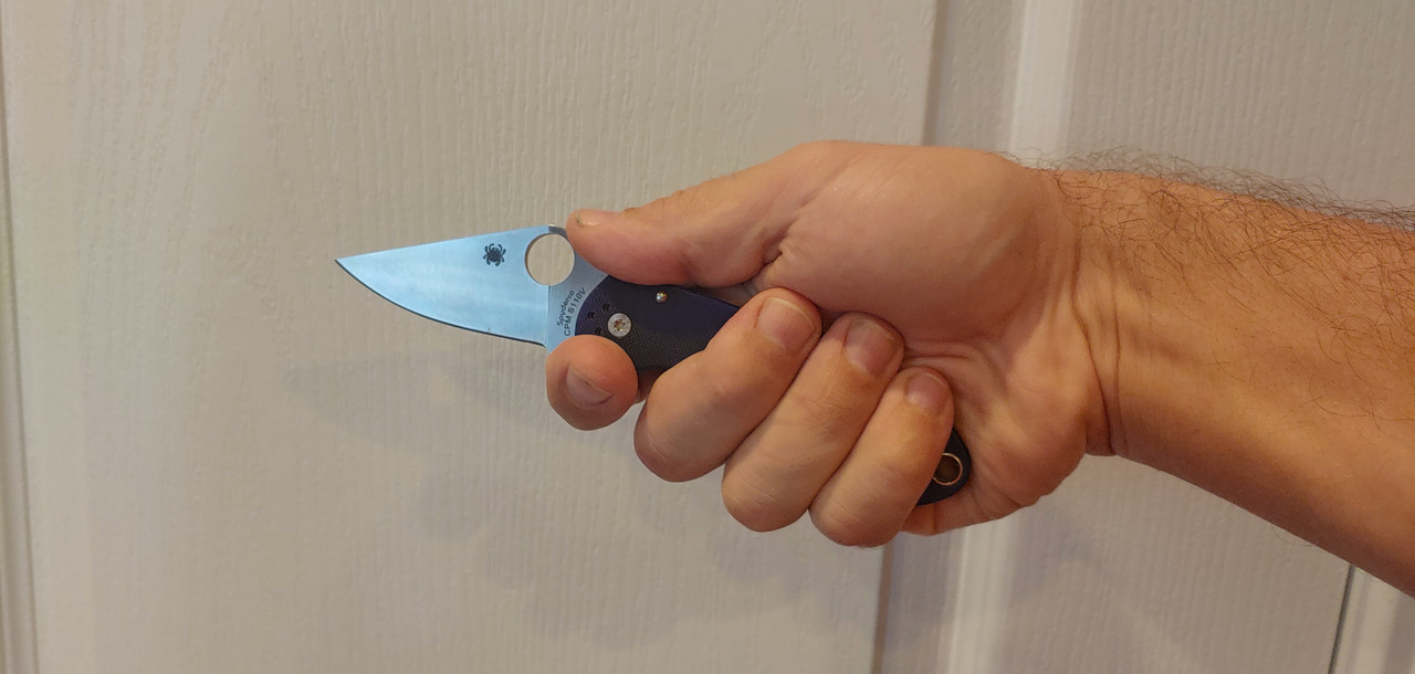

Today I received an S110V Para 3 to sharpen. I figured it'd be fun to take some time to see how the ergonomics work for me and share some photos.
Right now I don't have enough time to do anything but post a few in hand pictures. So, here's how a Para 3 looks in my hands:

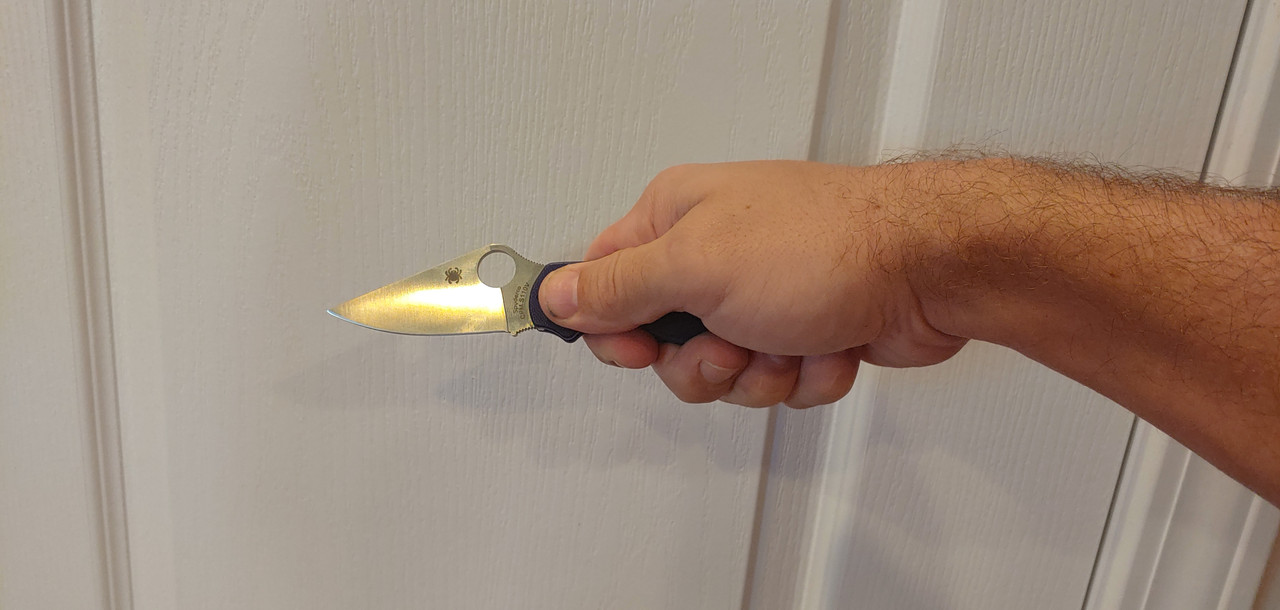

For reference, here is my Police 4 Lightweight in the same grips, which is my preferred folding knife size - viewtopic.php?p=1459455#p1459455
Unlike the Para 2 I can't quite squeeze my full grip in behind the choil unless my pinky hangs off the rear end of the handle, which is what I expected having handled a LW version a few months ago at SMKW.
Overall it kind of reminds me of a really beefed up Caly 3. The ergonomics have a lot of similarities to that design, but its definitely more of a tank. Smaller than I prefer, but I understand the appeal.
Using the index choil its more ergonomic than I remember. The part of the handle behind the index choil is sized well for locking my middle, ring and pinky fingers in, while using the same grip on the Para 2 there was a bit of a gapbetween my pinky and the rear handle hook. So for people that prefer the index choil grip, it feels more secure for draw cuts in that sense.

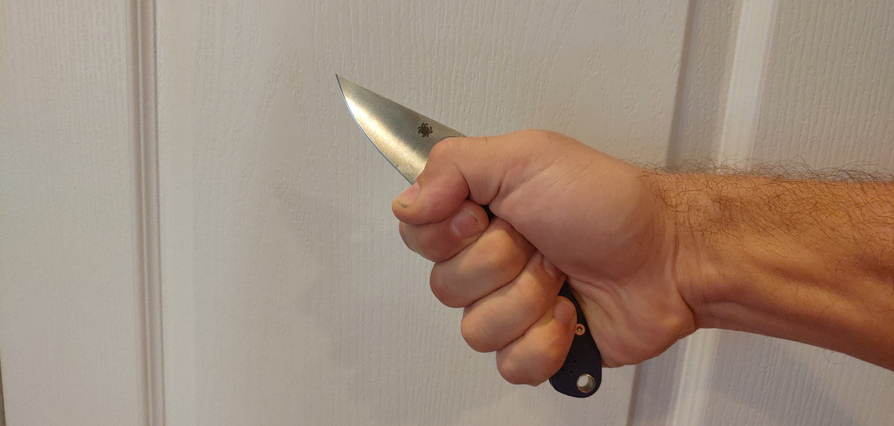

I've heard from a lot of people the idea that one only needs a knife with a blade the length of their index finger. So what may work for someone with large hands might not feel best for someone with smaller hands, and vice versa.carrot wrote: ↑Fri Oct 09, 2020 11:04 amVivi, I know that you strongly prefer a large blade for typical tasks but I'm wondering if you've ever had issues with tip control as compared to smaller knives. I EDC'd a Police4 in your honor for a few weeks and found it surprisingly easy (and quite fun) to wield, but in the end I find knives in the P3LW, D4 size to be wielded most naturally, I think, because as one poster said in a different thread, the blade is roughly finger-length. Stepping up one size to the Endela/Stretch, I can easily wield knives with fine tip control by putting my index finger down the spine and my middle finger on the ricasso/choil, or by pinch-gripping the blade with my index and thumb, but the tip extends just too far with the E4/P4.
For example, if you look at Julias in-hand photos (JuPaul), knives like the Delica and Para 3 appear to be an exceptional fit for her hand size. Likewise, my Manix XL and Police feel like a great fit for mine.
Looks roomy and comfortable in her hand.
Here's the same knife in my hand:
Much different fit.
To give you an idea of how different designs match up with my hand size, here is a Para 3, Pacific Salt 2, Manix XL, Police 4 and Szabo Folder lined up with my index finger. I took my photos lining up the beginning of the cutting edge with the mid point of my index fingers base knuckle:
As you can see, the blade that comes closest to matching my index finger is the Police. I don't have one on hand right now but the Military was always a perfect match in this respect.
While I would get more tip control with a Para 2 or 3 compared to my Police folders, using the following grip I find I get enough tip control for my uses with the larger knives:
That gets my finger right up behind the point. I find I have more tip control on a Police with that grip than I do on a Para 2/3 using the standard index choil grip with my thumb on the ramp.
One last set of photos for perspective. My palms are wider than a lot of popular models, like the Para 3, Chap and Delica 4. In fact they're wider than the Manix XL's grip. While I don't use the following grip often, it works better on more open ended handles like my Police and Pacific 2's:
So for my grip, a roomy handle with a more neutral shape feels the best. Knives like the Police, Endura 4 and Military come to mind. While I prefer the size of the Police, the Endura 4 / Pacifics hit the sweet spot of comfortable ergonomics and compact size allowing for ease of carry.
