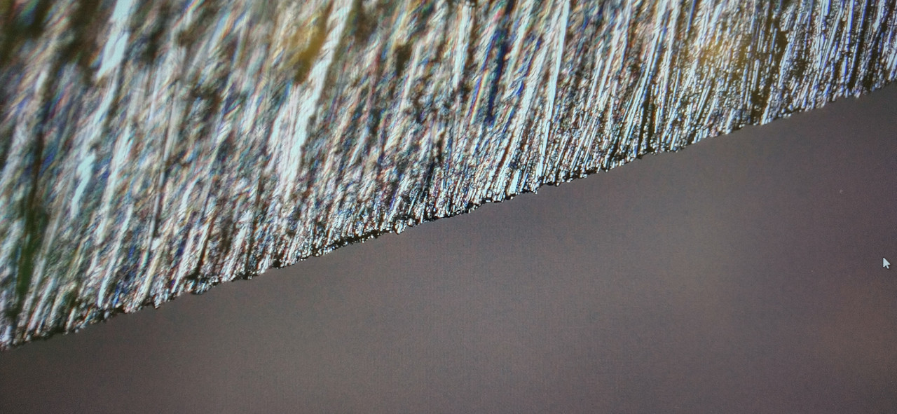

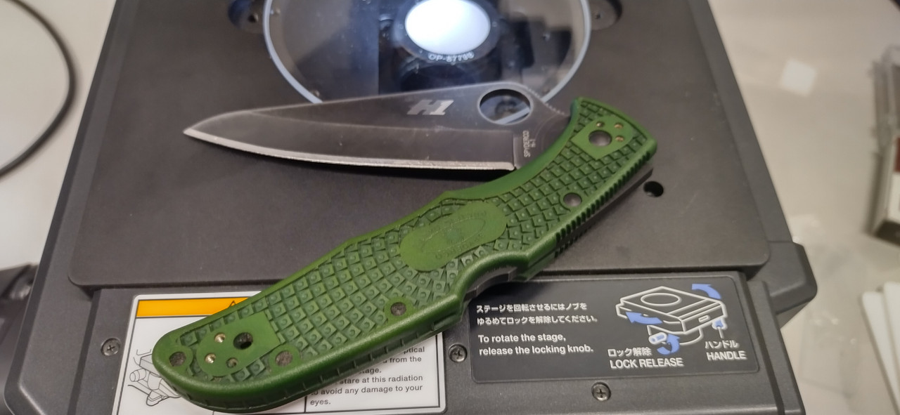

I've got access to a lab that has all sorts of test equipment. Most of it isn't applicable to our hobby, but they do have a really nice digital microscope for looking at edges.

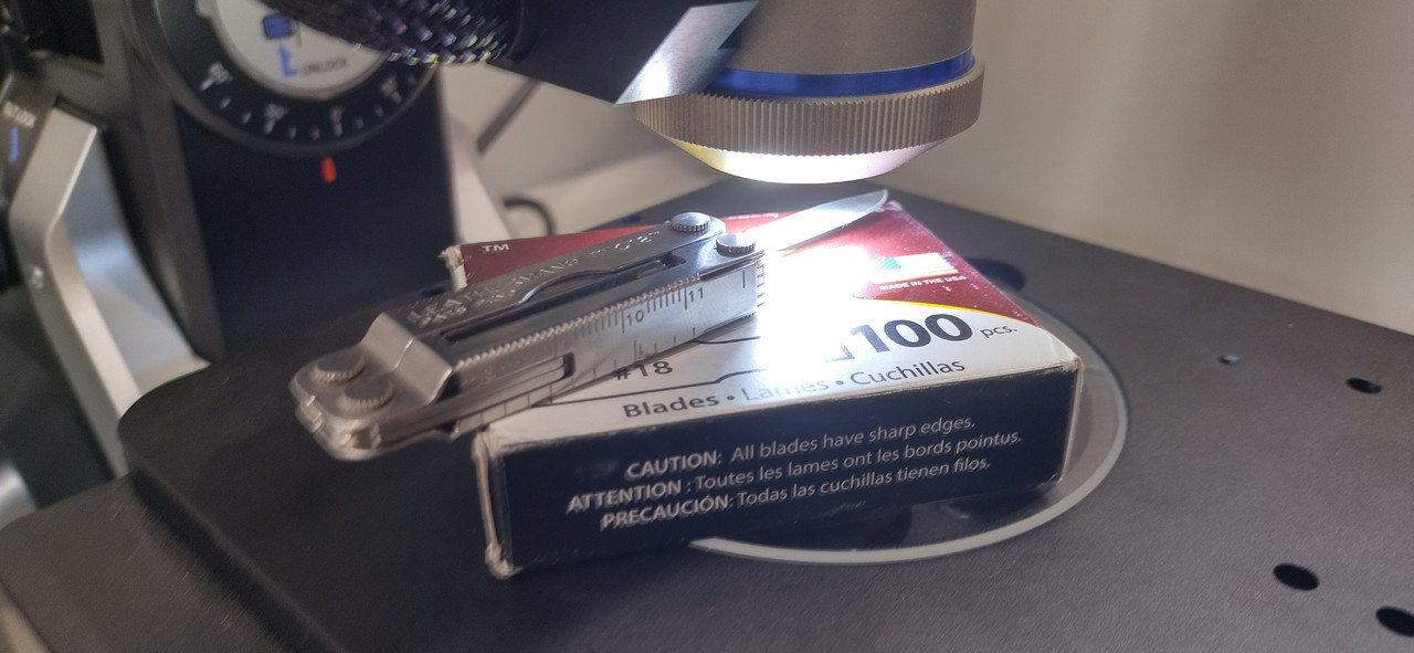

I took pictures of three different edges today so we could compare my style edge to others.
1. My black & green PE H1 Pacific Salt. The edge was set two months ago and it has been used hard and dulled, then touched up a few times since. Usually with a handheld folding DMT XX Coarse, but the last touch-up was on a harbor freight 300 grit diamond stone. Despite appearances it can scrape shave.
2. Lab razor. This was a fresh factory edge #18 razor blade from a pack of 100. It was cleanly shaving sharp.
3. Leatherman Micra. I've been carrying this Micra for over a decade. Not sure when I last sharpened it as I rarely use the blade. I believe I last touched it up on a sharpmaker with brown or fine rods. No shaving ability and cuts poorly in general.

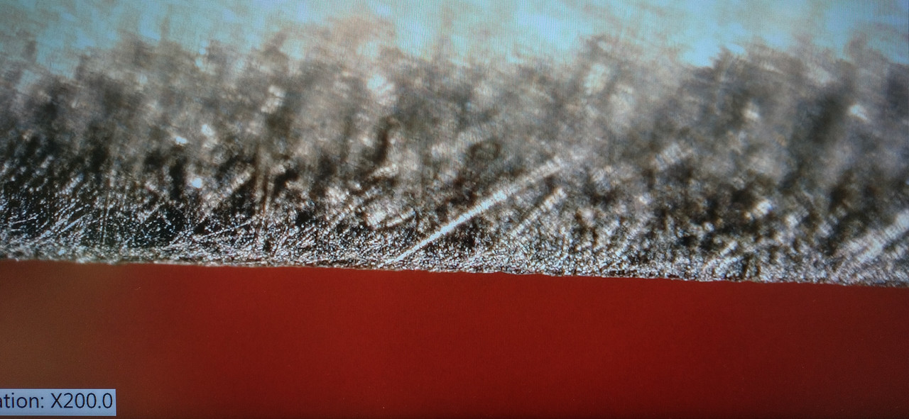

First, here is the razor. There is an edge shot fresh from the pack and another after wiping off the oil.

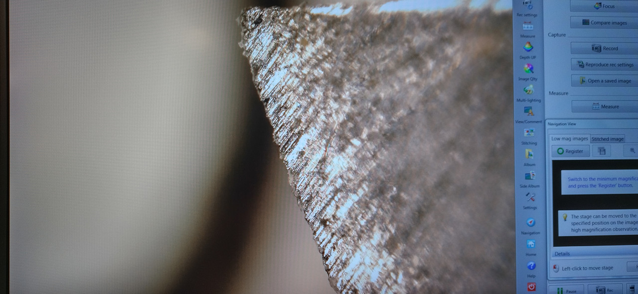

Here's the Micra:

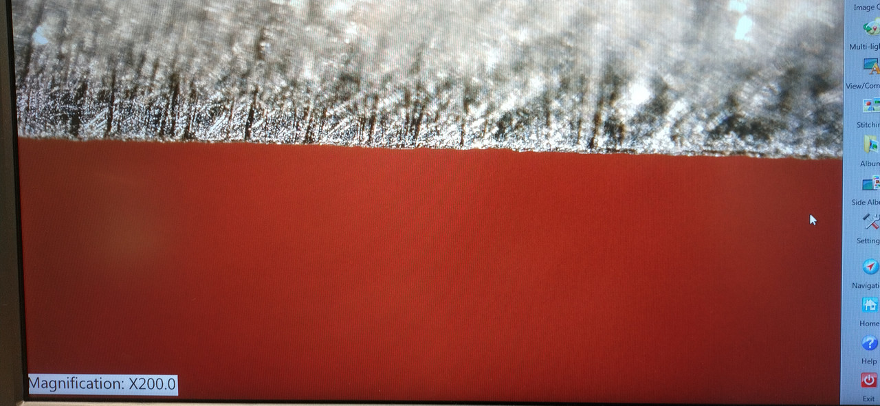

Here's the Pacific Salt:
That's the tip.
Close-up of Sal's logo. Never realized it was four distinct channels etched in.
Close-up of the black blade coating.

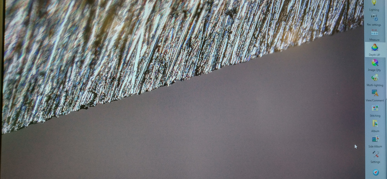

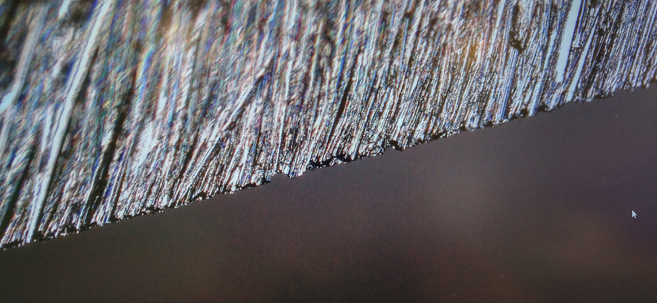

The edge. The microserrations are incredibly obvious under this level of magnification.
Imagine using the razor edge to slice rope. Imagine using the Pacific Salt to shave your face.
I don't do much shaving or fine push cutting with my EDC knife, so I went with "the right tool for the job" for me. Coarse edges.
If you guys find this sort of thing interesting, I can make a day of it. Sharpen some knives at different grits and we can inspect them fresh off the stones.

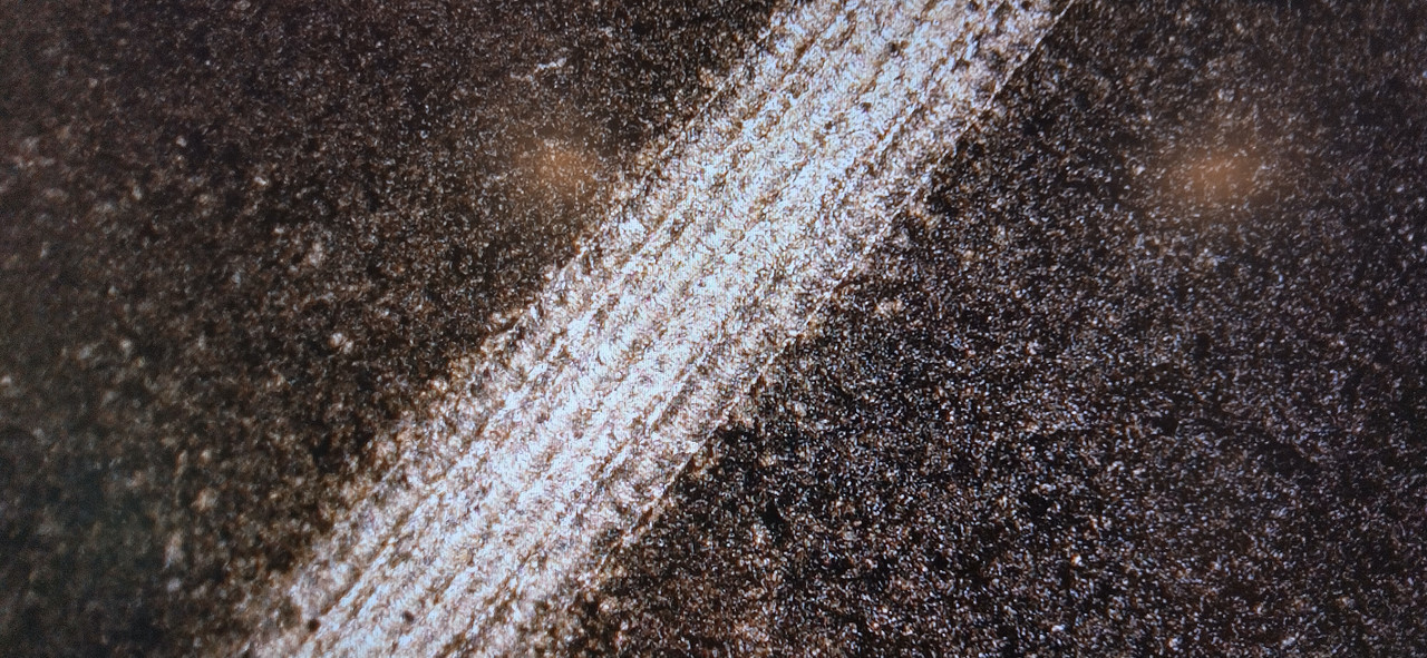

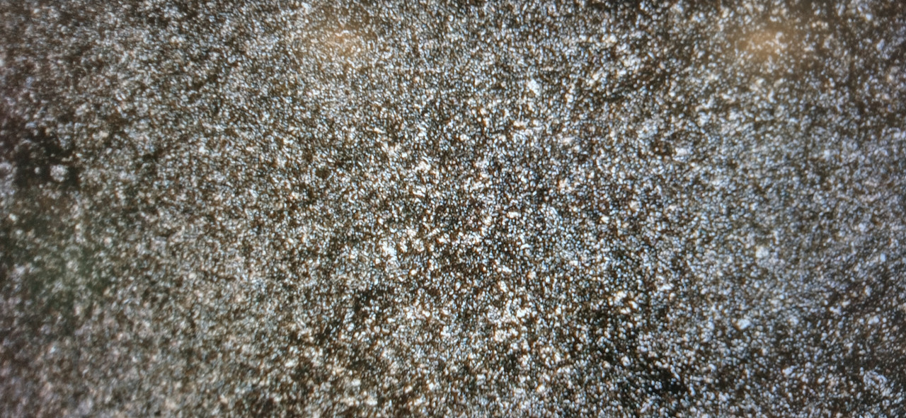

Man, I'd love to see a Vivi edge compared to a Michael Christy edge. Thanks for doing this; it is really cool.

One thing I've learned after playing with this edge type for a bit, is minor edge damage basically makes no difference.Wandering_About wrote: ↑Wed Jun 08, 2022 5:17 pmCool stuff Vivi. Always appreciate when folks share microscope images of edges. Always something to learn!
For example I recently got two small chips in my LC200N Pacific Salt. How did I find out? Not by cutting stuff, it cuts great. But by running my nail down the edge to feel how coarse the apex was sharpened to. I felt two small chips that I couldn't detect by the cutting performance alone.
In that image it looks like the H1 Pacific could have two decent sized chips along the edge. Or it might just be how the blade looked after the last sharpening, not 100% sure. Either way the knife cuts fine. It doesn't feel chipped if I slice some rope, cardboard or paper.
I feel like that sort of edge deformation would be a lot more noticeable in a polished edge.
So while a polished apex to me appears to be the stronger edge, exhibiting a more uniform apex, I feel any damage received to this edge type will be more noticeable and degrade the cutting performance faster.

VIVI your photos prove that there is no such thing as a plain edged knife. All knives are serrated when you look close enough.
I've often wondered if a true plain edged knife is even possible? You would think that with some of those super fine Shapton stones you might be able to pull it off. But on second thought I kind of doubt it.

Thanks for such an educational post. So cool. It does beg a question. Your edges seem to indicate that stone moved perpendicular to the edge giving a fine serrated finish. Have you ever looked at an edge that a SharpMaker produces? Could you possibly share that?

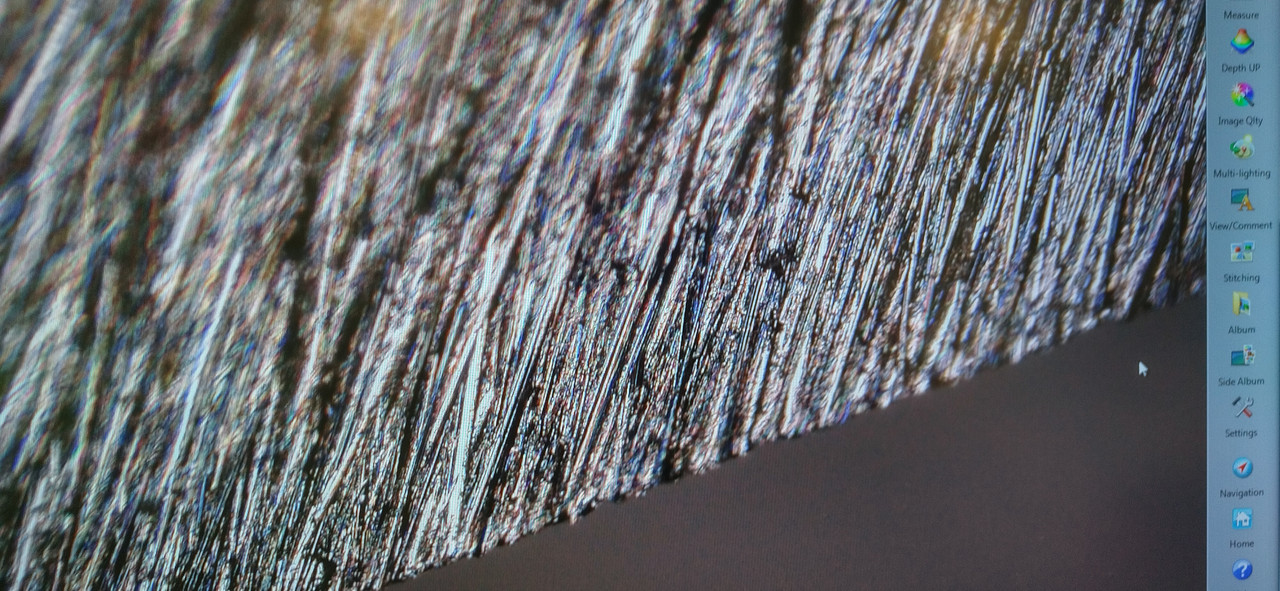

Compared my user Pacific Salt sharpened at 200 grit to a NIB Pacific and a razor blade:

`vivi wrote: ↑Thu Jun 23, 2022 2:11 pmCompared my user Pacific Salt sharpened at 200 grit to a NIB Pacific and a razor blade:
I'll be uploading 15-20 images when I get back to my laptop. These are higher quality and more interesting edges, you guys will like this update.
Here's a video of the 200 grit edge shaving pretty cleanly - https://vidsli.com/watch/97wjfM3gE6
What's the angle of that user bevel? Around 12º? It's a very nice edge.
