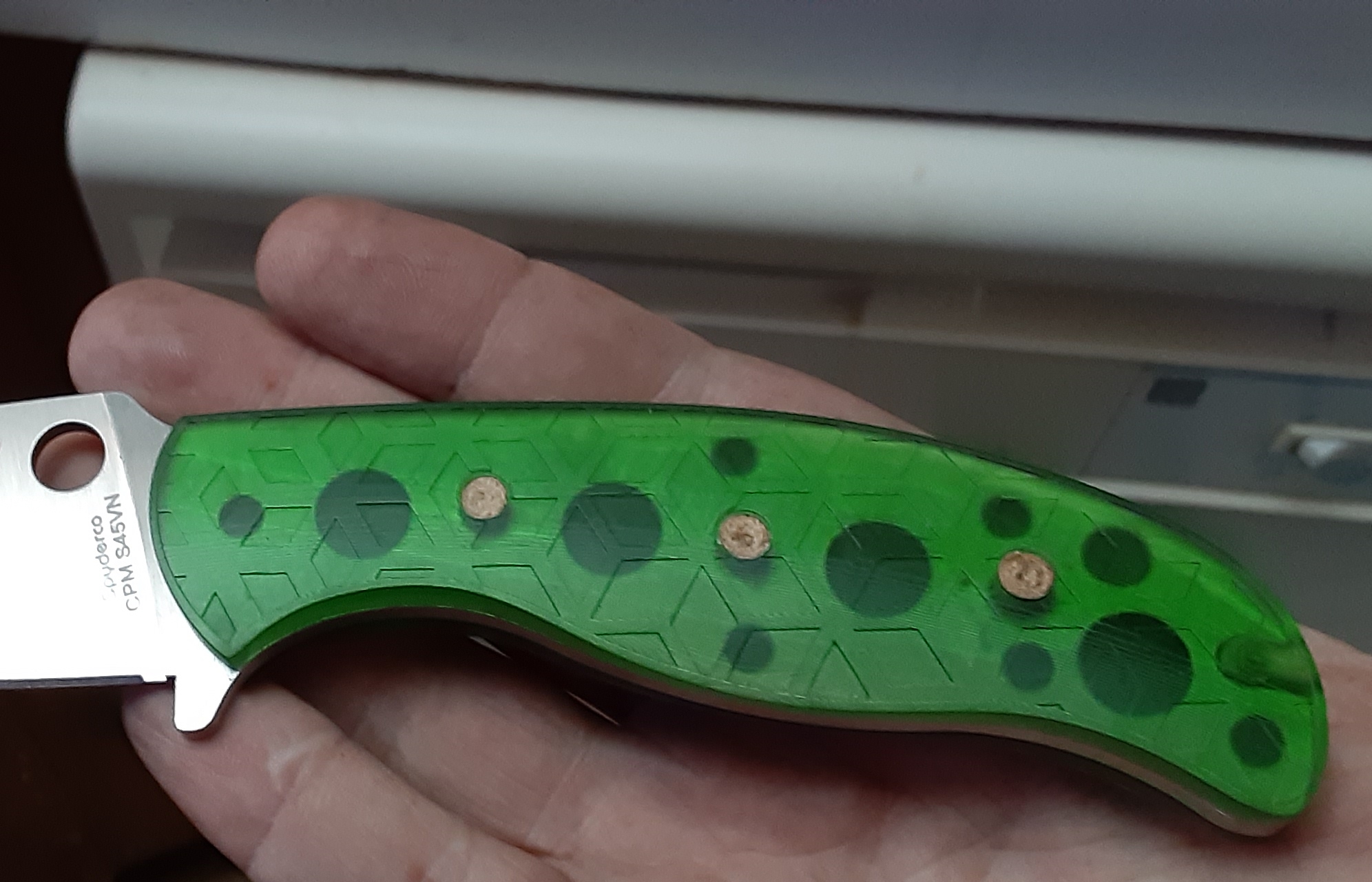

My brother and I made our first test a couple of weeks ago.
The fit is nice and tight. However, he wanted to see how much he could cut the printing time without having bad results.
I think he still has some tuning to do (his Prusa was out of order for a while, we just barely got it running again).
I still can try to finish it myself, but there was a LOT of stray plastic filaments on the texture ^^.
Next is either trying the resin printer for another set of scales, or the sheath (and for sure the N5 LW scales once I finally know where to order the inserts, the company Josh mentionned is european, but finidng a place that holds and sells their stuff is hard for me apparently :squinting-tongue
Here's a couple of shots :
