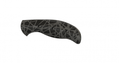

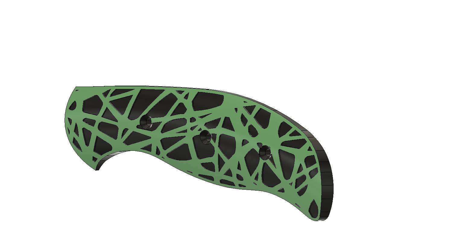

After seeing Gtscotty's scales here viewtopic.php?f=15&t=89676&start=40 I decided to try my hand at it. I'm not sure how he did it but the way I went about it was very convoluted so I don't think I can explain easily. Here's pictures of both still in fusion because I wanted feedback on how the looked before printing them. I'm not sure about the ring around the countersink on the first one.

Wow, those are great mockups. The top one can be for fragile college-indoctrinated adult children (aka snoflakes) and the bottom one for animal lovers. They both look nice n grippy. Difference in height between hill and valley? What, .020? More? I would likely buy the bottom, the giraffe. Though the fade of "cube" into "snoflake" is very nifty.
Regards the countersink "ring," I can see how it's necessary for that pattern; you can't necessarily adjust a polygon to avoid hitting a border, as you can with giraffe. With the giraffe, you COULD adjust your pattern so the holes don't intersect any of the webbing.

The pattern is 1mm deep for now but it can be adjusted easily.Bolster wrote: ↑Sun Jun 27, 2021 7:15 pmWow, those are great mockups. The top one can be for fragile college-indoctrinated adult children (aka snoflakes) and the bottom one for animal lovers. They both look nice n grippy. Difference in height between hill and valley? What, .020? More? I would likely buy the bottom, the giraffe. Though the fade of "cube" into "snoflake" is very nifty.
Very cool work, man. Wish I could play in this playground.
No idea as I'm still working out how to do pattern around the screws.bbturbodad wrote: I like the bottom one. What type of hardware is needed to attach them?

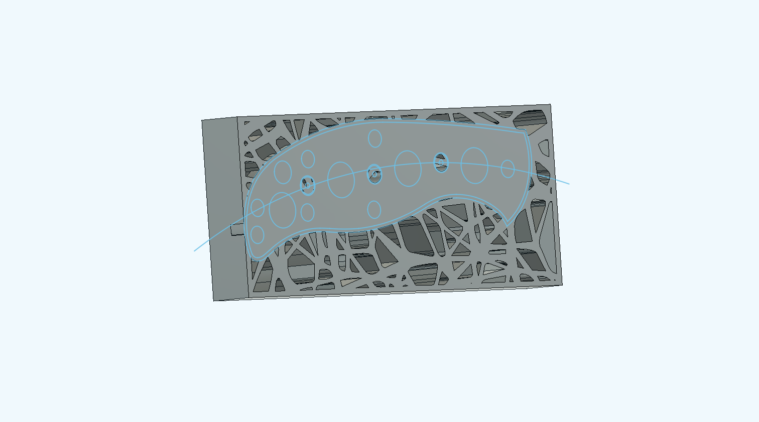

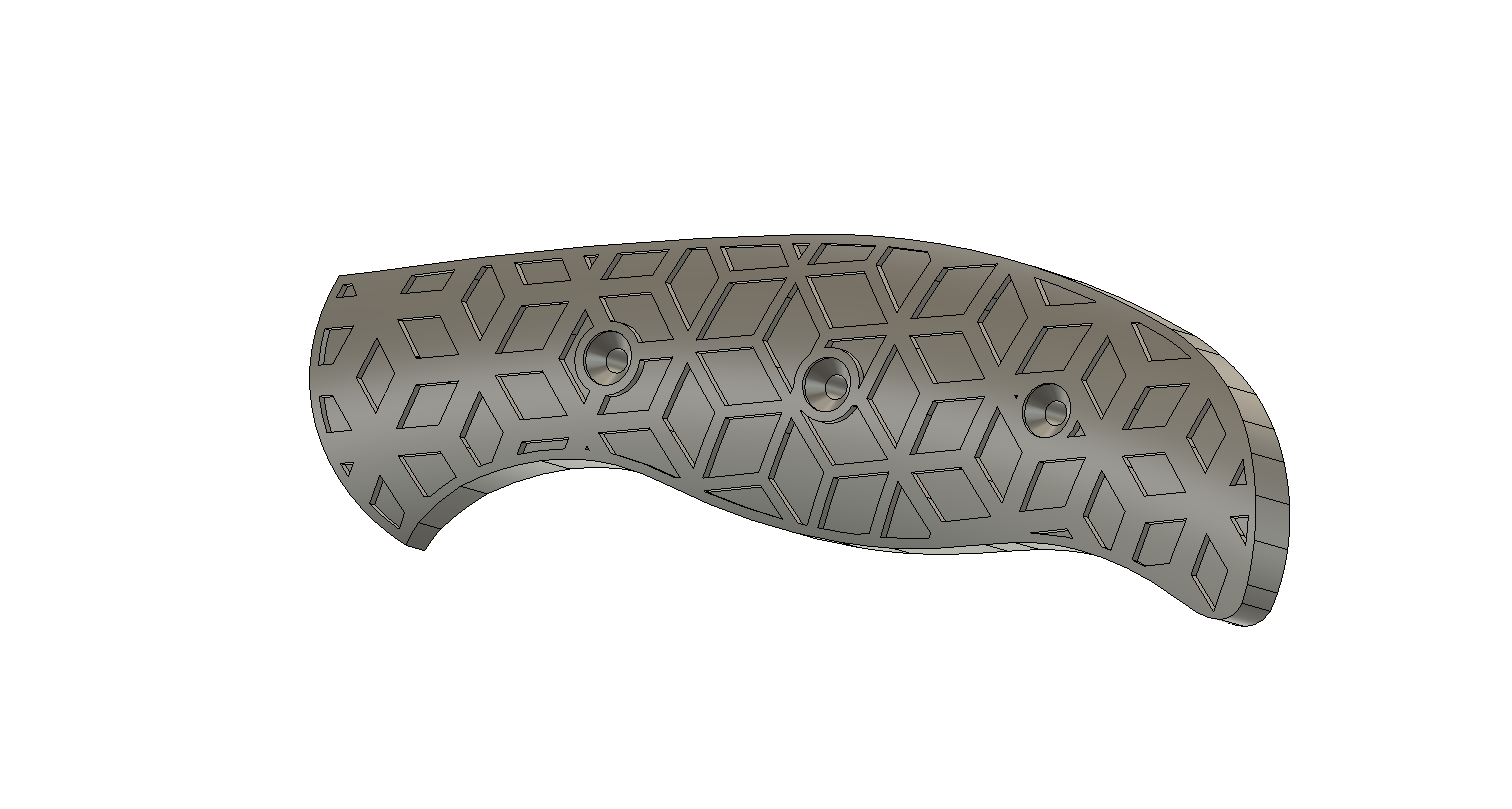

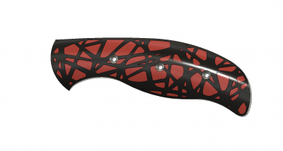

Here's a few more but I added color to some to get a better idea of what it could look like. If anyone wants any of the files just pm me. I can adjust the mounting holes for whatever hardware you want to use. I have an Ender 3 FDM printer on the way so I have to wait till then to print some.

Good looking patterns, especially the first two.
I'd like to hear how you did the texturing in Fusion 360. I couldn't get the Emboss feature to work on mine because the complex curved surface couldn't be made 2d without distortion, which is apparently required.
I wound up creating an offset plane above my handle then used the rectangular pattern function to replicate the hex pattern. After that I had to delete all portions of the pattern outside of the outline of the handle, and trim any shapes that overlapped the outline. After all that I selected the pattern and extruded, with the option checked to extrude starting from the handle body surface. Kind of time intensive, so I'd like to hear how you did yours?

Re: 3d printed scales with patterns/textures
Hope this explanation helps sounds close to yours. I couldn't get emboss to work either and found nothing on youtube or google to help.Gtscotty wrote: ↑Mon Jun 28, 2021 10:19 pmGood looking patterns, especially the first two.
Starting with just the outline I make a long curve across the scale so I can use the plane along a path function. After extrusion and making the new plane I sketch the needed curve for the scale surface. In order to use most functions you need a closed in shape, doesn't matter what just needs closed in. That shape lets you use the sweep function along with the long curve from the beginning to make the base scale. Then I made an offset plane about 15mm above the first sketch and put the pattern there. Extrude the pattern. I just used a large circle around the scale so I could select that space and use extrude to cut away extra material. Back to the same sweep but I offset the sketch outline by how thick I want the texture. I left out a few of the finishing touches but I'm sure you can figure the rest out.

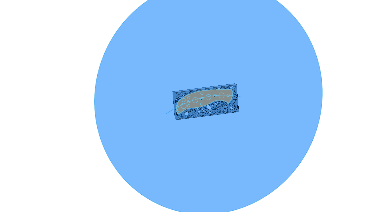

Ok, thanks yeah I think we did pretty much the same thing, maybe with a few steps in different orders.Joshcrutchley1 wrote: ↑Tue Jun 29, 2021 11:14 amHope this explanation helps sounds close to yours. I couldn't get emboss to work either and found nothing on youtube or google to help.Gtscotty wrote: ↑Mon Jun 28, 2021 10:19 pmGood looking patterns, especially the first two.
Starting with just the outline I make a long curve across the scale so I can use the plane along a path function.1st.png
I sketched the outline and got it sized correctly, and the holes placed, then extruded the handle outward, and then swept a cutting shape along a sweep line like you did (texture shows in the picture but was added later).
Then I applied all the chamfers to the edges to make the smooth texture handle version. Since I added textures after everything else was finished, I had to add the geometry on an offset plane and manually trim wherever a hex crossed the edge of the main surface. the extrude function wouldn't resolve if I tried to select the chamfered surfaces as well, and if any portion of the hex shape crossed the edge of the main surface, none of that hex shape would extrude.
Then I selected all the hex geometries and set the extrude function to extrude 0.02" with the starting point set as the selected face.
I think adding the texture like you did before doing all the chamfers would probably make the extrude function work better all the way to the edge and save a lot of time having to trim all of those little hexes so that they didn't cross the face perimeter.

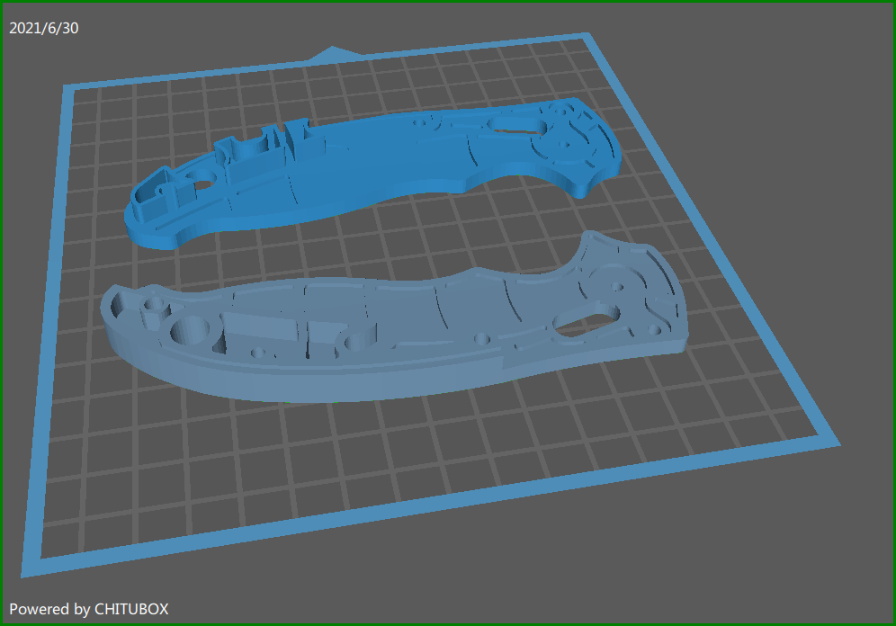

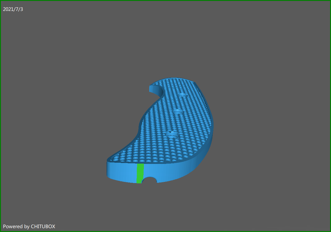

I'd like to play around with the top one. I should have that fresh liter of clear resin tomorrow so after I get these Manix scales printed for you I can also print up a set of these if you want.Joshcrutchley1 wrote: ↑Mon Jun 28, 2021 9:39 am...If anyone wants any of the files just pm me. I can adjust the mounting holes for whatever hardware you want to use. I have an Ender 3 FDM printer on the way so I have to wait till then to print some.
I'm curious to hear how you like the Ender 3, I've been starting to eye FDM printers so I can print stuff without getting in my wife's way.

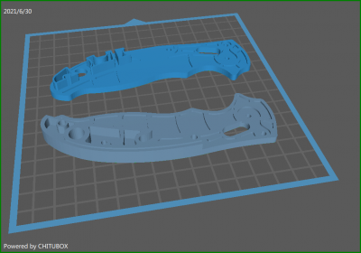

Manix scales supported and ready to go!

You should really try the way I suggested with the scale flat on the build plate. It will make them clearer and cut the time down to less then an hour instead of almost 11hr.bbturbodad wrote: ↑Tue Jun 29, 2021 10:20 pmI'd like to play around with the top one. I should have that fresh liter of clear resin tomorrow so after I get these Manix scales printed for you I can also print up a set of these if you want.Joshcrutchley1 wrote: ↑Mon Jun 28, 2021 9:39 am...If anyone wants any of the files just pm me. I can adjust the mounting holes for whatever hardware you want to use. I have an Ender 3 FDM printer on the way so I have to wait till then to print some.

When I print them directly on the build platform the printer compresses the first few layers and the prints come out .5mm shorter than designed. They're also really tough to remove from the build platform without damaging the prints. I did a test print the other day using gray resin and a similar orientation and it came out perfect. I'm using tiny support touch points so the model peels right off the supports. I don't mind the print time since I'll be sleeping while it prints.
I don't know how well it comes through in the photo but the clear one was printed directly on the platform and aside from being dimensionally incorrect and warped the holes are misshaped.

Wow that looks amazing! I guess it should considering the cost of the printer. That's weird that it distorts the holes so much. I never had that issue printing on the build plate.bbturbodad wrote: ↑Wed Jun 30, 2021 7:29 pmWhen I print them directly on the build platform the printer compresses the first few layers and the prints come out .5mm shorter than designed. They're also really tough to remove from the build platform without damaging the prints. I did a test print the other day using gray resin and a similar orientation and it came out perfect. I'm using tiny support touch points so the model peels right off the supports. I don't mind the print time since I'll be sleeping while it prints.
Edit: I was curious about your printer and looked in to it some. It seems yours uses a uv laser instead of a lcd and uv led like mine. What I thought was interesting is the time it takes mine to print is based on layer count but yours is still like a fdm printer and tied to print volume.
