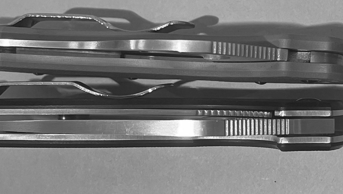

Here are two pics illustrating the alignment issue and one of the fixes applied by the factory.
First shows the Lil Native (Golden, CO) pocket clip holes. They are barely larger than the threaded inserts into the inside of the G-10. Of course, alignment is near perfect with this type of setup.
Next is a Byrd Crow 2 (China). The pocket clip holes are only slightly larger than the threaded liner holes, they line up well, and I had no problem changing pocket clips.
Last is the new Gooney SE (China). There is significant misalignment between the G-10 holes and the threaded liner holes. The factory dealt with this by drilling the G-10 holes much larger. Unfortunately, in this case, the larger G-10 hole was insufficient to prevent cross-threading by the factory.
Pocket clip hole misalignment has been noted by others, but I paid no attention until I tried to replace the pocket clip. Clearly, if someone was perfectly happy with the factory pocket clip, or they removed it completely, this would not be an issue.
This is truly a very useful knife that feels great in hand and does an excellent job. I look forward to the Gooney that CQI will create.
