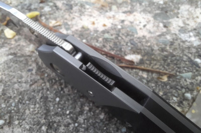

If the scale is thick enough, you could try a cutout on the inside of the scale like on the Spyderco Hanan.

mikey177 wrote:
Fri Jan 09, 2026 11:00 pm
Pretty cool! :cheap-sunglasses
Did not know this approach existed!
Wow I completely overlooked that those are compression locks, and that is exactly what I had in mind for my Bodacious scale mod. I'm sure it might hinder unlocking somewhat but I'm still curious.

That is actually how the Edgerati prototype was first shown to the public -
I thought that's how it was going to be produced but that obviously changed before final production.

Evil D wrote:
Sat Jan 10, 2026 3:27 am
Not only did I overlook it, but never even thought of that kind of implementation of a comp.lock!
Now that I see it I like it a LOT, but of course would have to try how it actually would work out for me.

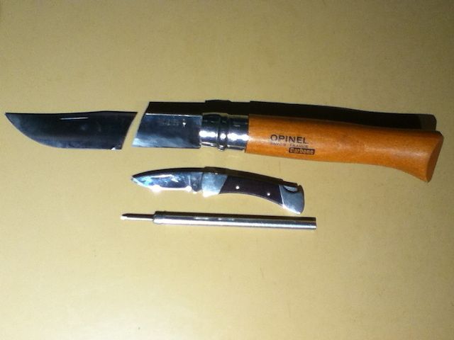

Come on Kids . We don't actually NEED 4mm thick short blades . I've only ever broken one thin knife (short little crack perpendicular to the edge ; knife still usable) and it was in a knife about eight inches long and 2mm or less at the spine . It was a MAC kitchen knife and I was BATTONING it through a rock hard squash gourd . H*ll I have bent Opinel #12s about ninety degrees while it was clamped in a vise with a groove cut half way through the thickness of the blade using an angle grinder . Had to flex it WAAAAYYYYYY over three times before it broke off using monster channel lock pliers .
(for a blade length mod)
