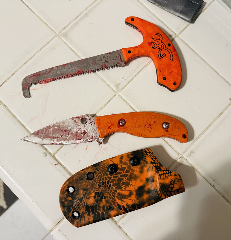

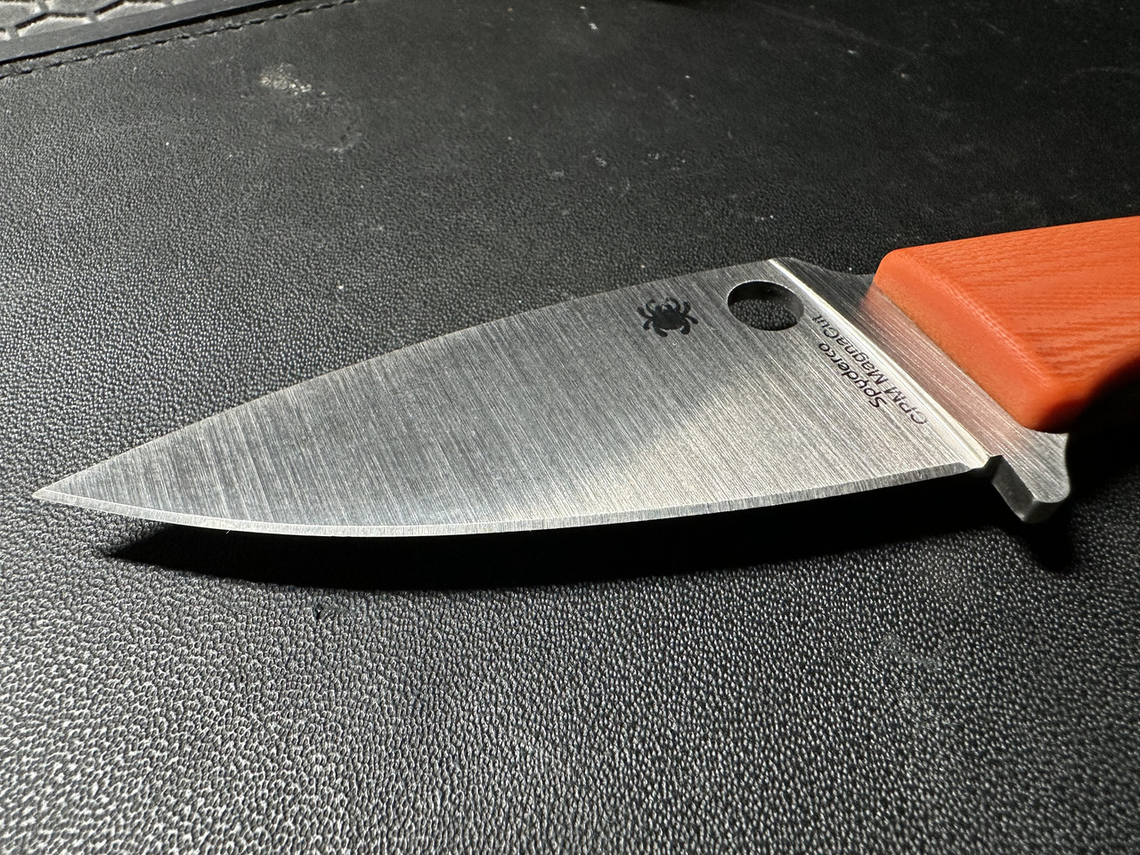

I was fortunate enough to harvest 2 deer in the past month here in Indiana. I used my new Spyderco Maganacut Mule to field dress the deer. Last year I used a Manix 2 S110V and the result was a disaster as It literally chipped the blade all over. Not this time! I used this new Magnacut Mule on 2 deer, cleaned it up, and it still looks brand new! Not a chip or hairline on the knife after gutting 2 deer. I’m impressed and sold, as Magnacut is at least as tough as they say. It’s still hair shaving sharp as well. Take my word and other’s words for it, Magnacut is a tough and relentless steel perfectly suited for the outdoors and hunting conditions. A+!

I started with the factory edge on both as they were extremely sharp from the factory. S110V is way to brittle to be dinging it off bones and cutting through a sternum. I Had to reprofile the entire edge as it was chipped so bad. Take it from me, S110V is not made for or gutting a deer.
I was actually blown away after by the Magnacut after I cleaned all the guts, blood, and fat, off the knife and it was still spotless and razor sharp. I make a cut from the bottom of the sternum to the top and its all Cartlidge and bone and it extremely tough to do without a tough blade. I've broke more than one tip off cheaper knives doing this and like I said it destroyed my S110V. My Magnacut Mule is the perfect deer hunting knife!
