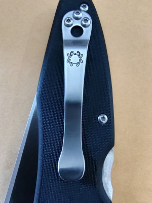

If the immediate wear on a black Seki painted clip bothers me, I remove the clip, strip the paint by soaking it in acetone, then replace the clip. The dull gray stainless works for my tastes. For those that like bling, the clip can be polished easily with a Dremel using a felt wheel and some compound.

Here you go.Scandi Grind wrote: ↑Mon Jul 07, 2025 4:07 pmIs titanium just a visual preference, or is there some performance advantage? It never even occured to me to consider why titanium clips are made until now.

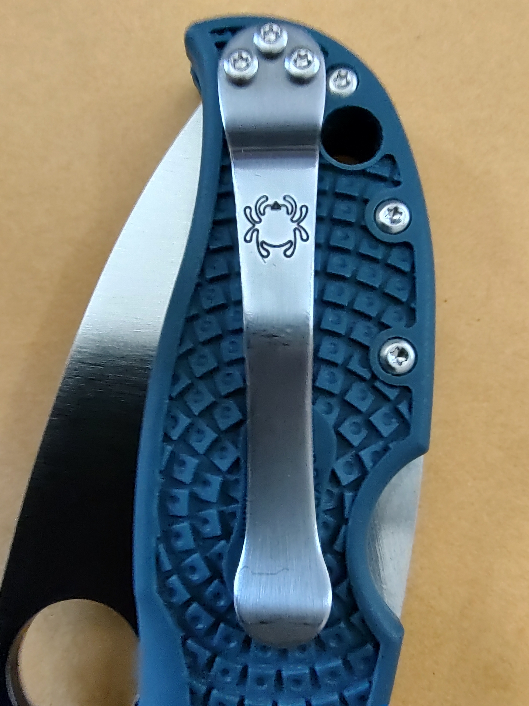

Here is a blue Leafjumper K390, and a black Police 3. Both of these clips were painted black. I removed the coating with a fine grit soft sanding block. It has a satin look to it. Pics are low res, I had to compress the images in order to post directly to the forumScandi Grind wrote: ↑Mon Jul 07, 2025 4:07 pmIs titanium just a visual preference, or is there some performance advantage? It never even occured to me to consider why titanium clips are made until now.

ejames13, 8th_Note, thanks for the references!
I'm thinking I'm gonna have to do this, I rather like the way those look. I tend to lean toward as much of a natural look as possible with my knives, so the stripped finish has an appeal compared to paint.

Very nice! I do the same thing to my K390 knives. I'm sure there's a reason Spyderco chose black clips, but I like the simplicity of the brushed stainless clip.
