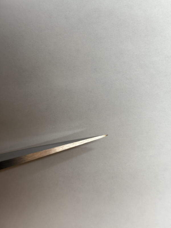

Posts: 1217
Re: Burnt factory Edges
Post by jwbnyc »
I have one PM2 that has discoloration at the tip. I assume that’s what it is. I just keep an eye on it.

jwbnyc
Posts: 1217
Post by jwbnyc »
Gerald over at Outpost 76 on YouTube has documented pretty large jumps in edge retention after sharpening new knives, usually 3X’s, going on quite a few years now. Worth a look. Whether that’s burnt edges or something else… I do not know. I think Gerald is on the forum sometimes. Maybe he’ll pop in and give his take.
Props to Brock O Lee..
jwbnyc
Posts: 1217
Post by jwbnyc »
Sun Feb 16, 2025 4:24 pm
jwbnyc wrote:
Sun Feb 16, 2025 3:21 pm
I've had similar on my 52100 Manix and AEB-L Urban...very similar steels, but always found that curiously odd.
Mine is s30v.. it’s just the faintest brown. It’s been sharpened out on the edge but remains on the spine side.
I’ve read about this at the tip on knives before. Don’t have any others like that, though. I just try to stay aware of it when using that knife and try not to drop it, just in case.
Decided to add a pic:
You can just make it out. It seems to be sharpening out as I use the knife. There it is, anyway.
Apologies for the crap picture. I am not a shutterbug.
