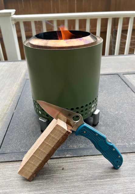

I have done it with my Endela K390… they were little 2” chunks of wood for my Mesa xl solo stove. Worked just fine, I guess mini batoning.Scandi Grind wrote: ↑Fri Feb 14, 2025 4:04 pmWould you feel comfortable batoning a PM2, or is this more generally relating to the steel? I wouldn't be the one to know if it could be done, but thinking about batoning with a PM2 makes me anxious. I wouldn't have the stomach to try it.WilliamMunny wrote: ↑Fri Feb 14, 2025 2:25 pm

I think WilliamMunny might just be talking about the steel.WilliamMunny wrote: ↑Fri Feb 14, 2025 7:58 pmI have done it with my Endela K390… they were little 2” chunks of wood for my Mesa xl solo stove. Worked just fine, I guess mini batoning.Scandi Grind wrote: ↑Fri Feb 14, 2025 4:04 pmWould you feel comfortable batoning a PM2, or is this more generally relating to the steel? I wouldn't be the one to know if it could be done, but thinking about batoning with a PM2 makes me anxious. I wouldn't have the stomach to try it.WilliamMunny wrote: ↑Fri Feb 14, 2025 2:25 pm
Looking to be tougher on the knife, baton, etc then CruWear.
I wouldn’t feel comfortable doing it to a PM2. If I had to, I would make sure the knife blade wasn’t in the locked position. That would just increase the stress on the pivot. The nature of batoning means there is always a degree of lateral impact on the blade. Regardless of the damage (if any on soft straight grained wood, to likely on hard twisted wood) to the blade, the action/pivot is the weak point.
As an idiot a long time ago, I ruined a Buck back lock, batoning with the blade locked open.
