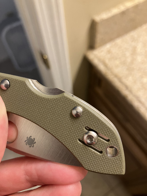

Post by RugerNurse »
Hopefully the pic comes through ok, it’s hard to see. I disassembled my G10 dragonfly and finally got around to reassembling it and the lock bar is ever so slightly above the backspacer. I don’t recall it being like that but I don’t know what I did. If I tighten down the pivot all the way it goes down flush but then I can’t open the knife. Anyone had this happen?

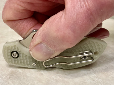

Is the lockbar high, or the spacer low? (or a bit of both)
What if you loosened the lock bar pivot and/or handle screws and placed the knife with the lock bar facing down on a table. Then press the handle down to push it up into the handle, then tighten the screw(s)?
Not a G10 Dragonfly, but you get the idea. It might “finesse” it flush with the back spacer.

RugerNurse wrote:
Sat Feb 01, 2025 3:02 pm
The pin in front of it also seems to be slightly out of place in that photo...
Maybe if you loosen to recenter everything (tough being under tension), maybe like Pokey suggests, then retighten in a sequence to keep things centered, then it could realign.
