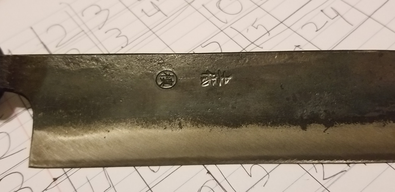

Hello everyone,
I've been using the Sharpmaker system for about 10 years now as my only system with great success. I've got the diamond rods down to the ultra fine, and typically set the edge at 30 inclusive and microbevel with a few light passes at 40. Along with a strop, I've had no issues keeping things hair-popping sharp from S110v to ZDP-189... except for one of my favorite chef knives.
It's a large gyuto, and the core layer is blue super steel. No matter what pressure, angle (30 or 40), or rod I seem to start or finish with the edget wants to flake/chip/string off. I typically use a bit more pressure to build a burr, then progressively decrease pressure until it is gone. I've tried starting with very light pressure (basically the weight of the knife) but still get the same results. Any ideas?
Thanks!

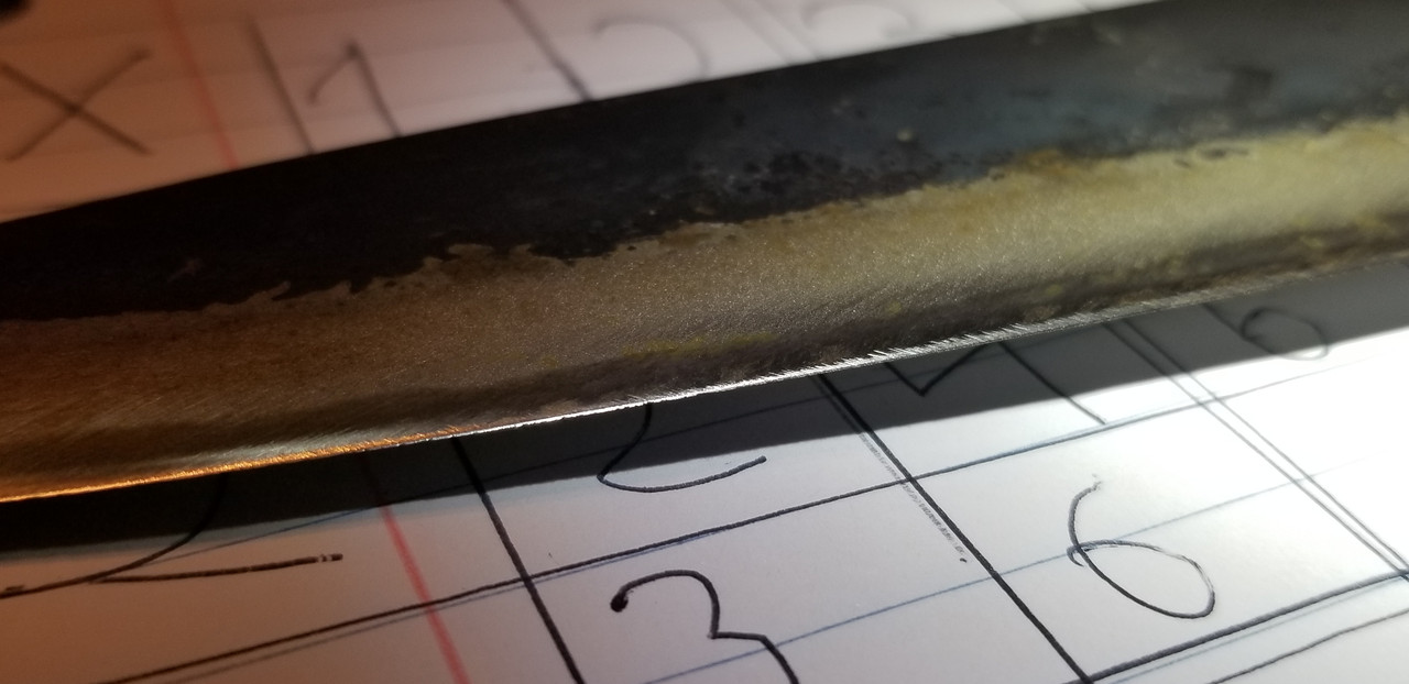

Wow, I have never seen that before. Maybe it is because I don't usually use very hard, more heavily alloyed steels. I do have a gyuto that is very thin bte and hard, but it is simple 80crV2. All of my other knives are softer.
I can't tell exactly what level of zoom this picture is at. Is the chippy portion just the micro bevel, or is that the whole secondary bevel?

In that pic there is no micro bevel, just the FFG blade and a 40 inclusive edge set by the sharpmaker diamond stones. It looks the same as I get to the finer stones, just more polished on the chips and hairs of steel breaking off. I used my camera's macro lens.Scandi Grind wrote: ↑Wed Sep 04, 2024 7:42 pmWow, I have never seen that before. Maybe it is because I don't usually use very hard, more heavily alloyed steels. I do have a gyuto that is very thin bte and hard, but it is simple 80crV2. All of my other knives are softer.

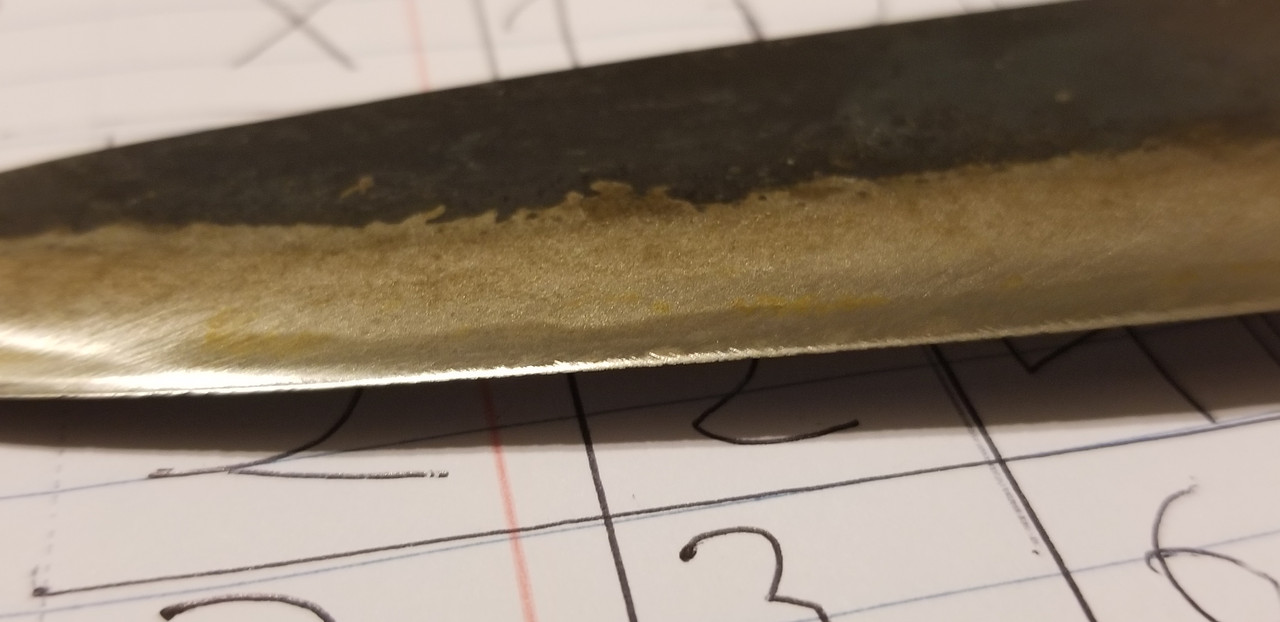

I just wanted to close the loop on this thread and thank you for the tip. I essentially sawed off the burred edge as you suggested and slowly worked with the diamond rod flats at 40 inclusive to form a new edge. I'll see how this does and probably reset to 30 inclusive if it holds up well, but the tearing mess I previously has seems to be gone.
This picture shows the blade now, using light strokes on the flats of the Sharpmaker stones at 40 deg inc, and taken down to the fine grit stones. The edge is behaving normally, and can treetop hairs. Your advice was spot on!

nathanours wrote: ↑Thu Sep 19, 2024 6:08 pmI just wanted to close the loop on this thread and thank you for the tip. I essentially sawed off the burred edge as you suggested and slowly worked with the diamond rod flats at 40 inclusive to form a new edge. I'll see how this does and probably reset to 30 inclusive if it holds up well, but the tearing mess I previously has seems to be gone.
I'm glad it helped! Destressing an edge is a critical part in sharpening that most people skip.

Nice, much better looking! Maybe I should try this on my machette that doesn't want to take a proper edge.
