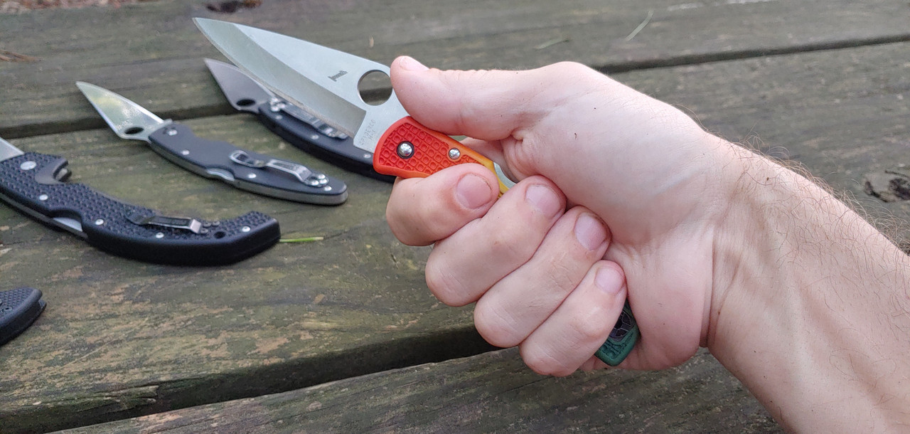

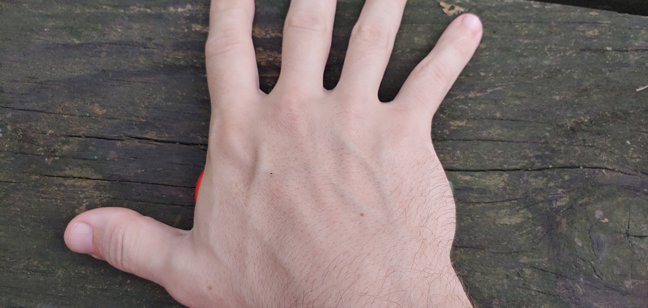

When figuring out the optimal pocket knife size for ourselves, there's also hand size to consider.
My palm is wider than a Delica or mini Manix, and almost as wide as an Endura:
my hand VS a Pacific Salt 1

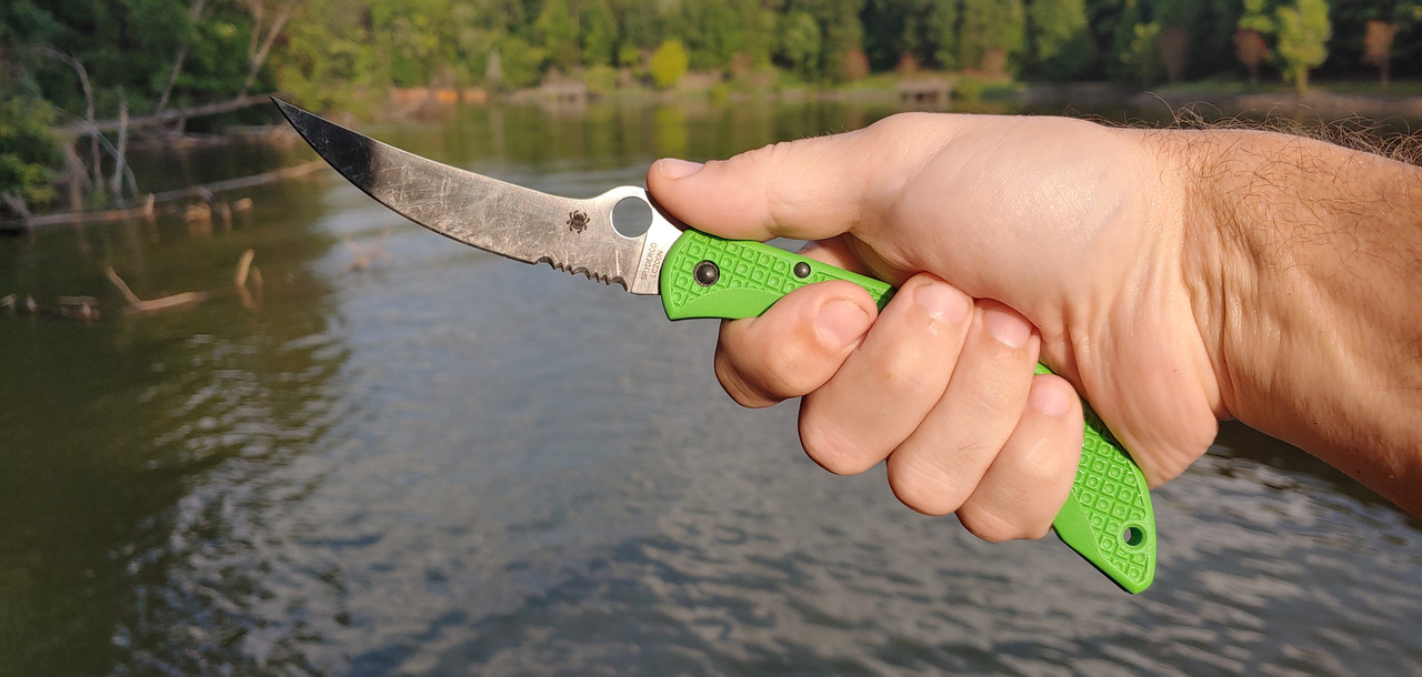

Here's how the Catcherman, Voyager XL, Police 3 and Pacific Salt look in my grip, for perspective:
While everyone else is fawning over the 87th Para 3 sprint, asking when we can get a mini mini manix or a mini native chief, I want to see Spyderco move in the opposite direction. Szabo folder lightweight. Tatanka Salt. Pacific Salt XL.
The Pacific Salt has been my one and done for a while now. If I had to pick one folder to carry for the rest of my life, a PE Pacific Salt 1 would be my choice.
BUT, that's because Spyderco doesn't make a bigger EDC oriented Salt knife.

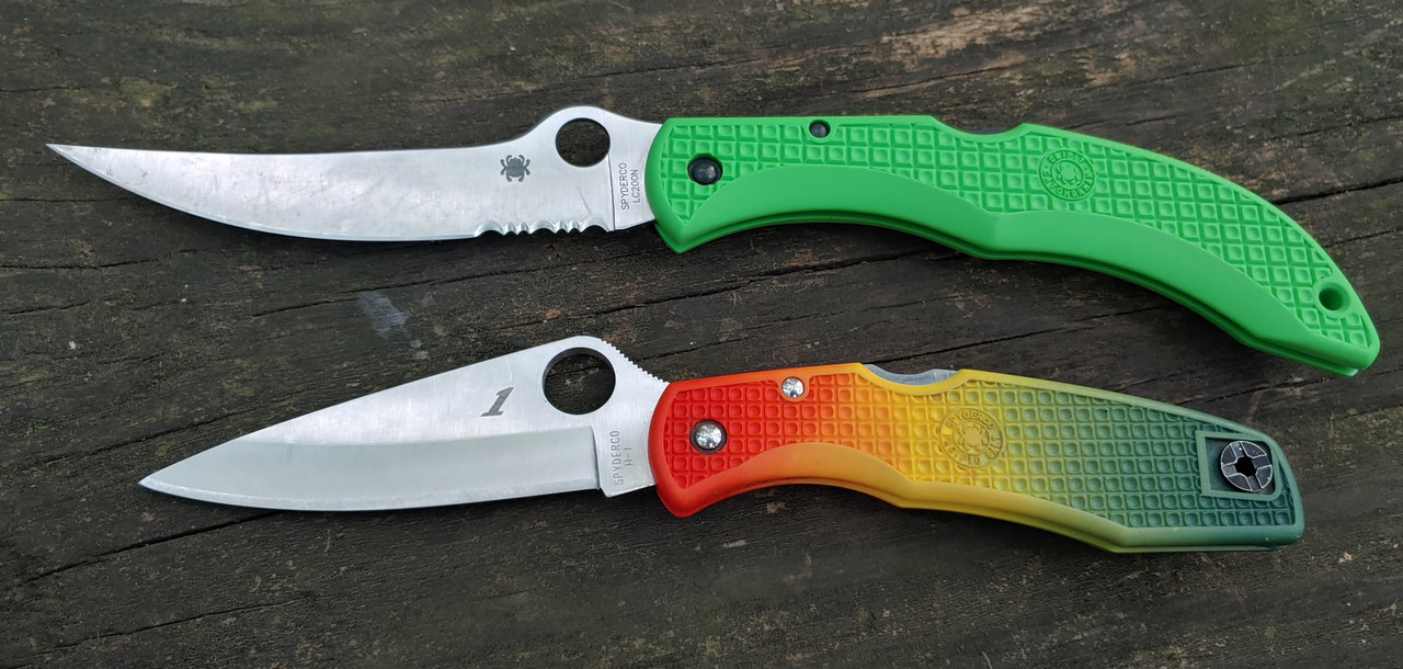

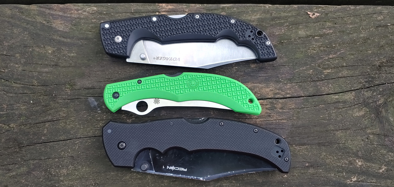

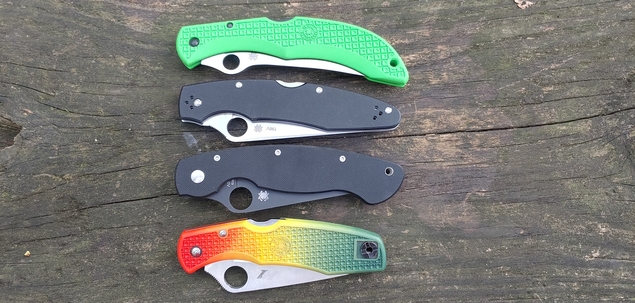

Here is the Catcherman & Pacific VS some other larger Spydercos I own. I prefer the overall design of the Military, Police, Szabo folder etc. in many ways, largely due to their size and ergonomics.
Some of you may have noticed me talking about Cold Steel more in recent years. Why? They make 5-6" bladed folders while most companies top out at about 4". I love their XL folders, because they actually feel XL. Here is the Catcherman compared to my two favorite CS folders:
Unfortunately, these models have drawbacks over Spydercos. Thumbstud instead of hole, soft steels with worse edge retention, no salt options, worse clips, etc. But they fill a niche other companies don't.
Despite being my most carried model, I'd take the Pacific out of that rotation if Spyderco made an XL version of it.
For now, the Catcherman is the closest thing I can buy to a Pacific Salt XL.

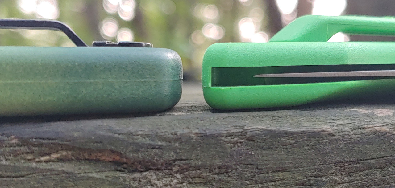

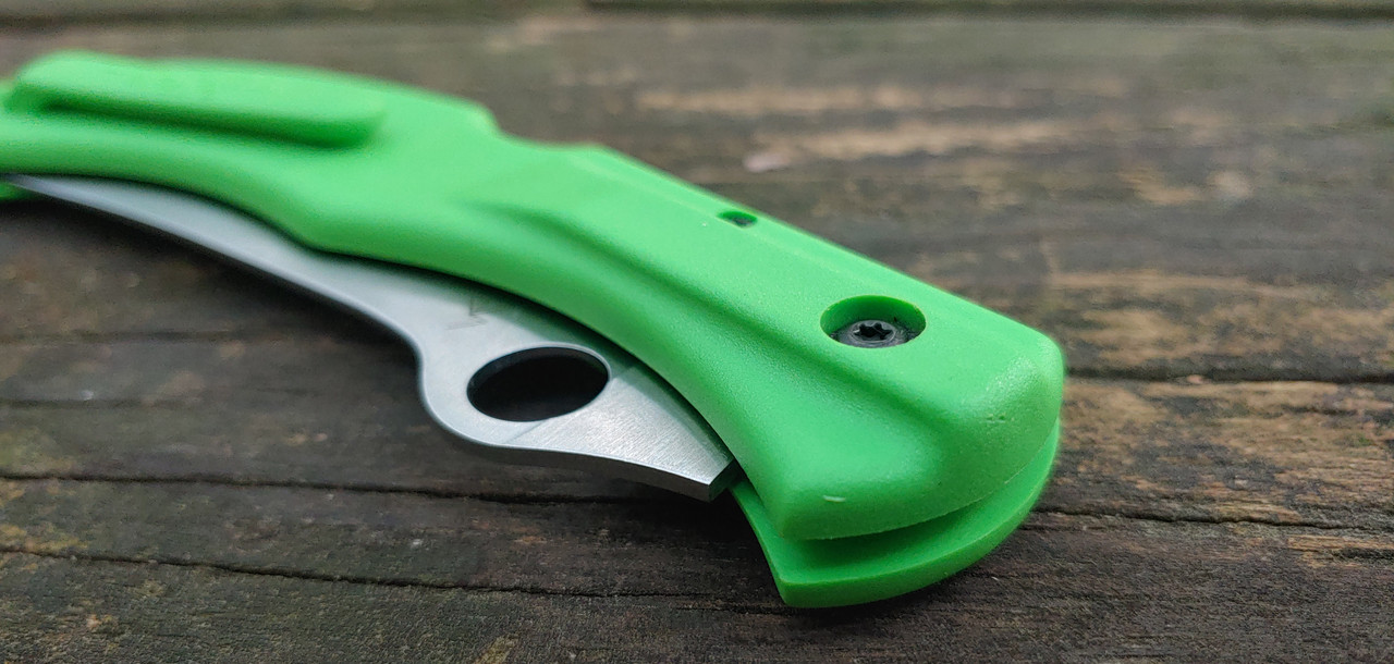

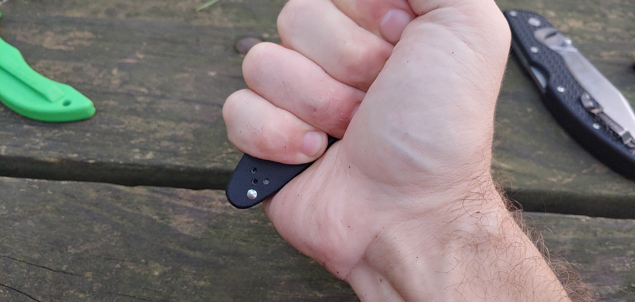

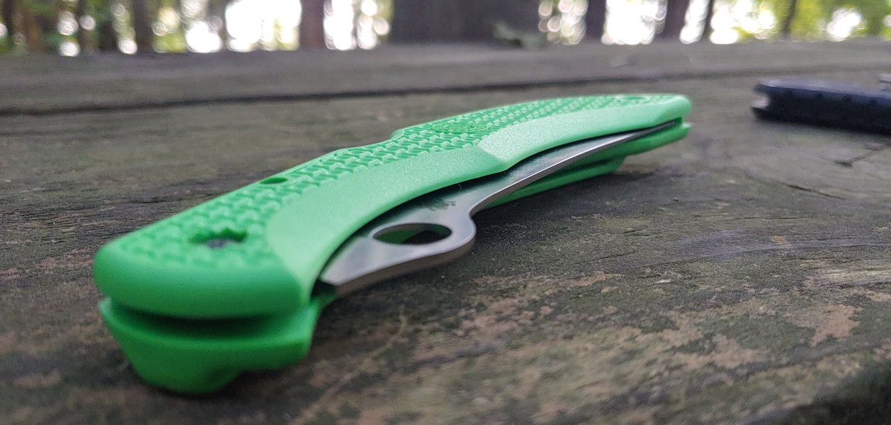

Another nice thing about the Catcherman, is the thicker handle.
(both ends of the catcherman compared to a Pacific Salt 1)
I've come to realize I prefer thicker handles. They're much more comfortable in use, and not much harder to carry. It's an ergonomic difference I appreciate when comparing, say, gen 1 C95 Manix folders to gen 2, or a Cold Steel Voyager to an Endura.
I think Spyderco prioritizes carry comfort a bit too much in this respect, vs in hand comfort. Thicker scales would be nice to see across their line.
I especially wish to see knives built thick & light.At least as thick as the original C95. If anyone here handled the second gen Cold Steel Voyagers, that's what I'm after in this context. Thick plastic handles that are stiff and palm filling, while remaining lightweight and linerless.
One interesting detail is the lock release is 2mm thick, despite a 1mm blade thickness. There are washers integrated into the one piece handle design, each about .5mm thick, to make up the difference:
I'd imagine that makes unlocking the knife more comfortable vs a 1mm lock bar, and stronger too.

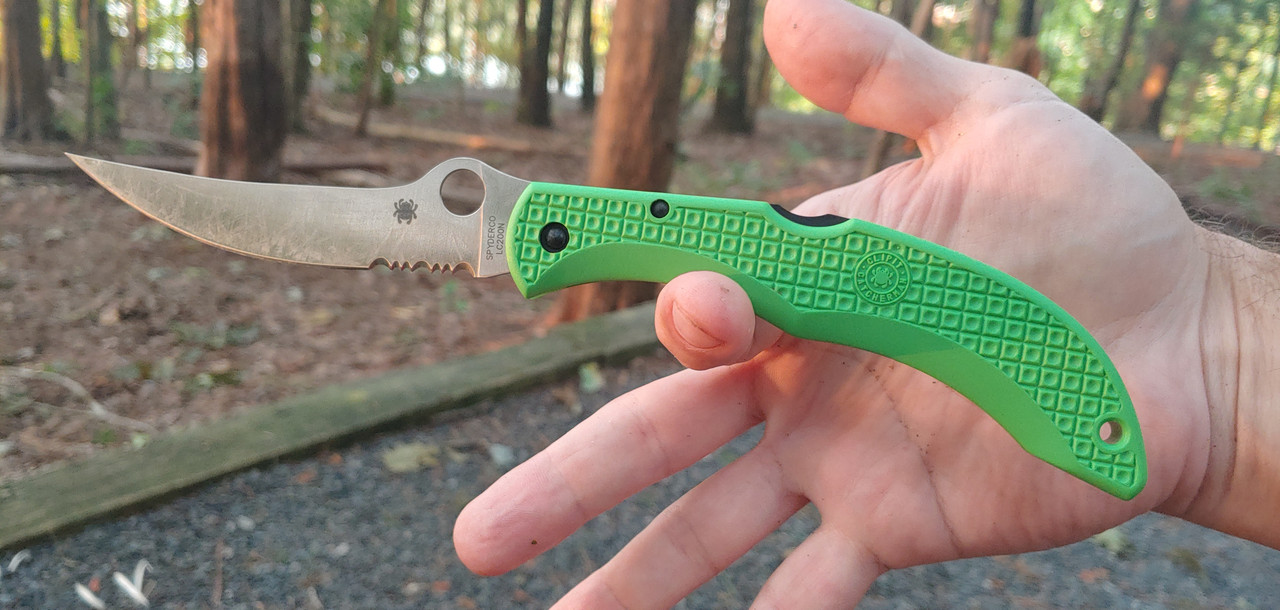

Another aspect of ergonomics I appreciate about the Catcherman is the lack of a thumb ramp and jimping:
I'm not a fan of either, which makes it tough being a Spyderco fan. Most their models offer both.
Thumb ramps are the #1 culpirt in making knives feel bad in my grip. Having larger than average hands with long thumbs mean they always feel positioned about a half inch too close to the rest of my hand.
As a result, most Spydercos make my thumb feel cramped if I utilize the ramp.

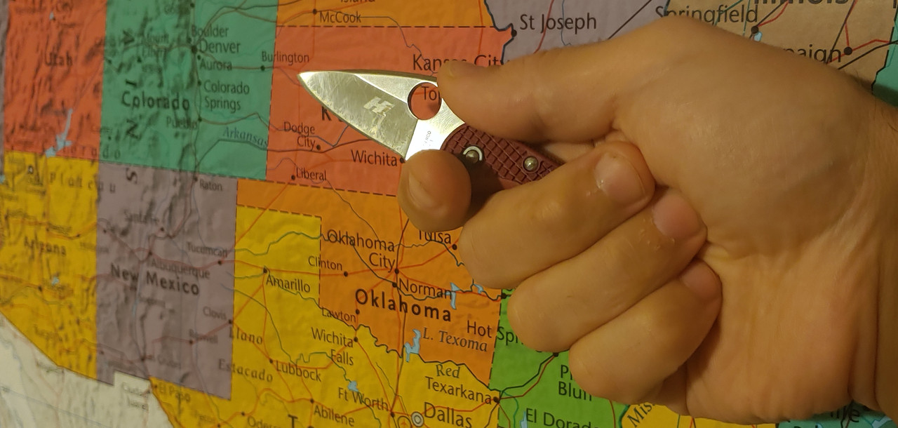

Here's my kids Dragonfly held with my thumb where it feels comfortable VS where the design forces it, to illustrate what I mean:
The Dragonfly feels like holding a pair of tweezers with the way it stacks the index and thumb fingers. I prefer a grip closer to say, a hammer:

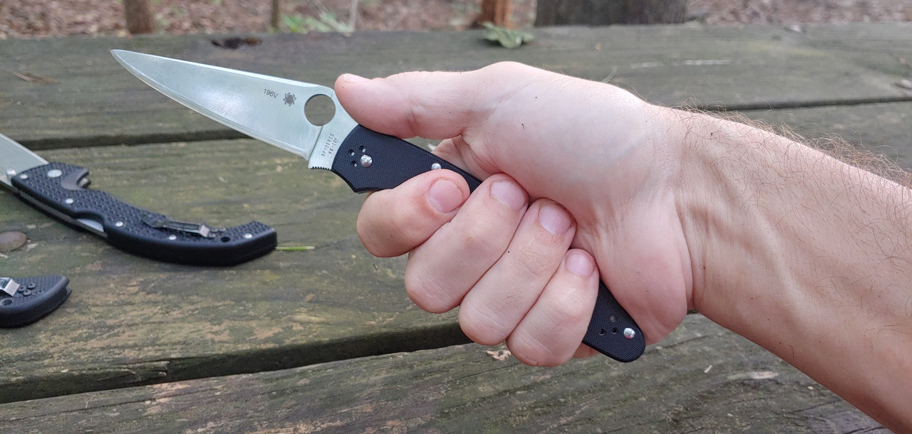

Now lets look at my grip with my thumb extended on the top:
That is my hands natural position when using a knife with this grip.
Look at the distance between my thumb and index finger.
Compare that finger placement to where classic Spyderco designs like the Caly Jr, Para 1 & 3, Dodo and Delica, which force a stacked grip like the Dragonfly more than the shallow thumb ramp of the Catcherman.

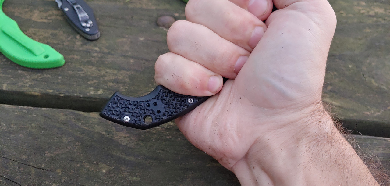

So for a knife designed as a filet knife of all things, I found A LOT to like about the ergonomics of this knife. The contouring, the thickening near the pivot, shallow thumb ramp, lack of jimping, etc.
Grip security is also high between the texture and the handle shape, which is key given the intended design.

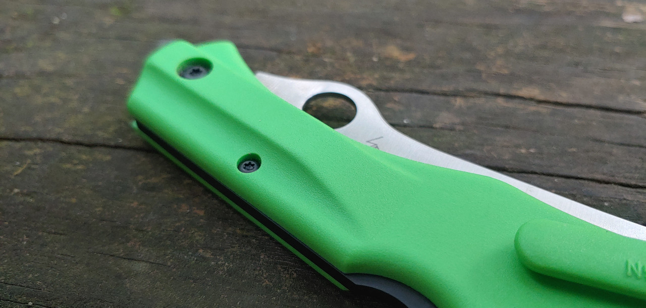

While we're discussing the handle, take a look at the aggressive contouring:
I love it. It makes the knife feel much better than the blockier G10 scale style.

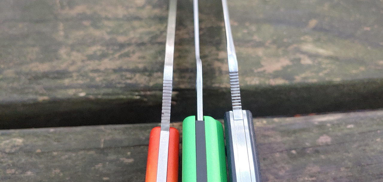

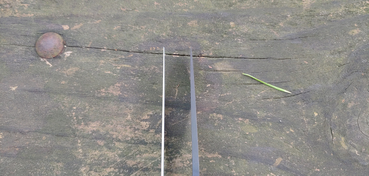

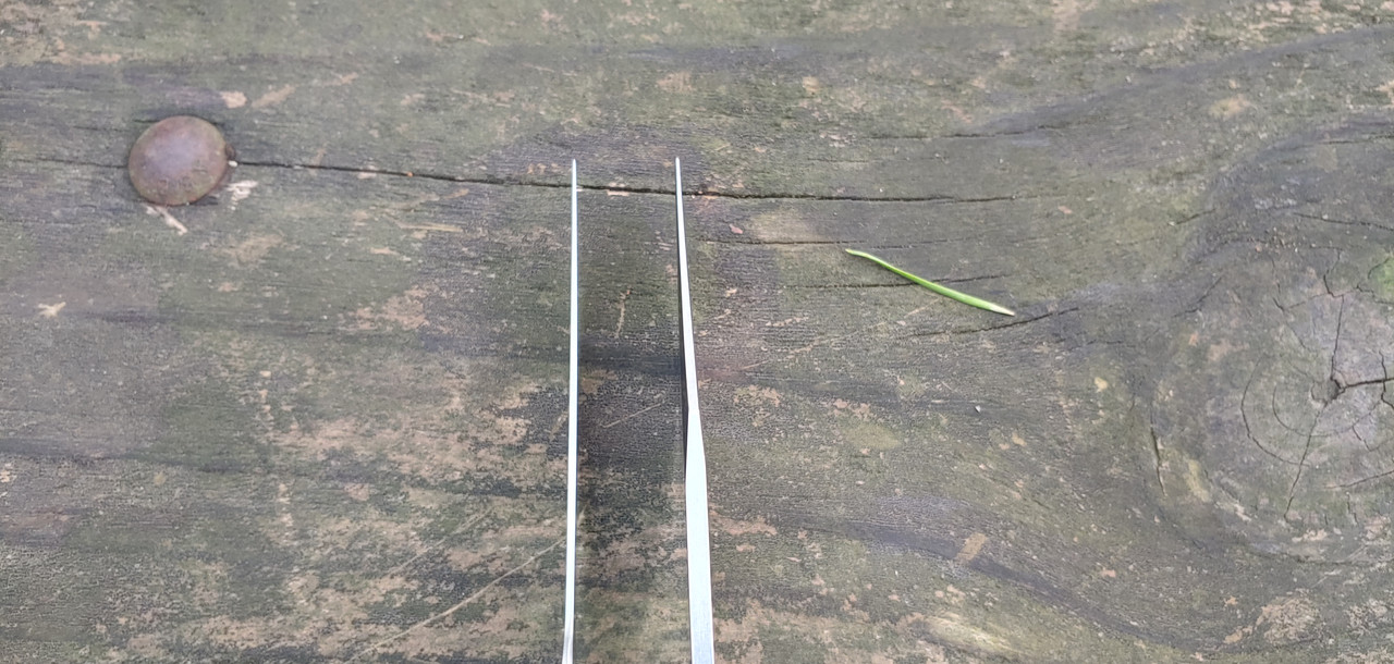

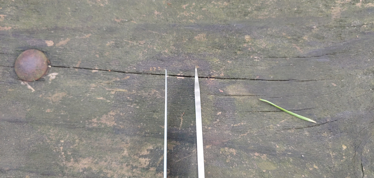

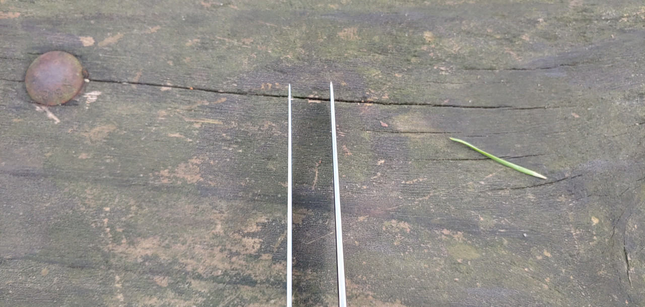

Yes, the tip is thin. Here it is compared to several folders:
VS a Pacific Salt 1 Saber Grind
VS a Police 3
VS a Cold Steel Voyager XL Clip Point
VS a Military 1 DLC
It that hasn't ever been an issue for me. I can't think of a time where I needed to do something with the tip of my Catcherman and it wasn't up to the task.
If you look at the photo VS the Police 3, the difference isn't drastic. I've used the **** out of that Police, which was purchased as soon as New Graham got their first batch of Police 3's. I've never had a problem with the tip on it either, after over 15 years of use.
Looking at photos I obviously haven't snapped the tip off my Catcherman after EDCing it most days this summer. I don't make a habit of prying with my knives....especially folders. If you do, maybe this isn't the model for you.
Now if I knew I'd be doing some heavy duty tip work, this obviously wouldn't be my first choice. If I needed to drill holes in a plastic 55 gallon drum and only had a selection of knives with me and no other tools, this would not be my first choice.

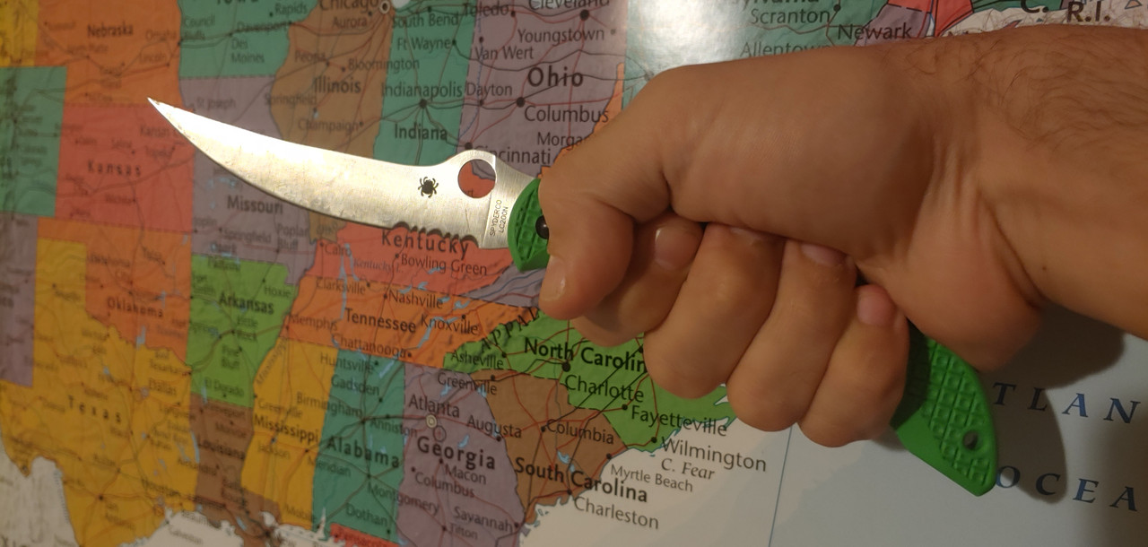

For typical EDC use I consider the Police 3 blade shape to be ideal. It's about as close as you can get to a wharncliffe while having just enough belly to be functional for slicing materials on a flat surface. It's the best compromise between the ideal utility blade (wharnie) and the versatility of a drop point.
The Catcherman has a much more upswept design, that while it often works worse when cutting things held in my left hand, it works wonderfully on a cutting board.
Comparing the knuckle clearance and useable cutting edge between the two models on a flat surface, the Catcherman has an obvious advantage.
So the blade shape is worse for slicing cardboard in my off hand, but better for slicing a NY Strip or cutting leather for crafts.
Normally I'm not wild about carrying upswept blades for EDC, and reserve them for meat processing at work. The Catchermans handle situates the knife at a negative angle, which helps give the user better control over the tip compared to straighter handled upswept blades. The blade has performed better than expected as an EDC with regards to the blade shape, largely because of that negative dip.
(One can see the tip is much more in line with the knuckles compared to a traditional filet knife design)

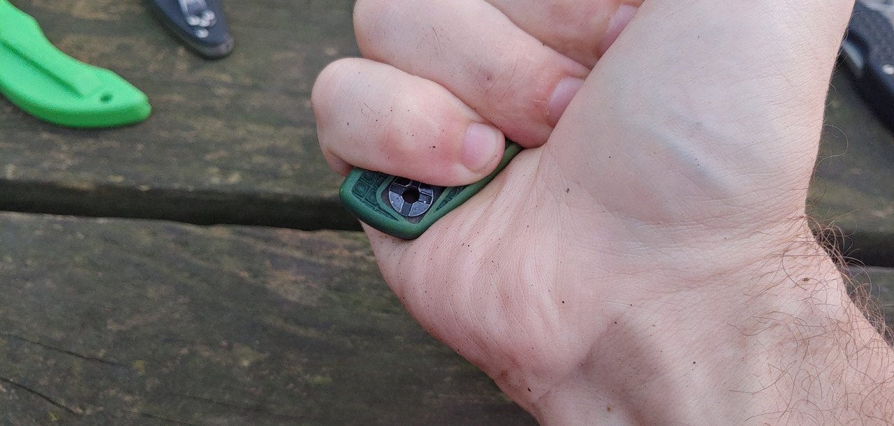

Now the reason I dislike it? It gets in the way when I close the knife using my preferred method - swinging the blade shut with my index finger.
Even the Recon XL is easier to close one handed, and many forumites here and on other knife forums have talked about how dangerous this is and how triad lock folders should only be closed two handed. You can see a habit I've developed in this video, where my index finger gets hung up on the swell and I switch to using my thumb. It's a lot more cumbersome feeling than the Pacific Salt.
Additionally, the small opening hole contributes to it being a bit tricky to close with my method.

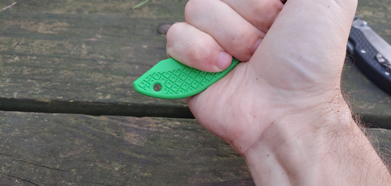

To illustrate, lets compare the Pacific Salt VS Recon XL in my hands:
The Pacific Salt gives me one main grip. If I want to do precise tip work, trim a thread, bear down on a heavy push cut or use the knife as a pocket machete, I have one grip to work with.
Now the Recon XL is certainly guilty of having extra handle even for my larger than average hands, but is it fair to call that space a waste? Not at all. I can choke up for tip work, use the regular grip for general use, or scoot my hand back for superior chopping leverage or to get extra reach. Extra reach is a good thing if you're using an ungloved hand to trim brack briar branches with a small knife - it reduces the chance of injury, and extra leverage is obviously beneficial for pocket machete usage.
That extra handle space adds a lot of versatility.
The Catchermans handle isn't quite as good in these different positions due to the shape of the handle, but like the Recon I have enough space to adjust my grip to optmize my hand position for the work being done.

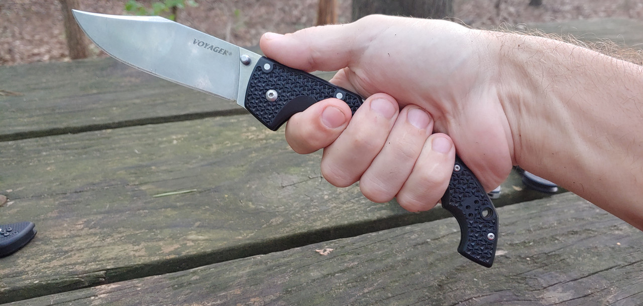

Military and Voyager XL for comparison:
So, designed the right way, having excess handle can add versatility to a folding knife. I do not think excess handle should be viewed in a solely negative light.
