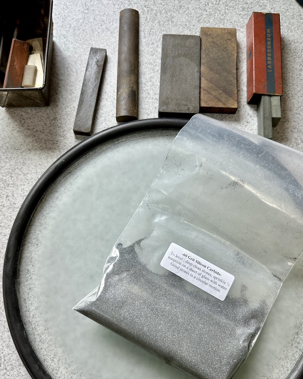

Glass with a plastic protective film, like the stuff they put on new appliances (the "Remove Before Using" stuff). That way the silicone carbide grit sticks in the plastic instead of grinding away the glass, at least in theory.
Re: Flattening Whestones
I've flattened a few whetstones and dressed some resin bonded diamond stones with SiC and a glass plate. I just put the SiC directly on the plate with some water, no protective layer. Haven't noticed any dishing after doing 4-5 stones so far. Easy enough to get another glass plate if it gets dished out is the way I see it. I found that I needed to add water periodically. If I'm switching to a different grit SiC, I'll clean off the old grit/particles first, then start again. Also, buying rock tumbling SiC powder was cheaper than getting stuff advertised specifically for whetstone flattening and worked just fine.

I think you'll be happier with silicon carbide on glass. There's no need to get all theoretical and futz around with "protective layers of laminate." We're not building space shuttles here, we're flattening stones just like our ancestors have been doing for untold generations.
1. Glass
2. Abrasive
3. Water
4. Random motions using the entire plate

The stones that live in the garage are not well cared for. They're not for knives, they're for cutting tools or whatever I might be working on. They get pulled off the shelf when needed. They're generally slopped with cutting oil. If they get gummed up, they get put back and another stone is pulled off the shelf. It's rare when they get any attention. Well, today was that day. They got flattened and cleaned up a bit.
My neck is now sore, my fingertips tender, and my hands smell like sulfur. But the stones are all pretty now and ready for action.
