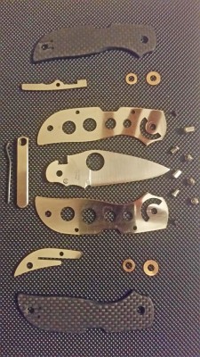

The Chaparral stop pin mechanism, photo found on Reddit. Click to enlarge.

I also found these disassembly photos of the nested liners version, where the stop pin is in a different location on the blade:

Yeow. This is my first time seeing something like that. Getting the pin to bottom out at the same time as the lock drops looks like a whole 'nother level of difficulty.

...Getting the pin to bottom out at the same time as the lock drops looks like a whole 'nother level of difficulty.
For a prototype, yes. For production though? Some added complexity, yes, but enough to price it out of reach? Note that the Triad lock has the same issue: the stop pin must hit the blade just as the lock bar drops into its slot. Doesn't seem to stop Cold Steel from cranking them out, though.
CS was fortunate to patent a more cost effective way of engaging a stop pin. They don't have to drill the blade to insert the pin.
If the answer is just economics and only economics, then why on the Chap and Sage 4? Certainly they could have been made without.
