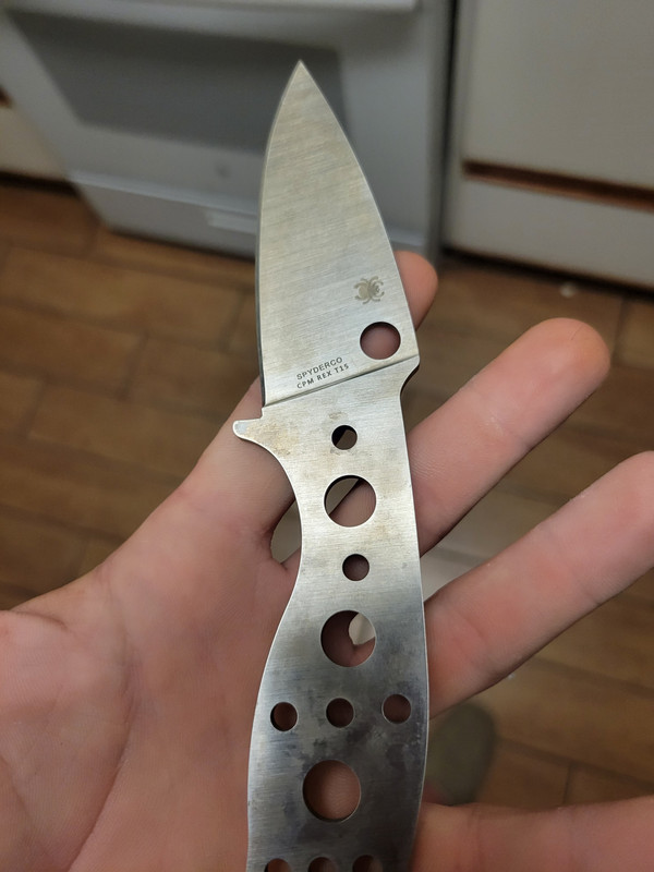

So I was setting up to sharpen a T15 mule and before I started I wanted to clean her up. It still had whatever coating(oil?) they had put on it from the factory(I didn't clean that off first) so I put barkeepers friend on it, scrubbed it down, and it has a bunch if tarnish/rust all over it I can't seem to get off. It's almost like whatever was sitting in the oil coating has set into the steel. Tried dawn soap & water(should have done that first thing) and acetone but nothing has changed. Thoughts?

That is a patina, nothing to worry about since you've removed the active 'red rust' with BKF already. That said, you need some kind of wax or chemical rust preventative in order to keep both forms of rust away. You can also force a patina potentially assuming the steel doesn't resist it too heavily.
I'd not use something too aggressive but lemon juice is pretty acidic and should work if nothing else does. I'd recommend Eezox if you want to keep rust away, it's food safe when applied correct (dry to touch) or Odie's Oil/Wax products if you don't like the chemical approach as there's really no smell/toxicity in applying.

... but here's the thing. It was perfectly fine before I put bkf on it and scrubbed it. Not a single sign of patina or rust. Wish I would have taken a picture before hand. Also, I despise patina and or rust. Was actually sharpening it before sending it(as well as a 15V, & a K294) for cerakote so I don't have to deal with corrosion. I'm trying to figure out what happened chemically to have that settle immediately.
BKF has acid in it and there's a note to remove/rinse before a minute has elapsed. I've noticed it will cause some patina in just a short time, even under a minute. If it bothers you then you can remove it with Scotchbrite hand pads rubbed along the direction of the scratch pattern from the satin. Don't go across or you'll notice it scratch and look terrible.

The reason I posted this was the try and find out what is put on corrosion prone steels from the factory in hopes to figure what happened chemically as well as document my mistake so no one else makes it. I had done a deep clean on a cpl of my other fixed blades(non-mules) the morning before and went straight to the bkf instead of cleaning off the layer of oil/lubricant that was on it from the factory(started like 10 min dt3r I woke up at 4).So... out of the box, knife shows no signs of patina/rust, has coating from factory, , little bit of hot water, bkf straight on it(sat for 10s tops) & scrubbed with tooth brush, immediately is covered with patina/rust. Tried to clean it after with multiple things and nothing.
Next step is to hand sand everything. Will not be making this same mistake in the future.

It has nothing to do with what was applied to protect the steel, I'm assuming you feel there was some sort of reaction there? It's not anything more than heat and acid working it's magic on a steel with little corrosion resistance. BKF says right on the package to both rinse off before 1 minute of being applied AND to also test on an inconspicuous spot to assure it will not have what you presume to be a detrimental effect. Hot water by itself can definitely discolor steel as well.

Are you still wondering what sort of reaction took place? I do not mean this to come off rude but it's simply called rust. Whether you want to call it patina/tarnish/oxidation/rust(oh dear) OR Fe2O3.H2O, it's all the same for the most part.
