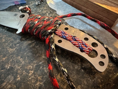

I just removed the paracord wrap on my AEB-L mule, it’s been wrapped since shortly after the AEB-L mules dropped. No rust at all! All I do is spray the paracord with Froglube oil every once in a while. The Froglube drys with no oily feel at all. I’ve also noticed that Froglube oil easily seeps into G10 scales. Oh and I live in the PNW so the knives get exposed to water and salt water often.barnaclesonaboat wrote: ↑Mon Sep 11, 2023 12:00 pmFor what it's worth, I'm on the same bi-monthly tear down and rust spot removal. I also do a coat of oil underneath the scales. Even the AEB-L gets spots for me, although I stop at wiping dry before sheathing and an oil wipe each week of regular use. For the tool steels, I've been considering cerakote to keep the service intervals longer. Even with good blade hygiene, if you can see the ocean it is probably already going to work on your steels, haha.
