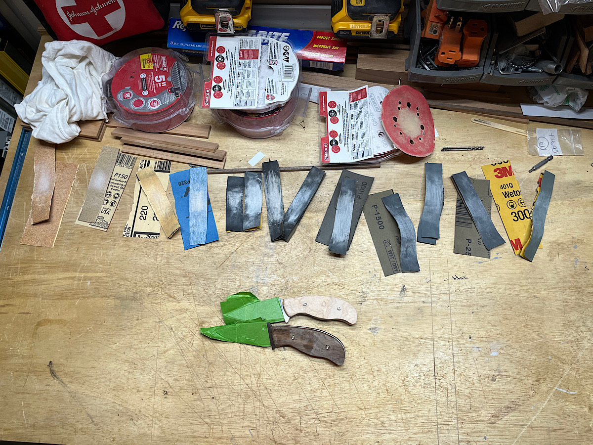

I recently had time to finish wood scales for my two MagnaCut Mules. One is figured maple with black G10 and the other is Walnut with white G10. I plan to give them to my boys when they are a bit older. See below for some of the steps I took to make these.

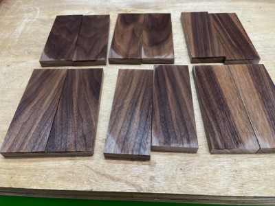

First step was to cut the wood to size, I like to go with about 3/8” thick as you always can take wood away. I then sent them off to K&G for stabilization.
Next few steps are to epoxy the G10 to the wood scales, drill your holes and cut the rough shape. I like to use G10 for both the look and to add some strength to the wood.
Once you epoxy the scales to the Mule it is just a lot of sanding. A belt/disc bench top sander is a huge help to rough shape you handles. I also use my small drills press as a make shift orbital sander for the tighter radius on the grip. From there is it just hours of sanding, my grit progression is 100, 150, 220, 320, 400, 600, 1000, 1500, 2000, 2500, 3000 and finally a buffing wheel with blue compound.

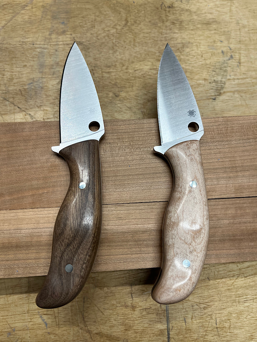

They came out great, my boys like them, just not sure which one I like better… knives that is. Being MagnaCut the blades will never rust and should last forever. Thanks Spyderco for the opportunity to be part of the Mule program.

I think they are beautiful, and appreciate the method explanation.

Well done, also a fan of the natural wood look & feel.

That is something I forgot to mention, there is no finish on these, just sand paper and a buffing wheel to get the shine.
