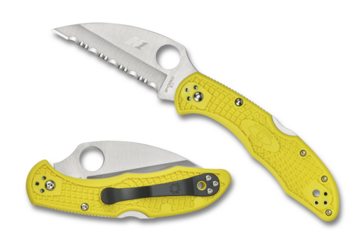

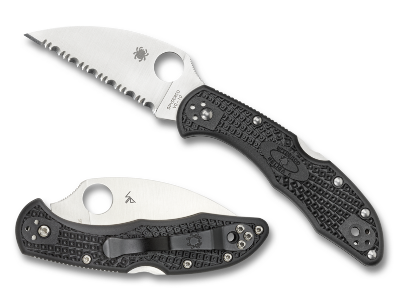

* Delica 4 FRN Wharncliffe SE (FFG VG-10)
* Salt 2 FRN Green LC200N Wharncliffe SE. (FFG LC200N)
* Salt 2 FRN Yellow Wharncliffe SE. (hollow ground H1 or maybe H2)
I'm really interested in the opinions of folks with first hand experience with two or more of SE FFG VG-10, FFG SE LC200N, and hollow SE H1 in the same platform/model and possibly an ordered preference of two or more.
For this purchase, I really don't have any salty requirements. I am leaning towards the SE VG-10 Delica. However, if one of the others really is a better performer in some measurable or noticeable way, I'd rather get that instead.
Thanks in advance,
Christian

I have all three. While I actually "like" the H1 Salt version best (and will someday finish reprofiling it to 15°), the flat ground Delica and LC200N Salt are better slicers. So, I guess it depends on whether you have an irrational need for liners, or would rather use the knife that's 20% lighter. My preference is the LC200N Salt.

I own and use all of them. My first choice is the SE wharnie Delica in VG10 unless you need extreme corrosion resistance. The SE wharnie Salt2 in LC200N is just as good but you might feel the need for the extra rigidity given by the nested liners so in the end… it depends. The SE wharnie Salt in H1 has the stronger blade but the hollow grind is not high enough for my taste. That being said, the H1 serrated edge will outcut the other two but you will not be able to feel the difference in real life.

IMO the durable cutting power of serrations mask H1's horrible edge retention, but IMO LC200N both has better wear resistance and is more resistant to rolls than H1, so it is the overall superior steel unless you just need something that is completely chemically impervious to rust.
Re: serrated Delica/Salt 2 sized wharncliffe experience/recommendations
i've had the opposite experience with se versions of both steels. my caribbean serrations rolled in several places cutting a plastic strap, so i got my se h1 pacific salt out and tried it and it had no issues. it could be that the h1 is hollow ground vs ffg, but i don't know. h1 is more of a workhorse to me than lc200n, but i like them both.metaphoricalsimile wrote: ↑Tue May 02, 2023 3:51 pmIMO the durable cutting power of serrations mask H1's horrible edge retention, but IMO LC200N both has better wear resistance and is more resistant to rolls than H1, so it is the overall superior steel unless you just need something that is completely chemically impervious to rust.

Even with the hollow grind, I thought the H1 Salts were still pretty thick behind the edge. I wonder if that gives H1 an edge at the edge
in regards to rolling. Seems like I have read here that the H1 Salts take abuse at the edge better. My LC200N Pac Salt loves to roll.
that's what i was trying to get at. i think it's thicker and it takes on tough work better. the h1 salts beg for use.JSumm wrote: ↑Tue May 02, 2023 5:40 pmEven with the hollow grind, I thought the H1 Salts were still pretty thick behind the edge. I wonder if that gives H1 an edge at the edgein regards to rolling. Seems like I have read here that the H1 Salts take abuse at the edge better. My LC200N Pac Salt loves to roll.

Idk, but my serrated H1 dragonfly rolls if I use it on cardboard, whereas I can hack through a 1cm thick vine in a single swing with my LC200N Salt without even a hint of damage.

interesting. i don't use my se h1 df2 salt hard, but i've never had any rolling with it or my se h1 pac salt. i've had rolling on the teeth of my caribbean, but none on any of my pe lc200n blades.
I'll preface this with I'm not saying you are wrong. The dragonfly in H1 actually has a nice high hollow grind. Definitely better in that regard than the Salt 2. So I could see how it wouldn't take hard hits as well. And vines and limbs outside though thick are typically pretty soft unless you hit a knot. I really do think the H1s have a better reputation for not rolling in the Salt and Pac Salt due to how thick they are behind the edge, but that is completely my uneducated guess. I went LC200N with the Pac Salt because I new it would glide through material better, but I would guess that the thicker Salt and Pac Salt in H1 would hold up to rolling better. LC200N has not done that well in my experience. Sharpens out easily though.metaphoricalsimile wrote: ↑Tue May 02, 2023 6:06 pmIdk, but my serrated H1 dragonfly rolls if I use it on cardboard, whereas I can hack through a 1cm thick vine in a single swing with my LC200N Salt without even a hint of damage.
