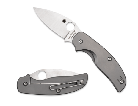

Good question @Bolster. I've always prefered the RIL cut-out on the inside for aesthetics (Sage 2, Military), and was puzzled about why so many designers would choose to put it on the outside. I never thought to ask the question!

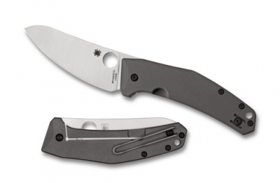

I've seen YouTube videos where somebody tries to explain why one way is better than the other. This came across as "bro science" to me. They didn't cite or show any experiments with an attempt at controlling the variables. They just spoke in hypotheticals. I prefer the looks of the lock bar cutout on the Sage 2 over the Chef.
