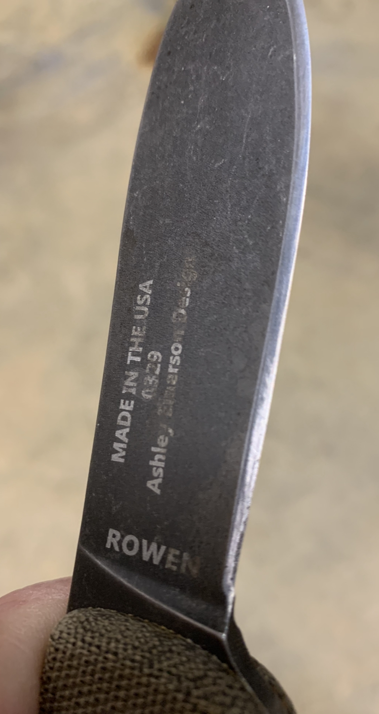

I do and find it very effective. I have used it on M4 and all my kitchen knives. Here is a before and after of 1095 that got wet (and I didn’t notice soon enough). This was done with only BKF and a scrub sponge. It’s not perfect but still pretty amazing. It did similar work on spyderco super blue kitchen knife my wife left in the sink. I have never noticed any swirls that would make me think there is much abrasive action.Rymanz wrote: ↑Sat Dec 10, 2022 4:32 amDo you use it on your knife blades as well? If so, are you just as satisfied for that use case?JD Spydo wrote: ↑Fri Dec 09, 2022 7:57 pmI can't tell you first hand that YAB isn't kidding you about wearing protective gloves when using Bar Keeper's Friend cleanser.yablanowitz wrote: ↑Thu Dec 08, 2022 9:25 pmOxalic acid. It's a chelating agent, it reacts with iron which makes it very effective for cleaning rust and steel off ceramic and porcelain. You should avoid prolonged skin contact and I'd advise against snorting it.

So does the chemical components of BKF make it a bad choice for non-stainless steels?
(edit) Oh, never mind, somehow missed the picture of BKF being used to clean up some 1095. Pretty nice results there.
