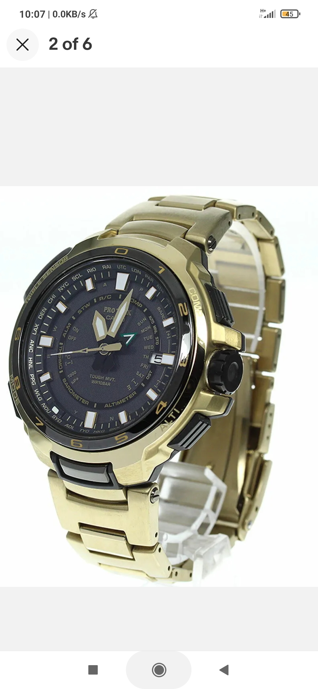

Happy to oblige Mac. I feel like this thread needs some more pictures so I'll start by posting my current grail Casio model number and perhaps you can fill in the description and post one of your own. Like a quiz but fun! Here we go...
PRX-7000G-JR =
PRX-7000G-JR = solar atomic analog ProTrek series 7000 with sapphire crystal and stainless steel case & bracelet in gold ion plating and stainless steel bezel in black ion plating released in Japan

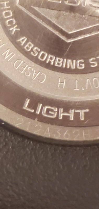

Hey guys, I'm not sure I can date mine?
If this is the serial number 212A362H
Re: Casio code/nomenclature
Posted: Sun Jan 29, 2023 8:48 am
by MacLaren
Actually I didn't read your instructions well enough!
I think mine was made the 362nd day of 2018!
That's where I got confused was day of month vs day of year!
Cool!
So yeah, mine was made Friday December 28th, 2018.
Very cool 😎
Posted: Sun Jan 29, 2023 10:27 am
by max808
Spot on Mac, assembly date may vary slightly, it's more of a batch code when the backplate was stamped. If it's the one from your GWG-1000, yours is likely fail proof. Some forums said earlier specimens could exhibit defective action of the seconds hand if memory serves, which apparently was resolved around that time.
Posted: Sun Jan 29, 2023 10:54 am
by MacLaren
Awesome! 😎
Yeah man, that's from my GWG 1000
Mine says Japan Mvt H Cased in Thailand
