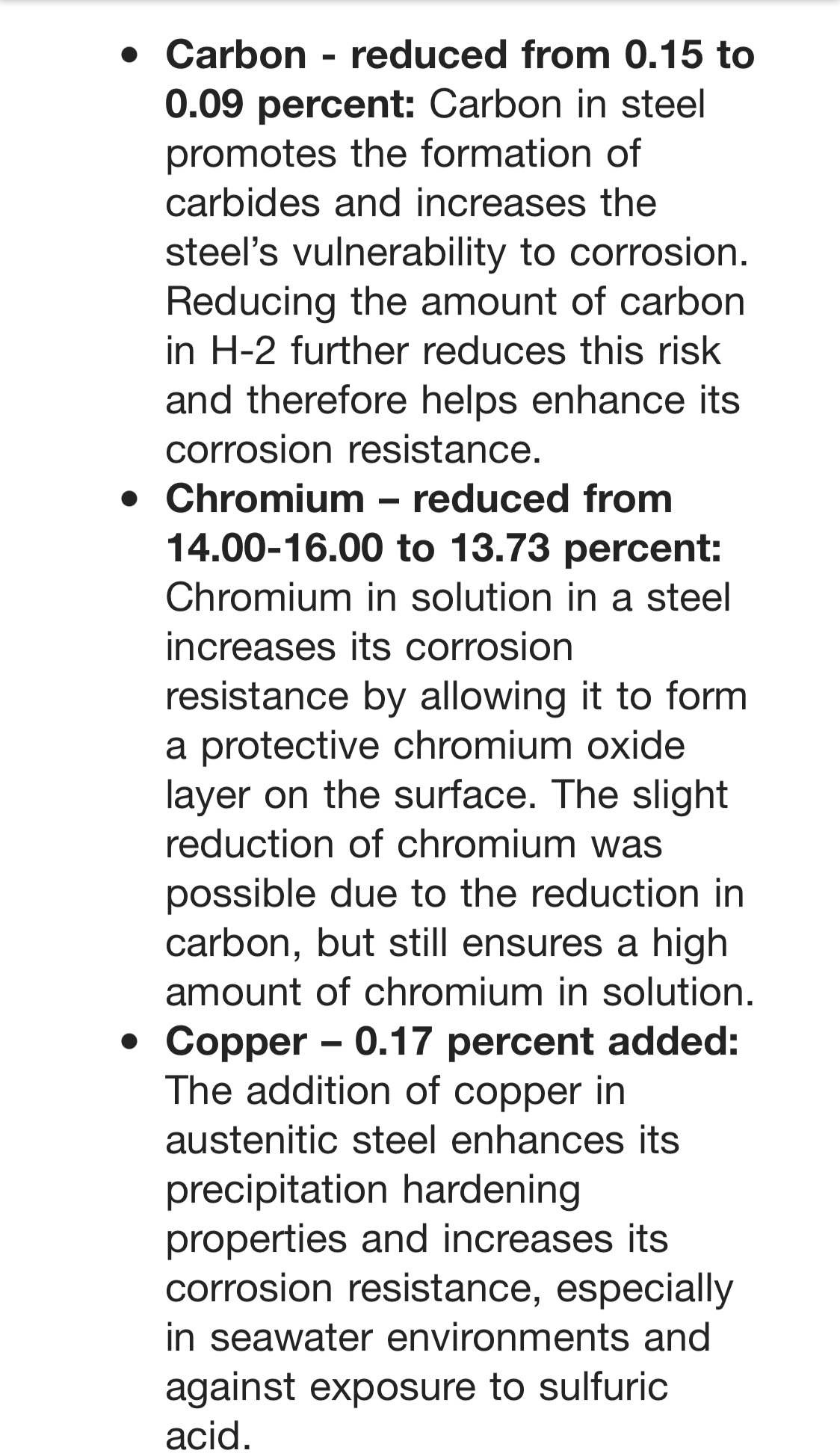

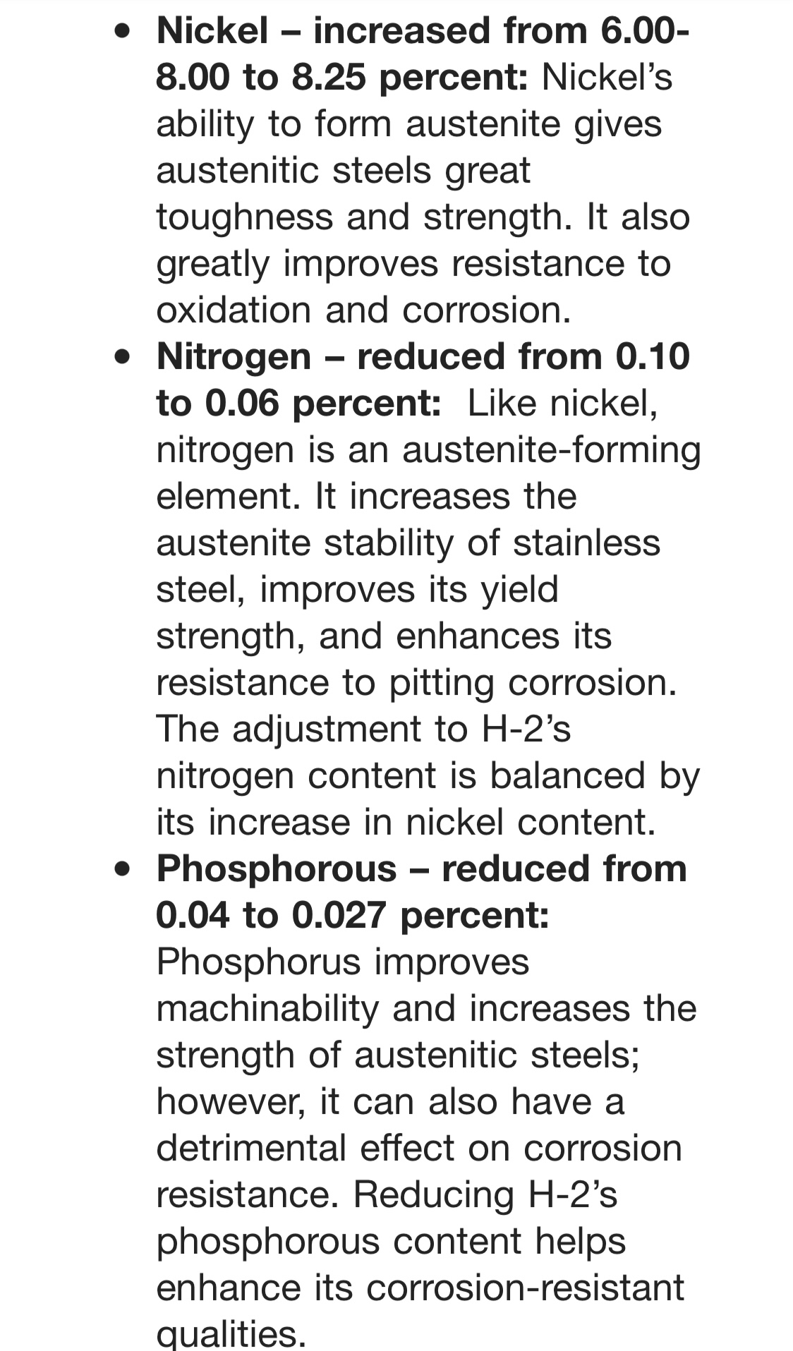

I was excited to read the May byte dedicated to my favorite model, the Pacific Salt. It appears Spyderco is moving to an upgrade of H1 called H2. H1 is what got my into Spydercos in the first place years ago so I am excited to test out H2. Here are some specs from the byte:
[attachment=4]A1BA6262-8E76-4F09-AB8C-071FDB4AE415.jpeg[/attachment]
[attachment=3]0BC40733-4E4F-48A8-BDFB-B5EE88F778A8.jpeg[/attachment]
[attachment=2]B7E1B03B-3272-48BF-BDCE-31BEBDEEC0DA.jpeg[/attachment]
[attachment=1]6DEF5DC6-6F30-488D-B76D-4D50225BB852.jpeg[/attachment]
[attachment=0]A39AF9DE-2D8F-46F7-8434-0820FFC8514C.jpeg[/attachment]

To better ….corrosion-resistant properties.
I’m really curious what effect this change will have on Edge Retention.

I'm curious how less carbon, less nitrogen, and less chromium will manifest in steel characteristics.
