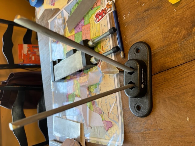

Gail and I have been using a combination of the Murray Carter kitchen knives, both at home in Colorado, and our condo on the island. Along with each set, we use one of the new “Galley V’s” that are set a 10 DPS (20 degrees total).
We use the 5 pc set in one of our Maple blocks. A high line version in Super Blue San Mai in Colorado, where it’s fairly dry and a set of G-10 handled CTS-BD1n on Island, which is very humid. The more we use them, the more we can appreciate Murray’s experience in leading to the designs, and the thin flat execution of the designs.
Murray and I go back more than a decade. I’ve watched his development here in the US Since he came in from Japan, where he earned his art. (I own one of his Murray Career Folders). He’s a very effective bladesmith, but he’s also an artist. He has created a very effective set of kitchen tools. We have tried to bring you that exceptional refinement at a variety of price points. (Super Blue san Mai, with exotic custom G-10 handles, CTS-BD1n with machined G-10 handles and CTS-BD1n with injection molded handles.
Gail is a skilled chef, I’m often the “cut guy” prepping. We like our edges thinner. Even thinner than “stock”. I use the Galley V with the CBN rods to re-profile to a 10 DPS and I use the ceramic rods for regular maintenance.
It’s an expensive package, but the combination is an effective solution to kitchen prep. I thought to share our personal experience with the combination.

I’ve been using my Galley V with the CBN rods from the Gauntlet to set a few knives at 10 dps as well. Then I finish them with the ceramics that came with the Galley V. I’m eyeing one of the injected molded with BD1N for my wife.

Quick question, are you using the CBN rods from the Gauntlet in your Galley V? I couldn't find any Galley V CBN rods for sale or not for sale for that matter.
They aren’t as long but they work well nonetheless.
They're the same in cross section?

I’m interested in the CBN Gauntlet rods for reprofiling on my Galley-V. How long are they?

They fit perfectly for me. I bought the Gauntlet and Galley V planning to use the CBN in both and it works perfectly.
I’ll check for sure later but I think about 2 inches shorter.
ETA - 9 inches for the Gauntlet CBN and 12 inches for the Galley V ceramics

Hi Zrows,
Yes, I'm using the CBN rods from the Gauntlet in my Galley V.

Knowing they are compatible is a plus! Thinking back on it, I think I originally passed on the galley V because it only had a fine ceramic stone.
