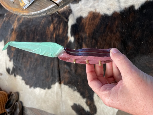

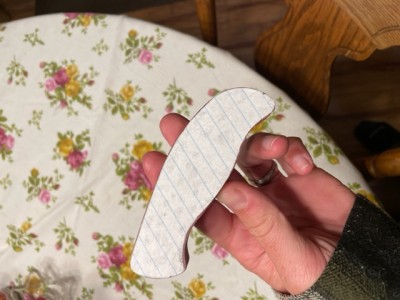

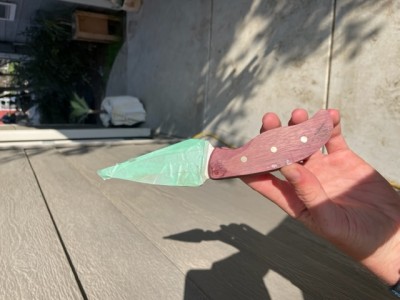

Well with plenty of help and great info from people and posts here on the forum I started my Magnacut's Handle build. For this I used Purple Heart wood that my grandfather gave me. He also helped with starting the shaping so this will definitely be a keeper. Much of my build was done by referencing Xplorer's how to handle build post (viewtopic.php?t=89740) To start I traced my mule on a piece of paper, cut it out, then glued it on my scales, and cut it out and shaped it with a band saw and a drill press sanding drum. That got me to here.
Then I drilled out the pin holes for my 3/16th brass pins using my tracing on the scale. Next I started sanding the top of the scales because it would have been much harder to do once the knife is glued together.

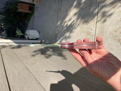

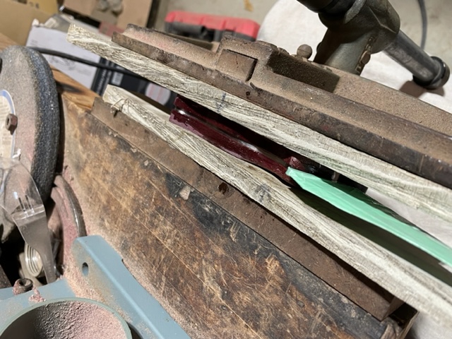

After that was complete I glued it up and stuck it in the vice. To clamp it with this vice I took to scrap pieces of wood and drilled holes matching that of my mule so that the pins would not be clamped but the handle would.

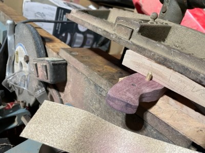

After leaving over night I ground down the pins on the bench grinder being careful not to let them get too hot.

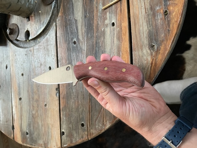

Then again referencing Xplorer's post I ground down some brass to scrape off the excess Epoxy around the blade and on the spine. Which has me to my current state so far.
Next is applying some finish and possibly torching the wood or trying the acetone method recommended by Bolster to make this purple heart really purple!

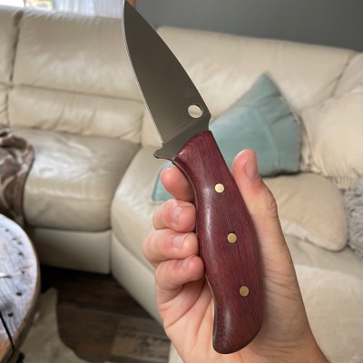

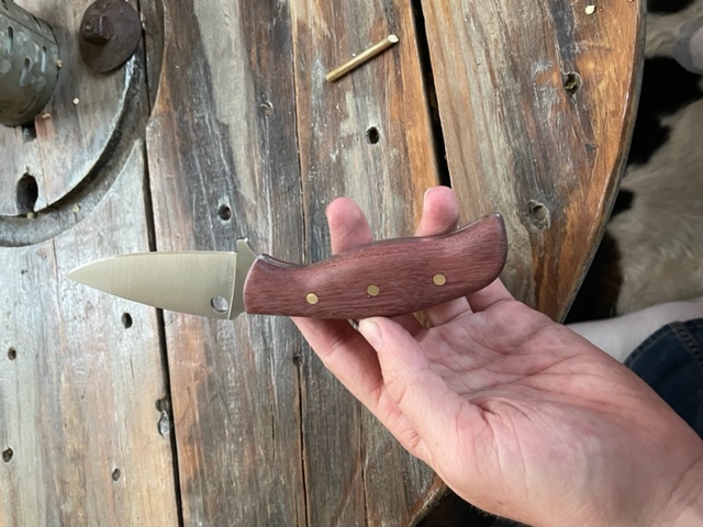

Took the handle to the buffing wheel and wow! I love how it made it feel! Color is changing as well.

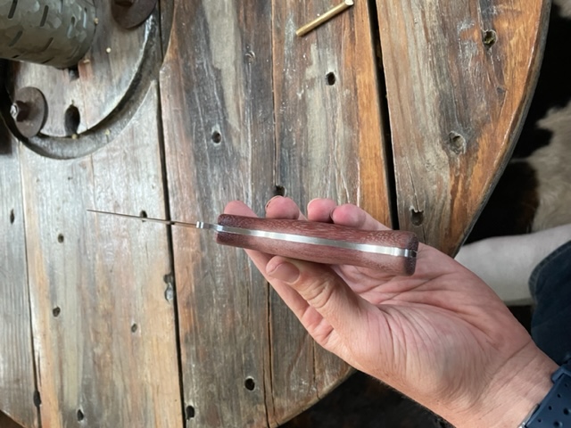

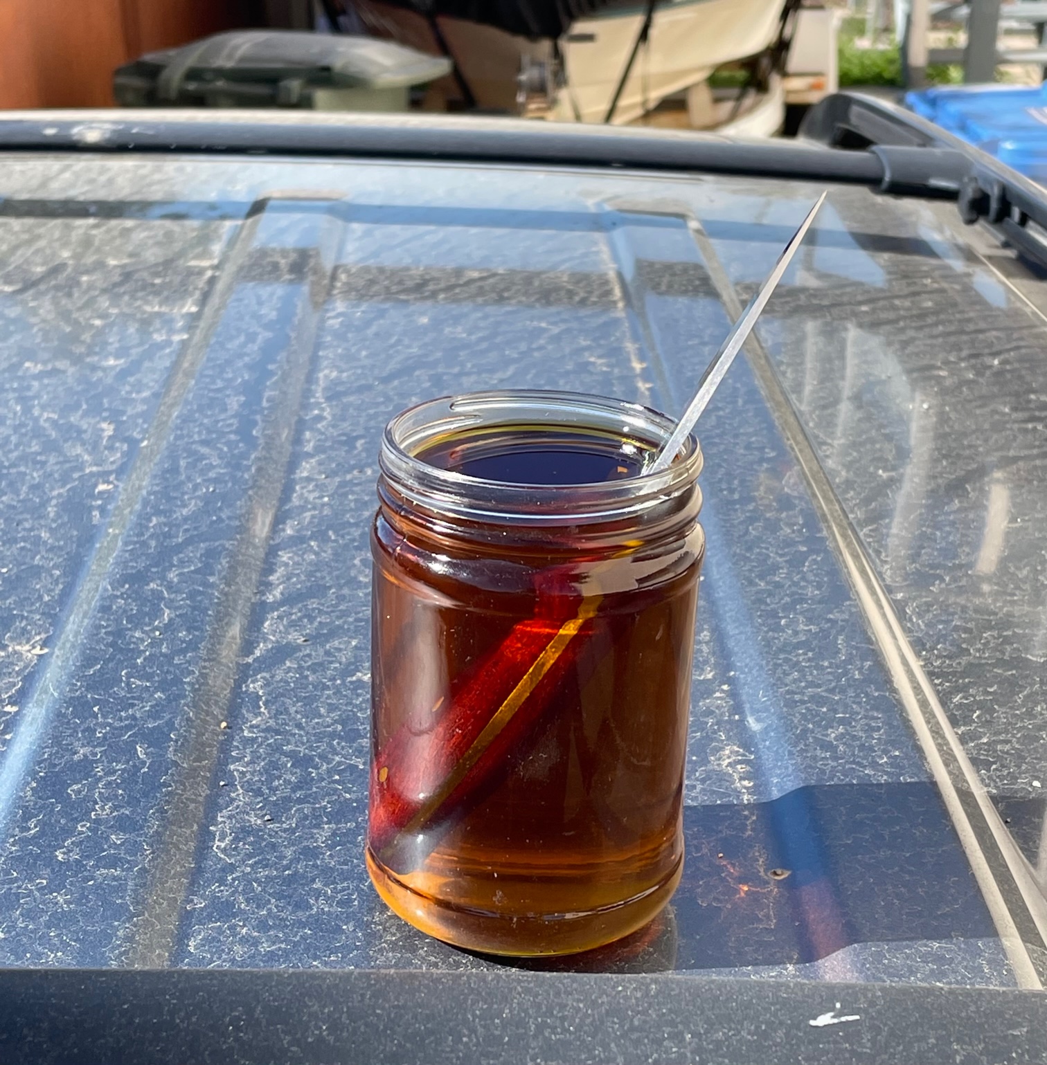

Soaked the handle in BLO for 24hours. Left it in the sun during the day to both warm it up and perhaps make it even more purple! Now I'm letting it dry out and will repeat the process the traditional way! I also found some UV resistant wax combo to rub on once finished! Excuse the dirty car roof. :')
