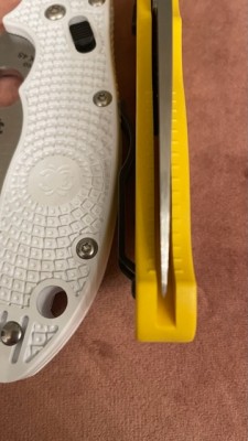

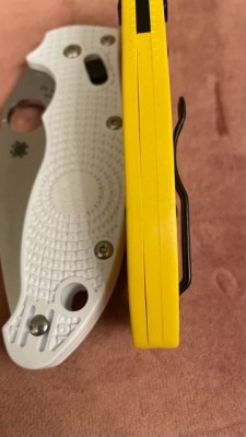

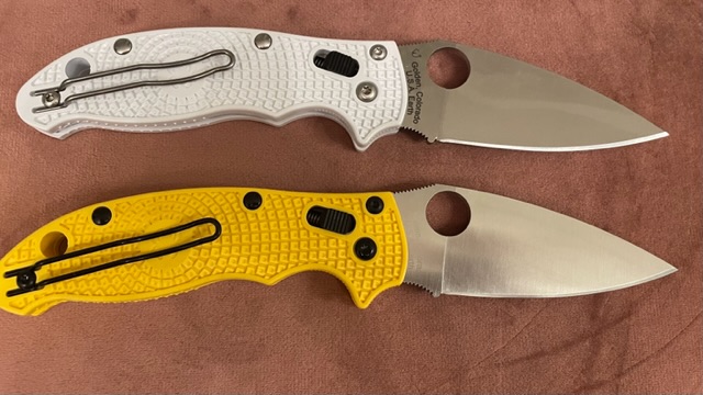

The Manix 2 LW MagnaCut arrived!
I need to mention a few things. It looks like there are some slightly differences between Manix 2 LW MagnaCut and GP knives exclusive Rex 45
The spring lock on Rex 45 is stronger compared with MagnaCut, it’s a little bit harder to close it.
The blade on MagnaCut is slightly off center as you can see on the photo
Also there is a hair gap on the back of the scale on MagnaCut. I might need to take the knife apart and sand the scales properly and then I will dye them on black color.
The Spyderco logo is more pronounced on Rex 45, I’m not sure why, maybe someone can explain.

My MagnaManix also arrived with the blade slightly off center, about the same amount as yours, but in the opposite direction. I have not tried the straightening tricks yet. It's slight enough that it's probably not worth the effort. I had not noticed the hairline gap, but when I looked, I can see may be a quarter-hair gap or less in the areas between screws, in the same areas as yours. Below my level of noticing, had you not pointed it out. I checked my other MxLWs and noticed similar on the recent red 4V, but not on older pinned models.
Regards the non-black Spyder logo, I believe this was recently discussed in the "Random Spydie Chat" thread.

I gave re-centering a shot after all. It was as simple as loosening the pivot screw, pushing the blade over a little, and tightening. Now centered, and staying that way through multiple cycles.
