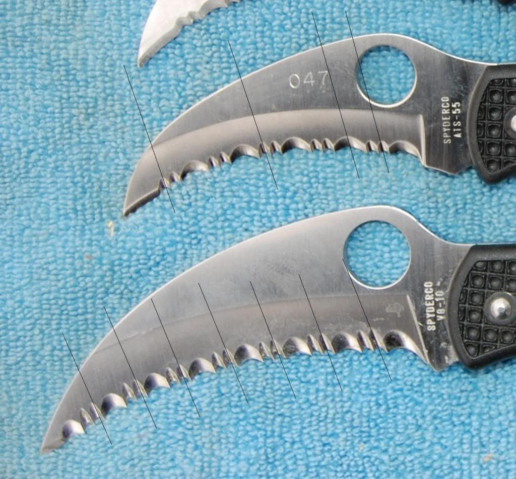

I understand what you’re describing. But I doubt that is how it’s done. For one thing you would need custom profile grinding wheels for each model. And you’d see imperfections in the serration depths due to variations in blade geometry from unit to unit. Also you wouldn’t see the differences in serration geometry that we see from one end to the other.yablanowitz wrote: ↑Sun Oct 17, 2021 8:54 am
Picture that same wheel being three times as wide, and instead of each peak being the same height (wheel diameter), picture them getting taller and taller as you go from the right side to the left. Or shorter, then taller, so the overall shape of the wheel matches the shape of the blade,
My assumption is they use the narrower wheel shown above and use the standard trick for cutting serrations of overlapping the stone with the previously cut serration. This lets you follow the curve of the belly on an arbitrarily long knife.
Tricky business no doubt, but simpler than having wheels designed custom per model.

Your way makes sense for one-off customs. I'm talking about mass production, doing hundreds or thousands of pieces at a time. Which makes more sense, cutting 3 or 6 scallops at a time, repeating 3 or 4 times to do one blade, then repeating a thousand times for one production run, or making a single shaped wheel for each model? How much variation from piece to piece would you get each way, how many QC rejects would each be likely to generate?zhyla wrote: ↑Sun Oct 17, 2021 11:18 amI understand what you’re describing. But I doubt that is how it’s done. For one thing you would need custom profile grinding wheels for each model. And you’d see imperfections in the serration depths due to variations in blade geometry from unit to unit. Also you wouldn’t see the differences in serration geometry that we see from one end to the other.yablanowitz wrote: ↑Sun Oct 17, 2021 8:54 am
As far as following the curve of the blade, they don't. The centerlines of the scallops are parallel for the length of the blade, regardless of the curvature.
