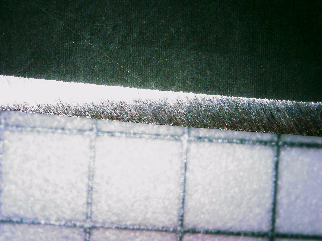

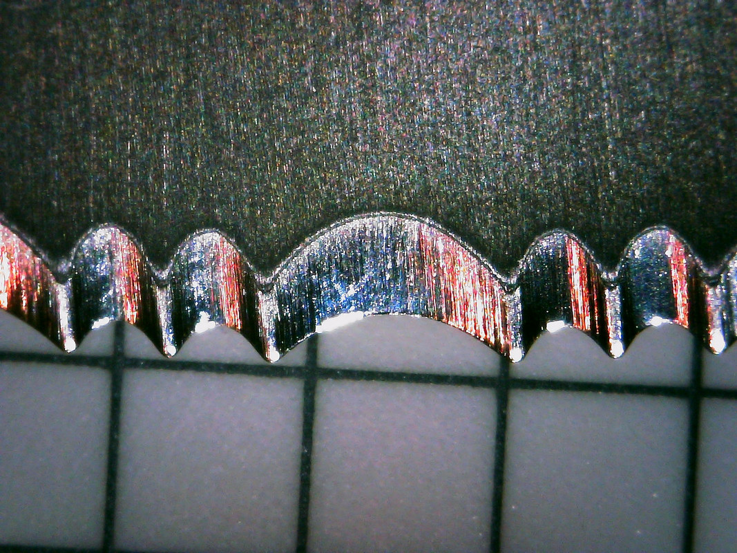

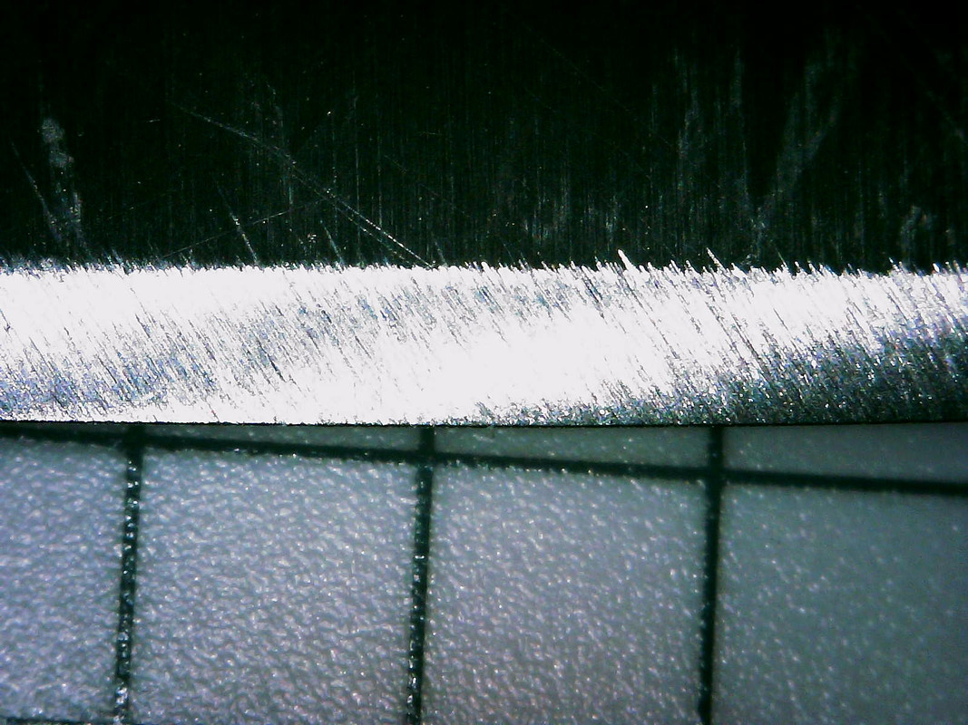

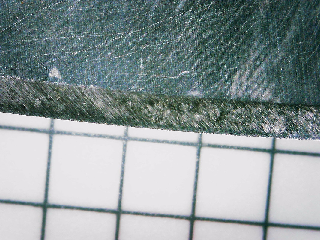

In a recent thread we discussed photographing knife edges under magnification.
This will be a thread dedicated to sharing those photos.
I'm using a USB microscope under the brand Plugable with 250x zoom. If you search for them on ebay they're only $20.

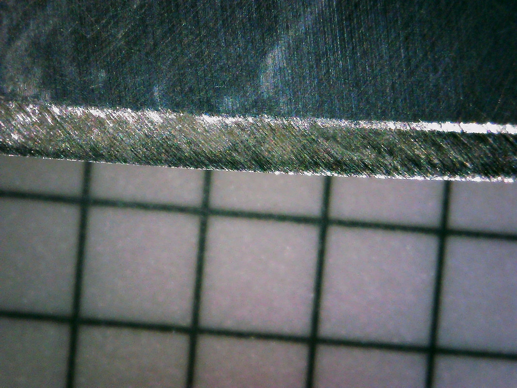

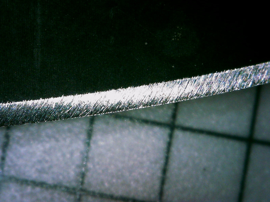

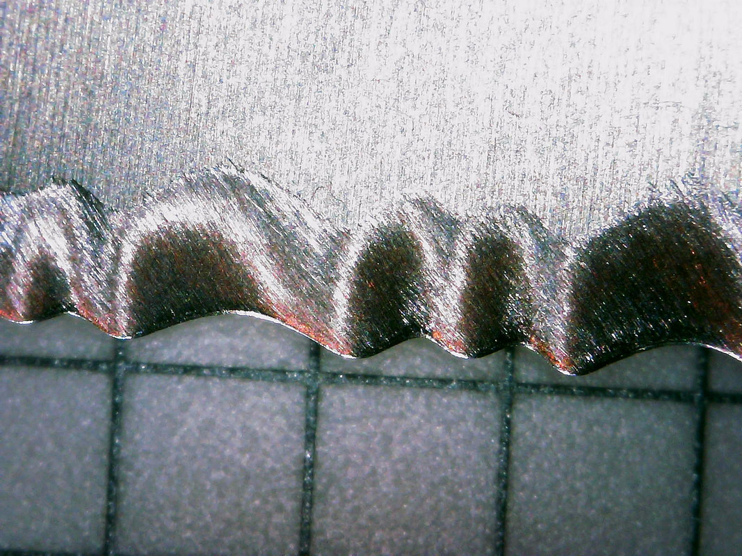

This is my first set of images. I'll try a better lighting setup next time.
H1 Pacific Salt PE - Sharpened by hand on a 200 grit diamond stone to about 10 degrees per side. Has seen use since sharpening but still scrape shaves.
LC200N Pacific Salt PE - Sharpened by hand on a 200 grit diamond stone to about 8 degrees per side, microbevel on spyderco sharpmaker at 15 degrees per side with fine white rods. Fresh edge, hair popping sharp.
S30V DLC Yojumbo - Factory edge after some utility use

Vivi, what is your grid background in those photos, and what size are the squares?

It's the squares on the stand. From pics on Amazon they're 5mm x 5mm each

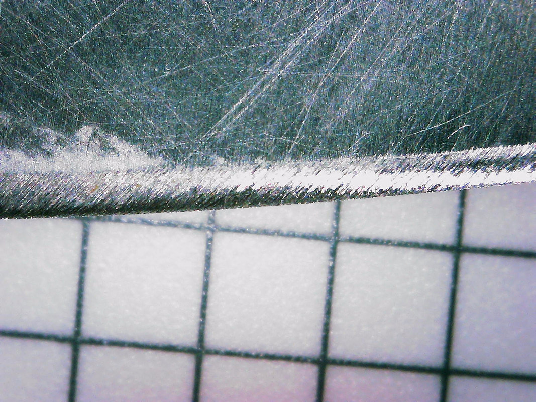

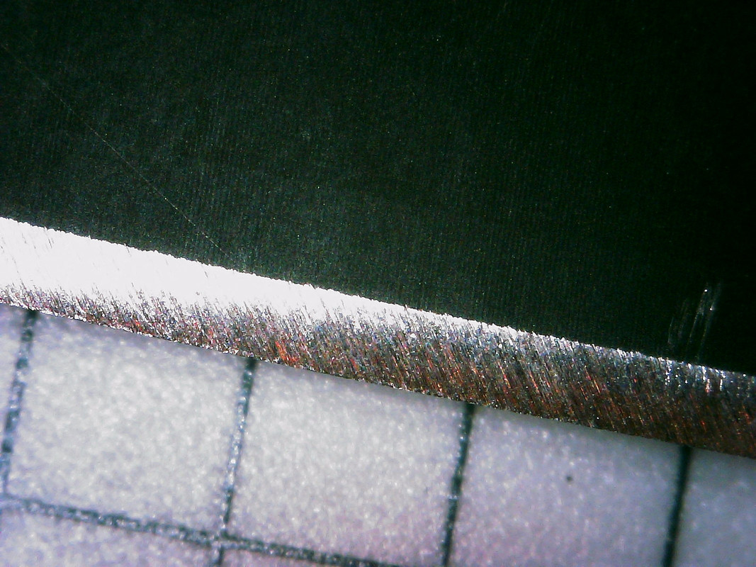

Posts: 16209
Re: The Edge is (no longer) a Ghost

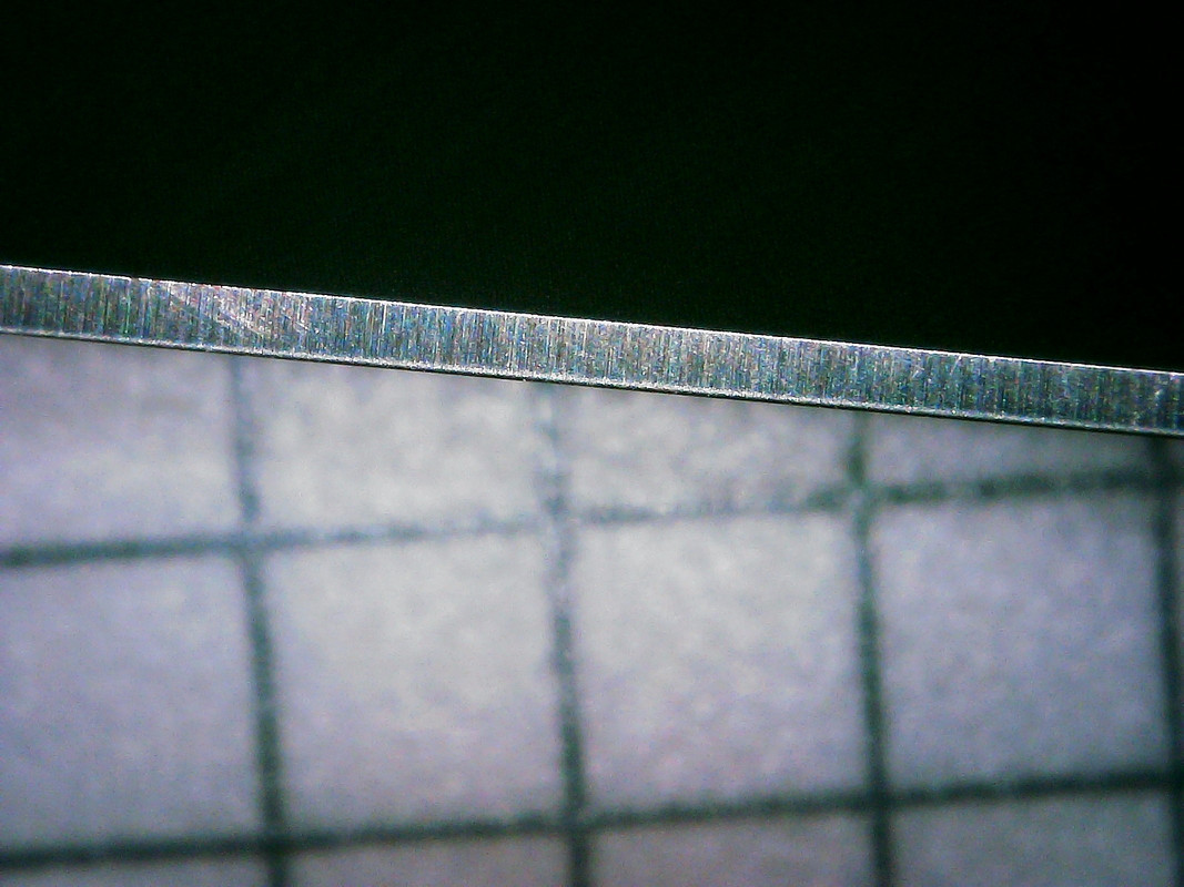

H1 SE Pacific Salt 1 - Heavily used and abused for over a decade. Reprofiled bevel to 15 degrees on diamond sharpmaker rods, sharpened at 20 degrees on brown medium rods.
(compare how fat this apex is from repeated 20dps sharpenings compared to my microbeveled Military below)
DLC Military S30V - Reprofiled to roughly 12 degrees per side on my 200 grit diamond stone from harbor freight. Sharpened one stroke per side with a feather light touch on fine white sharpmaker rods at 15 degrees per side. Carried and used for a few weeks since edge was set, still aggressively shaves.
The idea behind this sharpening method is to have extremely aggressive slicing performance combined with a high level of push cutting ability. Applied correctly the edge will aggressively shave and push cut thin paper while retaining most of the microserrations from the coarse stone.

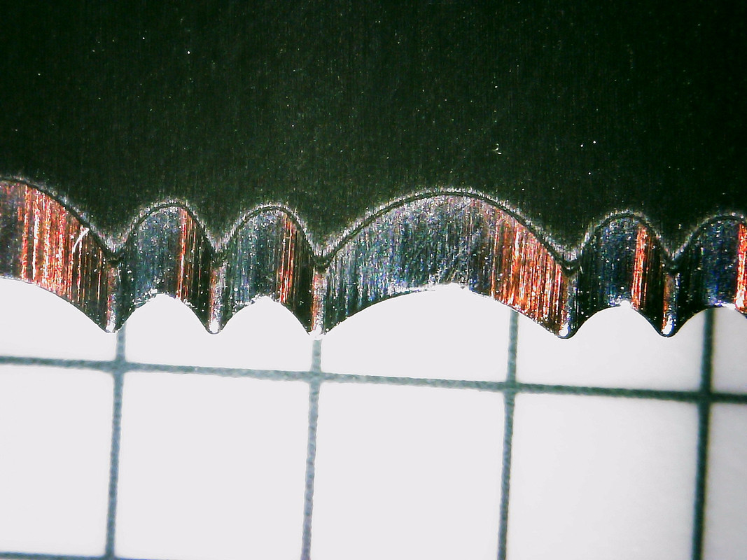

H1 SE Pacific Salt 2 - Brand new, never cut with.
PE H1 Aqua Salt - Reprofiled to the 8-10 degrees per side range on a 200 grit diamond stone. No follow up strokes on ceramics, just stropped twice per side on 7 micron diamond paste. Used hard since knife was edged, including batoning & prying apart fire wood, carving wood, splitting and carving fatwood, light chopping etc. Edge still covered in pine sap.
The aggressive microserrations are easy to see on this edge. Just imagine how much longer a low edge retention steel like H1 will cut with an edge like this vs a high polish edge that is worth little once it loses hair scraping sharpness.

That macro photo of the bnew Pac Salt 2 looks like a bloody row of teeth, not gonna lie. Awesome pics vivi.
Posts: 16209
nerdlock wrote:
Thu Sep 16, 2021 5:46 am
Yeah, it's pretty wicked looking :)
I was surprised at how rounded the tips of the teeth look under magnification.

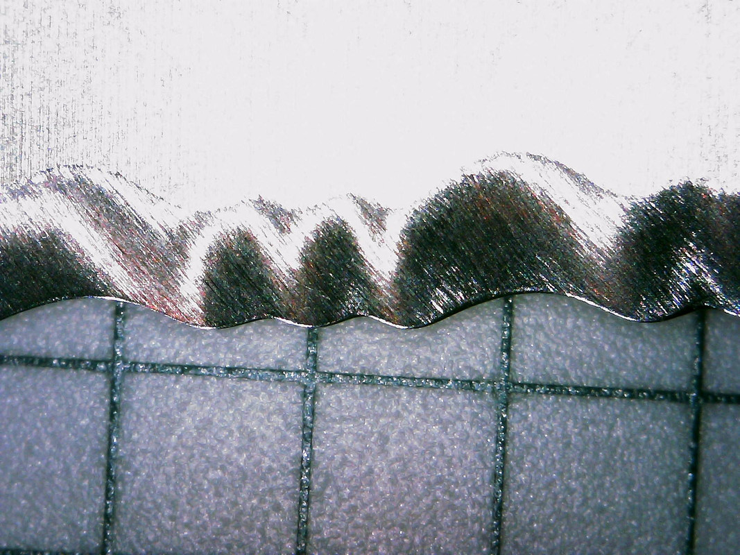

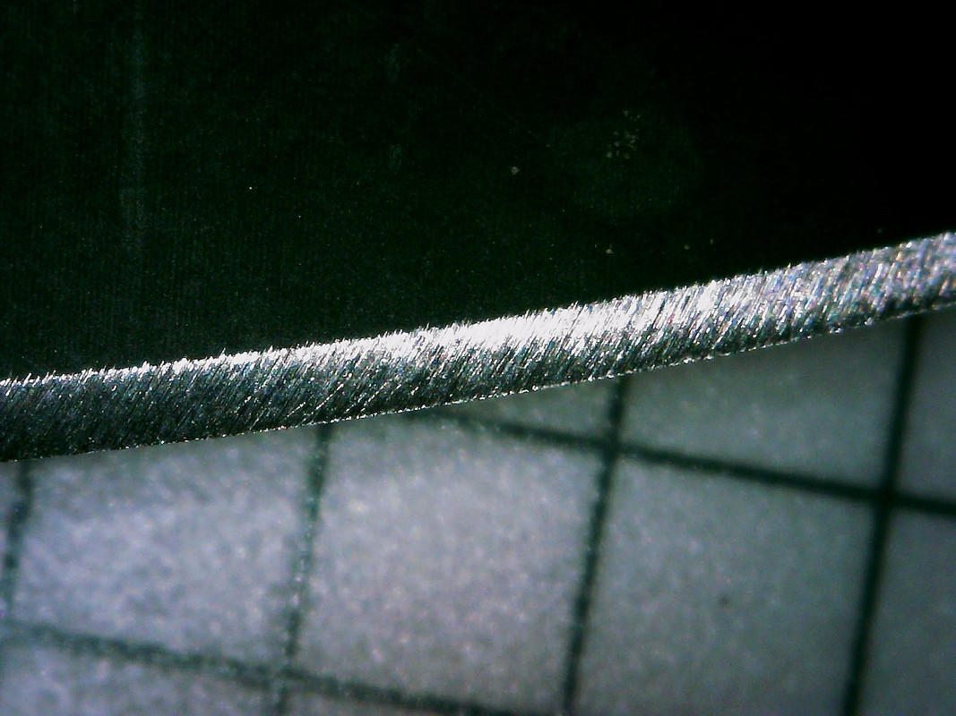

I went over to the'bay and grabbed one of those USB microscopes. It came in today, and I've been messing with it a bit, taking some photos
Here's one of I took today with it of a 260 grit edge on a Spyderco Endela w/ 20CV steel
that edge has been used all day doing yard work, cutting branches, saplings, and vines. I've wiped it off of course.
I'm messing with different ways to light the edge for the image
u.w.
the lighting is definitely the trickiest part.
the edge looks nice! i love how you can really see the micro teeth along the apex when zoomed in like this.
Whenever I reset the edge on my Yojumbo, I'll get some pictures prior to using it.
