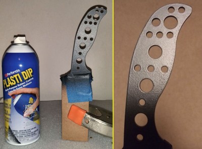

I was fortunate to obtain one of the MT28, CPM SPY27 knifes. I planned on doing a cord wrap since I am tapped on funds for handle materials right now. Once I got it, I decided I would pull the Halpern scales off a MT27 I have and use those temporarily. When I did, I noticed a very small bit of staining on the PD1 blade.
I then decided I wanted to wrap the PD1 instead. I thought coating the blade first may avoid any potential rust forming under the cordage in the long run. I didn't want to unwrap it down the road just to check. I had done this before on a different blade and not only liked the small amount of extra bulk, the edges give a more rounded feel.
I coated the blade first using some of the Plasti Dip products is all.
Note, if you just want as thin of a profile as possible, a few coats of the spray product below will do quite well and I included pics of what that looks like. I imagine if you simply did some spray paint it may accomplish the same thing.
End results
The spray on product and results before wrap

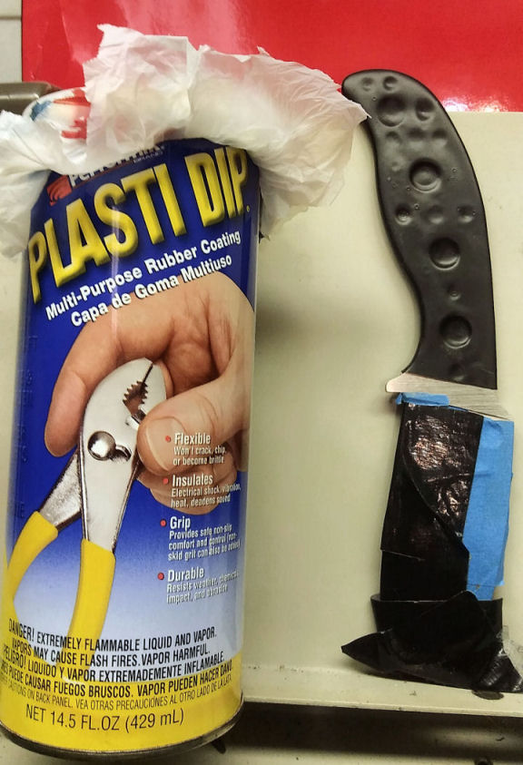

Then additional coats with the liquid product. This is after 3 dips. Notice the thicker results.

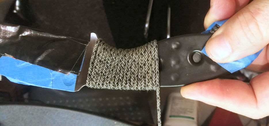

And "wrap action" shot after 3rd dip.
End results

Correct, it is 3/32 "Tether cordage" from Countycomm. However, I just checked, it looks like they no longer sell it.
I bet you can find something similar. I really like the texture and feel on the small diameter and single layer wrap. Also on the previous blade I wrapped, I used Atwood Micro cord which is smaller at 1.18mm. It also feels nice to the touch. Both give really good grip and texture and less bulky than 550.
It may not be obvious, but the plasti dip stuff, which feels like firm rubber, certainly helps to keep the cordage from slipping around. I stays in place very well compared to a bare metal handle. For that reason alone this stuff is GTG. I originally used the spray stuff on a Cold Steel walking cane because the plastic handle was slippery. It worked fantastic for non-slippage and I was surprised how durable it was once you add a few coats of it.

Right, good question. If you wanted to you could peel off the liquid dip coating later. I have peeled it off of a tool before and it came off clean. It might take some determination with all the holes in the Mule. I think the spray version would take more work to remove honestly. But I think it could be removed with some solvent easily. It's just not a thick layer like the dip is, which you can grab and rip off if you wanted.ykspydiefan wrote: ↑Wed Mar 31, 2021 10:56 amI am interested in low cost options. Are you committed leaving that handle as is now, or could you reasonably remove it and put scales on later? Or, would you just slap scales over top?
The spray adds very little depth, that's how I would do it if I wanted to add scales on top. You can add multiple layers of the spray. Even then, it is hard to tell if it adds any thickness. In the past, I had contemplated spraying a layer on a different Mule before adding some Halpern scales. But, the scales were not black and I wasn't sure how it would look. You certainly could also add scales with the thicker dip product, as long as the dimensions of the scales still work since the dip adds some bulk.
This is the first time I did both spray and liquid dip. With all the holes in the Mule handle, I just wanted it to come out as perfect as possible. Lot's of drying time between any additional coats with either product. And LOTS of stirring of the liquid one for best results. ...Several minutes of slow stirring to avoid bubbles. With three coats of the liquid, it really starts to look good and it's very usable without cordage just like that. Imagine the rubber coating on a tool handle like pliers.
