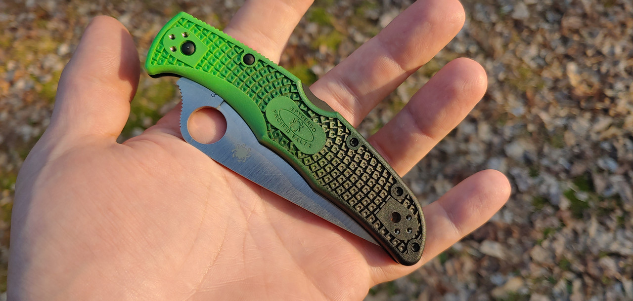

It seems like the knife is a linerless Delica, with slight blade shape differences and (practically) rust proof blade/hardware.
My question is this: if I have a Delica parts kit (for the liners), can I use aftermarket scales and back spacer to create a non-acid green version of this knife, or is the hardware (or pivot diameter) dimensionally different enough that it won't work?
Obviously it wouldn't be to full Salt spec, since the liners will be standard Delica parts, but that's not a concern for me.
TIA!
TIA!
-David

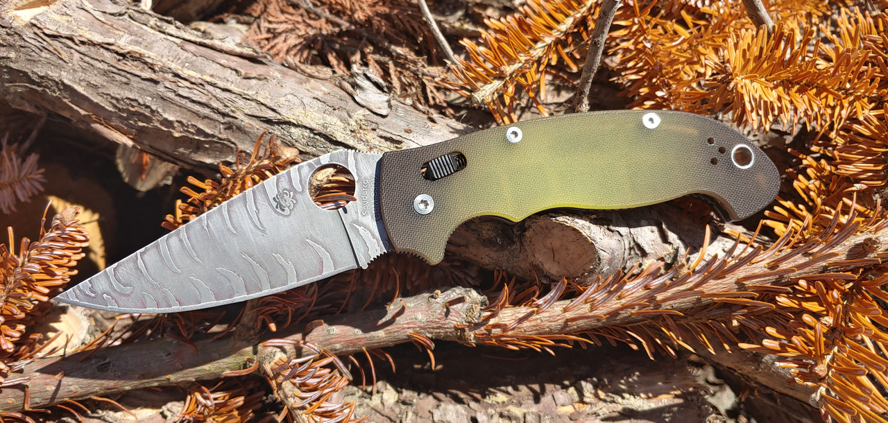

Just dye the scales.
Re: Salt 2 LC200 questions
$2 in materials and 20 minutes of time and OP can have what he wants.
It is so easy. You can even save the dye for next time you have a project. The black dye I used on these two knives is from the same half of a bottle of liquid RIT that I paid $5 for at a craft store:
- TenGrainBread
