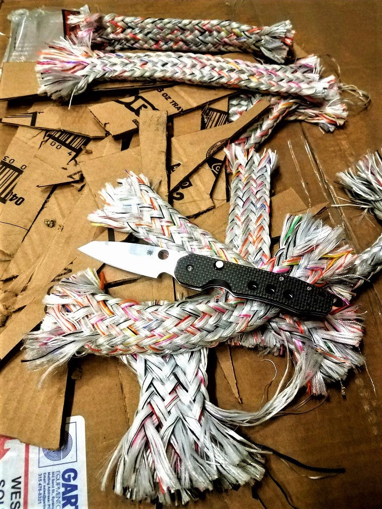

My weekly carry journey comes to an end today for the Para 3 in M4. I'm left thoroughly impressed! It was a fairly heavy work week this past week. I never once touched up the edge or gave it any passes on the strop. I finished up most of my work fairly early today and it was still shaving. The past couple hours I decided to try and dull the edge by cutting up various materials I can find around the warehouse.
Sliced up a few boxes into pretty small pieces, the brown paracord I cut 225 pieces. I used 75 cuts for the tip area, 75 cuts for the belly and 75 for the heel of the blade. The blue rope is heavy duty stuff, covered in a waxy finish to help keep it bound together. The Para 3 cleanly cut through those pieces while having to use a bit of strength looping the rope around my finger and pulling the rope towards myself as I push cut with the knife. Cleanly cut through every time on the first try. I finished up with various cuts of the heavy duty rubber hydraulic hose. My hand is now a bit cramped haha.
I ran my finger along the edge and it didn't feel very sharp. I thought, yes...I've defeated M4. I grabbed a piece of paper, and as you can see...cleanly cut it along the entire edge! I never really got to test the toughness of M4 I guess, but wow...this steel handled everything all week long, outlasted my hand in strength and still isn't done yet. I was very impressed with the results of the Manix 2 in 20CV a couple weeks ago, but I think M4 claims #1 of my weekly long tests so far.

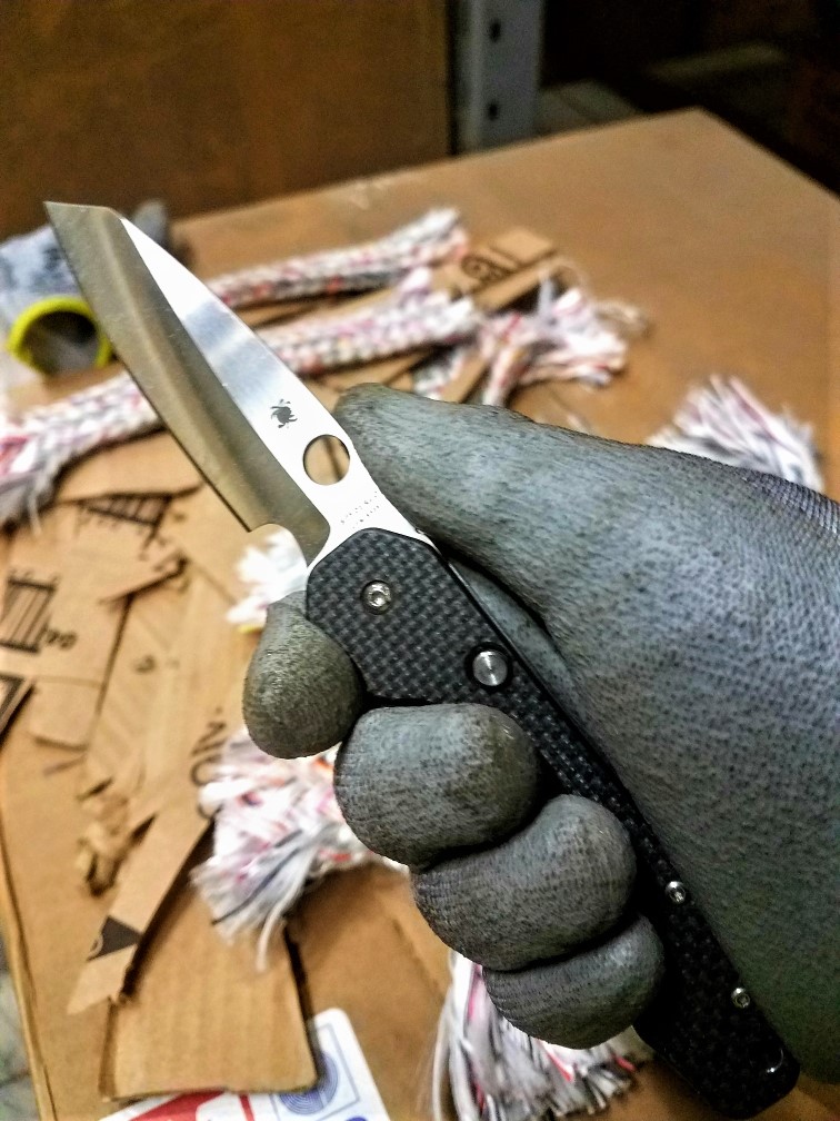

Finished the last 3 days of the week with the Smock in S30V after retiring the Caly Jr in Super Blue after 2 days. The Smock held up well, no problems cutting any of the typical warehouse type items. I really love how the Smock disappears in your pocket, takes up no space at all. I got bored a few minutes ago at the end of the day and decided to shred some cardboard and a bit of rope that was laying around...still cleanly cutting paper and shaving no problem after the past 3 days of use. S30V EASILY wins in warehouse duties over Super Blue, as well as the Smock over the Caly Jr (which was to be expected)
I also attached a photo of how I hold the Smock when using it. For me, this feels totally natural when using this knife and is quite comfortable. I know ergos tend to be a turn off for people when it comes to the Smock and don't think anybody should neglect this model without trying it for themselves first. Fantastic knife...awaiting some sprints!!
