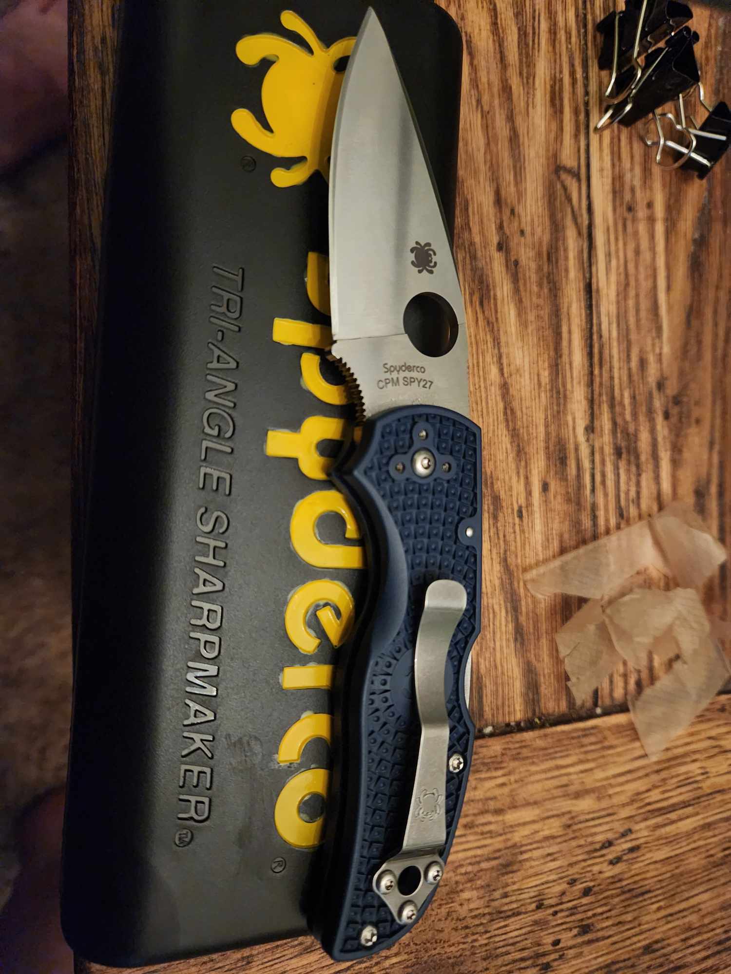

WyoJon
Posts: 251
Joined: Sat Jan 21, 2023 8:03 am
Re: Community Sharpening Journal
#1686
Post by WyoJon »
This new native 5 spy27 had uneven bevels from the factory, with an edge that was off center.
Corrected it with 120 grit sand paper ove the sharp marker stones. Cleaned it up with 220, then did the sharp maker progression to the ultra fine. Its set at 15 degrees and is now quite sharp.

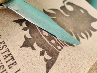

If you hold a machinists straight edge to the blade, you will notice the bevel moves on the horizontal plane inward towards the tip, as well as upward towards the tip. Keeping the arm and wrist locked while using sharp maker effectively allows the stone to skip right past that last inch without contacting it.
WyoJon
Posts: 251
#1693
Post by WyoJon »
Youll really see that effect on fat clip point blades such as this ka bar 1189
