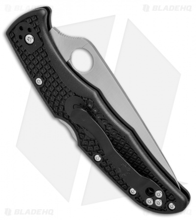

The Endura has the Native 5 / Police clip, period. The reason being that (lanyard hole or not), it allows access to the Pivot screw for tip down carry, since the Endura/Police pivot screw is slightly raised and adjusted on the clip side. The PM2/3 has a flat pivot screw which can be covered by the clip. Which is OK, since the PM2/3 D-shape of the Pivot is on the clip side, adjustment is done on the other side.
Endura with Lanyard hole:
Endura without Lanyard hole:
And the Native 5 G10 with SS liners:
So please correct your list otherwise it's worthless.
