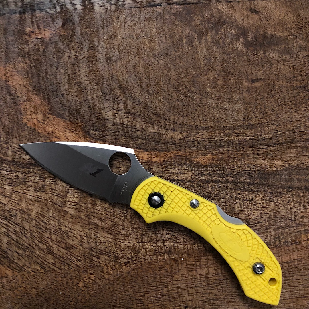

I can’t stop carrying my dragonfly 2 salt. What a killer knife. It’s actually a pretty cool thumb flicker...rockets out!
I would like to get another back lock spyderco with a longer blade at some point and I’m not sold on a delica or endura due to the apparent difficulty around disassembly. Does spyderco make a back lock knife that is as easy to disassemble as my Lil Native?
Cheers
Cheers
Props to you for some how keeping that H1 scratch free. My SE Salt 2 developed scratches very easily the first time I use it at camp, I believe I was just cutting through some plant matter type of weeds. After that, I began not to care how it looked.
