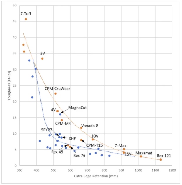

It looks like high hardness is all Rex 45 has over M4. The better toughness of M4 with very similar edge retention is an appealing combination. However, M4 has pitted on me and Rex 45 has not yet done that in my use.
That's not exactly a perfect comparison as that M4 was tested at roughly 61 and REX45 was at 67.5. 61 for M4 is a bit low to what we've seen from Spyderco (62-65) and the REX45 was higher than what we've seen (65-67). I bet if you bumped the M4 to what Spyderco runs it at, the toughness would drop pretty significantly and also become less stable at the edge. M4 gets a little wonky at the higher end of its hardness range when paired with lower edge angles. REX45 has the stability at the higher hardness to support the lower edge angles. As always, edge angle should be based on what you're using it for and it's going to vary from person to person. I've never experienced any chipping on REX45 at 15dps in my use, but I could definitely see it happening depending on the use.
