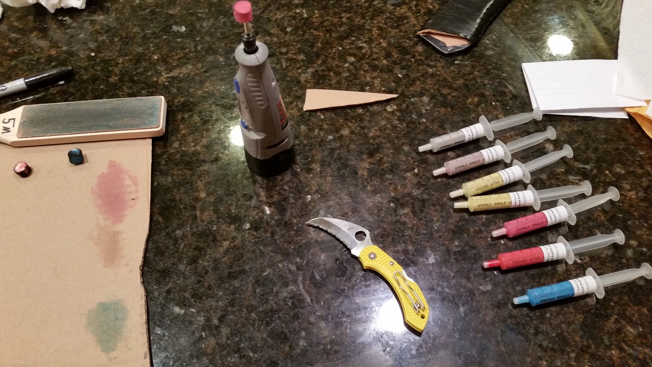

Hey Gruwolf, welcome to the forum. The corners of the white stones work great. I was skeptical using the sharpmaker for serrations at first as well. Just mark the edge of the knife with a sharpie so you can see where you're hitting on the bevel. Works great. If you want to kick it up a notch, I like to polish mine with a dremel and some diamond paste after I use the sharpmaker.

I'm gonna give the dremel stropping a shot this week. I have a few knives I was going to mod a bit on my day off so I'll have all my dremel stuff out anyways. I'll let you know if I can tell a difference VS hand stropping. SE H1 seems to respond well to stropping in general so I could see it being the case.

I use medium, fine, ultrafine sharpmaker stones. And most of the time I polish with a Dremel and polishing compound. That last step definitely takes the edge to another level. There is diamond paste? I should probably try that.
The Dremel method isn’t my favorite thing to do. I’d rather use another finer stone.

How's the diamond paste working out for ya? I have a bunch of that stuff that I rarely use for anything. I may pick up some extra Dremel pads and give it a go. Red rouge is just so easy and cheap.
It cost $22 on Amazon for the 7 syringes of diamond paste I got there. 5micron -.25m . It seems to be a lifetime supply, it doesn't take much paste to coat a strop or a dremel wheel. At first I was only using the 5M, but the last time I stropped I started using a progression starting with 5m, then 3.5, then 2.5. The results I got with 2.5 micron paste were impressive, every bit as hair splitting sharp as I can get my PE knives. I never tried to polish with flitz or my green compound so I can't really compare them to the diamond paste, but I will say I have gotten very good results with the diamond paste (works great on leather strops too). It also may be that practice makes perfect, and I'm just getting a little more steady with the dremel, and have the polishing angle dialed in so I'm really getting the corner of the wheel flush in the scallops.
Vivi wrote: I'm gonna give the dremel stropping a shot this week. I have a few knives I was going to mod a bit on my day off so I'll have all my dremel stuff out anyways. I'll let you know if I can tell a difference VS hand stropping. SE H1 seems to respond well to stropping in general so I could see it being the case.
H1 really does respond well to stropping and sharpening. It's the saving grace of the PE H1's. They dull fast, but it's ridiculously easy to get them back to razor sharp.
