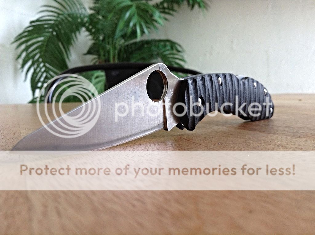

:D It doesn't bother me, but I know there are folks whose day would be ruined if they got something like this...Jazz wrote:Yes, I have a SB Delica that's like that, but I try to enjoy one side at a time. :pThe Deacon wrote:Except when they're uneven or not the same height of both sides, then they're just one more thing for OCD's to whine about. :DJazz wrote:Plus they look cool. Obviously not why they're done, but a bonus.
...especially when the other side looks like this...
