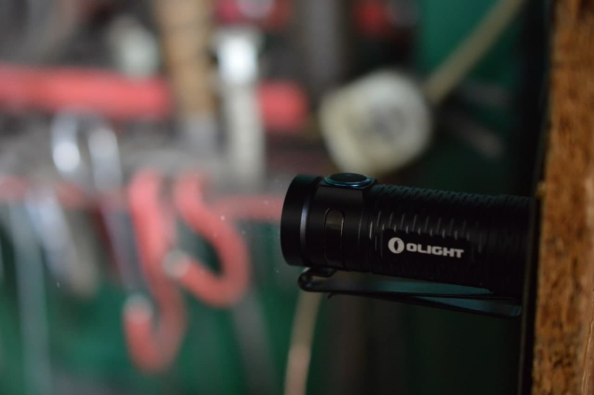

Very cool Mak. Love those pics! I have an OLight I keep on my keychain. I have been thinking of an upgrade to keep in my truck.

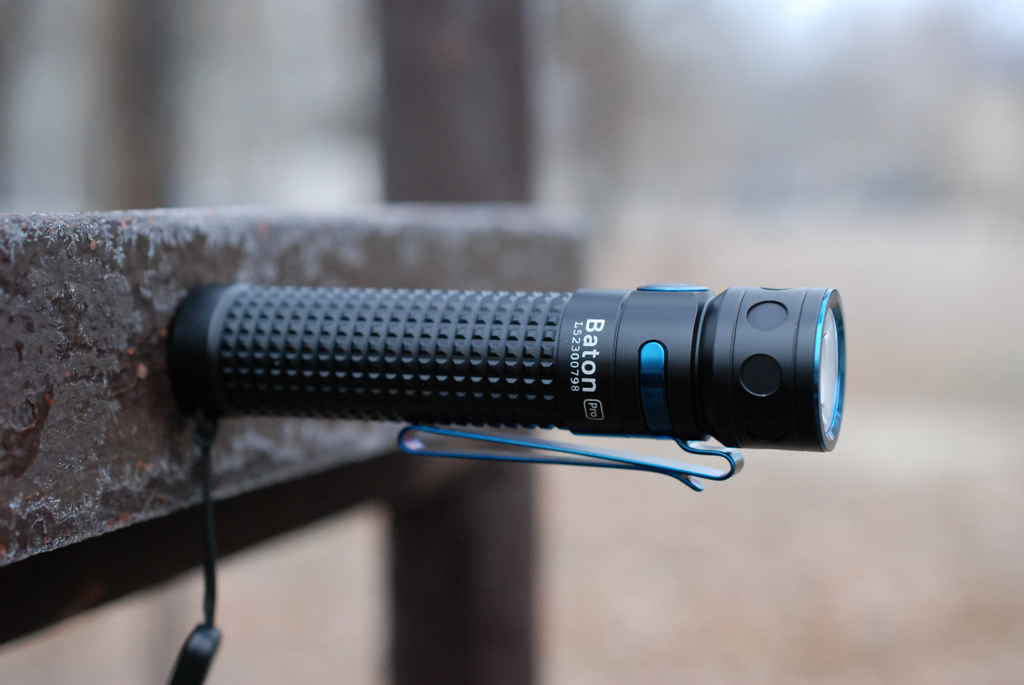

i had Olight Baton Pro, it was very cool🐋

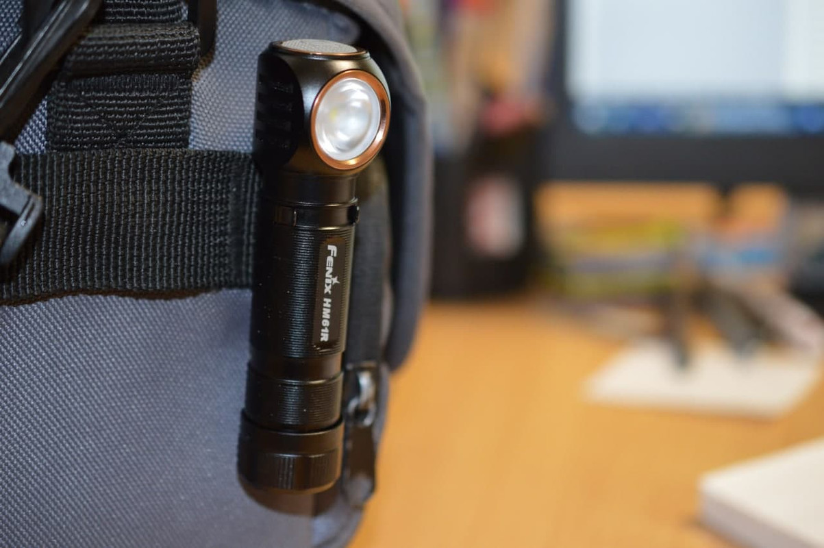

Great pics Mak!
