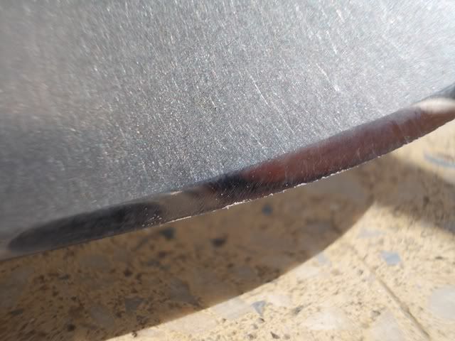

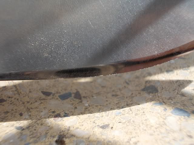

There are a few factors that can lead to chipping in my experience. 1. To low angle for the steel (either edge or primary grind) 2. Burnt edge 3. Improper heat treat 4. Burr that chips off 5. Wrong steel for application. This can be one on its own or a combination of some that leads to chipping.
The edge might have been burned when sharpening on a belt from the factory. This happens easier then one might think and I think can be applicable here. This however is resolved when one removes enough steel due to sharpening.
Secondly, what can happen, is that a carbide of some sort might have chipped out. This usually happens at very low angles. It looks something like this:
Photos from Cliff Stamp and published by Roman Landes.

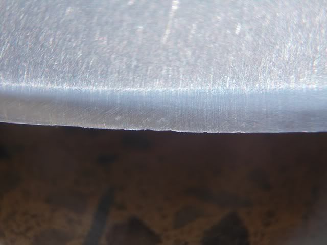

Here is a knife (not VG 10) that experienced chipping. This chipping can be seen easily by the naked eye and think it is more severe then yours as described:
