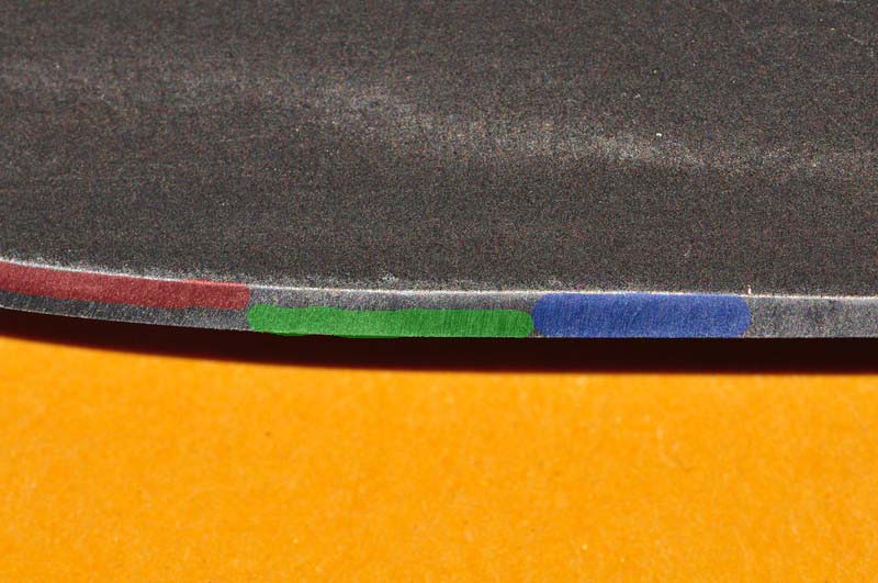

I stole one of Ankerson's edge pictures to illustrate. The blue "sharpie" is what is should look like when you apply the marker. It should color the whole width of the bevel.
The area of the red "sharpie" has the stones missing the shoulder and hitting just the edge (exaggerated for illustration). If this is what you're getting, then you are probably adding a microbevel. This can be good if that is what you're trying to achieve. If you merely want to sharpen at the factory angle, then it means that your angle is too wide.
If you get something like the green "sharpie", then you're angle is too narrow and isn't sharpening the edge. This is what you don't want to see for sharpening, but is what you want to see initially if you are re-profiling to a narrower angle. If re-profiling, it will look like this until you remove a lot of material off the shoulder, eventually working it down until the stones contact the whole width of the bevel.
What you want to see, when re-sharpening to factory, or whatever the current edge angle is set to, is the non-marker part. When you remove all the marker, it means that the whole edge is being sharpened.

jabba359 wrote:I stole one of Ankerson's edge pictures to illustrate. The blue "sharpie" is what is should look like when you apply the marker. It should color the whole width of the bevel.
