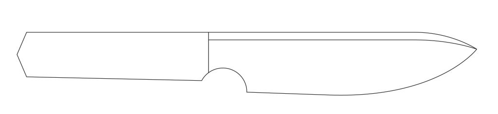

This is what I was thinking:
But I might try for something more like the ranger RD6. We'll see. It's a long way off, so I have plenty of time to think about it. Or the Bushcraft, like you did.

jossta
I think that the knife in your drawing looks great but needs a lot of precision work and will be difficult to be handmade just with basic tools cause it looks like having a full flat grind. Also the ranger RD6 style blade has it's difficulties from what I can see. You can certainly draw it on the steel cut it out and than work on the grind... but I would start with something more simple like the Buchcraft style blade!!! It is more forgiving while you work on it and you can improvise more as it goes. (I worked again on my Bushcraft knife today again and thinned the handle a bit more and made the finger-choil deeper and the drop point a bit steeper).
Another reason is also to get familiar with your tools, the different types and grits of sandpapers and to get a feeling how the steel reacts to different techniques (pressure, directions when working on it and how it heats up while doing so!) Also to memorize your own muscle movements and the different angles you have to work on both sides!
I suggest that you start with a bushcraft knife and you'll love it!
I might try building a design similar to the one you drew and I keep you up to date how it works out!
