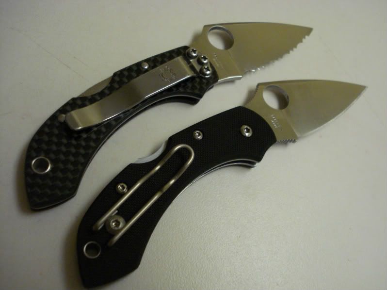

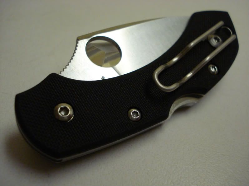

I can't take it anymore with the foliage green G-10 so I took it upon myself to change things up a little:

i have never loved black more :D looks beautiful!

Custom scales, or RIT? :D

The Deacon wrote:Custom scales, or RIT? :D
It's RIT dye. And now that I've seen how it turns out, I'm tempted to buy a Rock Lobster and dye it black as well :D

Nice! Any process notes you can share? How did you prepare dye, how long left in, etc. ?

It was black Rit dye, in liquid form (came in a little bottle), did it in a pot on the stove, the water was not boiling, but kept at a temperature of approx. 170-180 degrees F. (kept measuring with a temperature gun). Probably left the scales in for about 10 minutes or so. Yes, I wanted them deep, dark and black. They are impossible to see once you drop them in, so to check on them I had to keep pulling them out. Once they were done, I pulled them out, rinsed them off, dried them off thoroughly with a hair drier, then re-assembled. :)
Hope this helps :D

It will be interesting to see how the dye holds up. At least some of the folks who have done it to FRN seem to be reporting that it has held up well for them. Don't think G-10 would be any more porous than FRN, but it might have less natural lubricity. Generally speaking, nylon is one of the worst plastics to paint.

A tip for the scales take a hanger and bend it through the screw holes carefully of course so you can just dip them and swirl then around them check them periodically thats how i did my spyderhawks but i submerged the wholes knives RIT does contain SALT so be aware if you fully submerge non h-1 knives RINSE AND OIL THEM WELL
VashHash
Posts: 4996
Location: Louisiana
Post by VashHash »
and a side note if you scratch it the original color will come back
