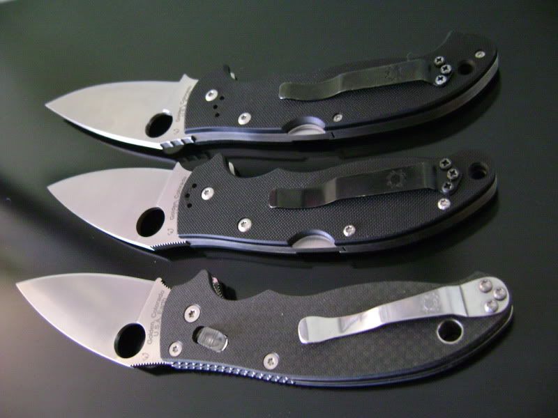

I have done this a few times now, I tear down the knife, put a piece of
wet & dry 3M sandpaper on a sheet of glass, cover with water and work in a figure 8. You might want to start with 320 grit to knock it down. Higher polish, just go to higher numbered paper. The Mili below went to 600 after coarser paper. Just remember to keep it wet. (so you don't breath CF dust)
Here is a photo of the 1st one I attempted last year. Have made Mule scales as well. CF is tough, but not too difficult to work with at all.
