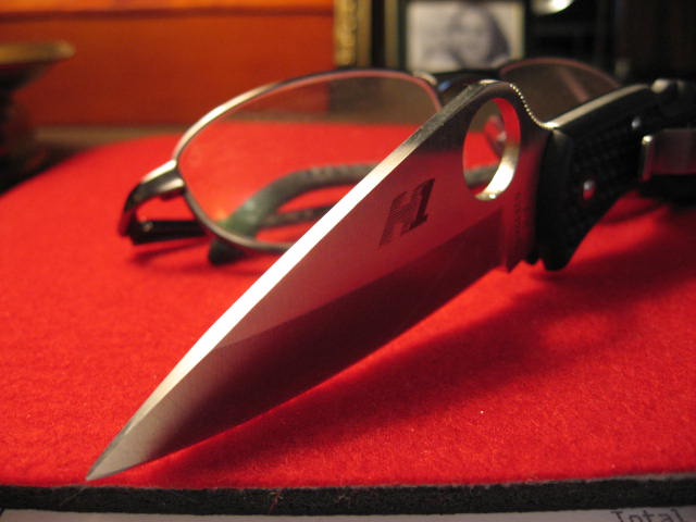

Easy way
Post by jeff189 »
I think I just found the easiest way to have a pointy tipped salt.
salt tip.jpg (70.88 KiB) Viewed 4053 times

jeff189 wrote:I think I just found the easiest way to have a pointy tipped salt.
Thats cheating! But nice ladybugs :D
