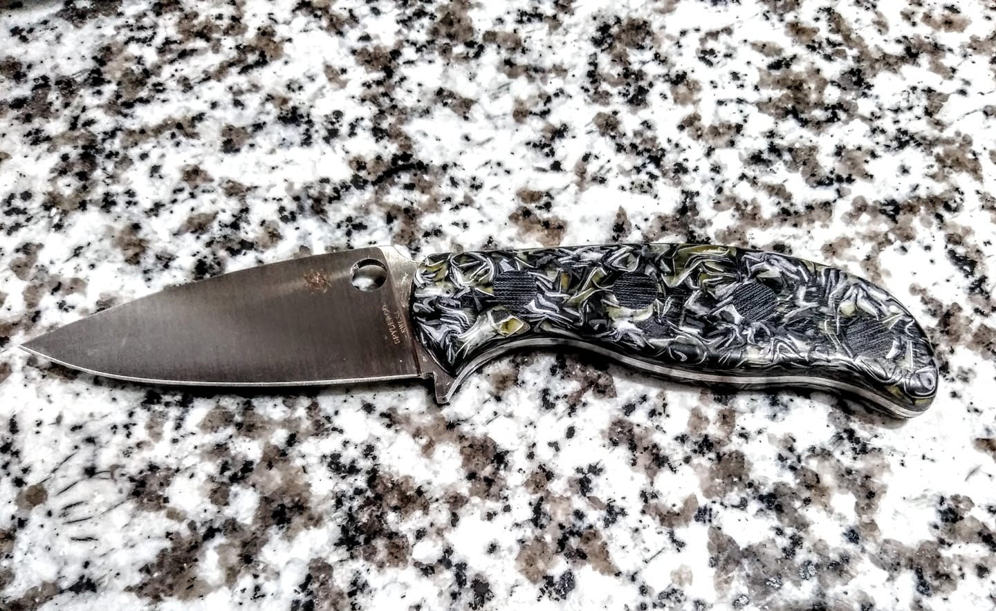

I've been away from this forum and others for far too long. Moved, 2020 happened, garage not set up to work on knives or anything else. I finished this one in RWL34 with urban camo KVH series Tac-Cam scales,probably three years ago.

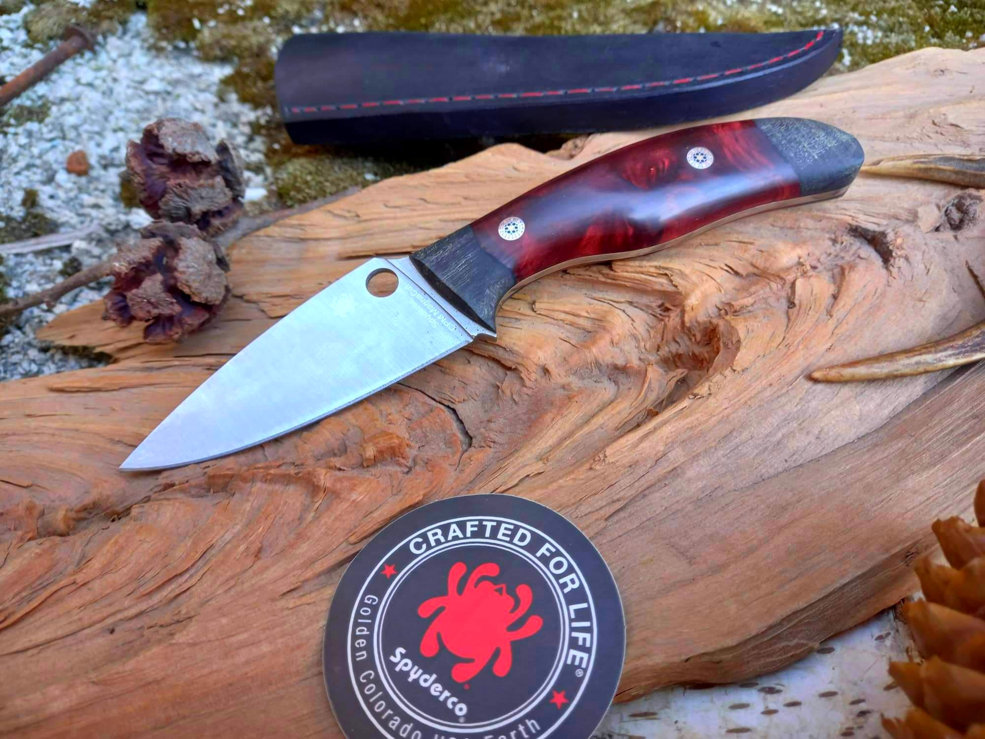

This is another Mule I finished on 22 August 2020 (an otherwise awful day, that's why I remember the date). This is PD1 with kirinite scales; red, white, and blue G-10 liners and pins. Went with the patriotic theme.

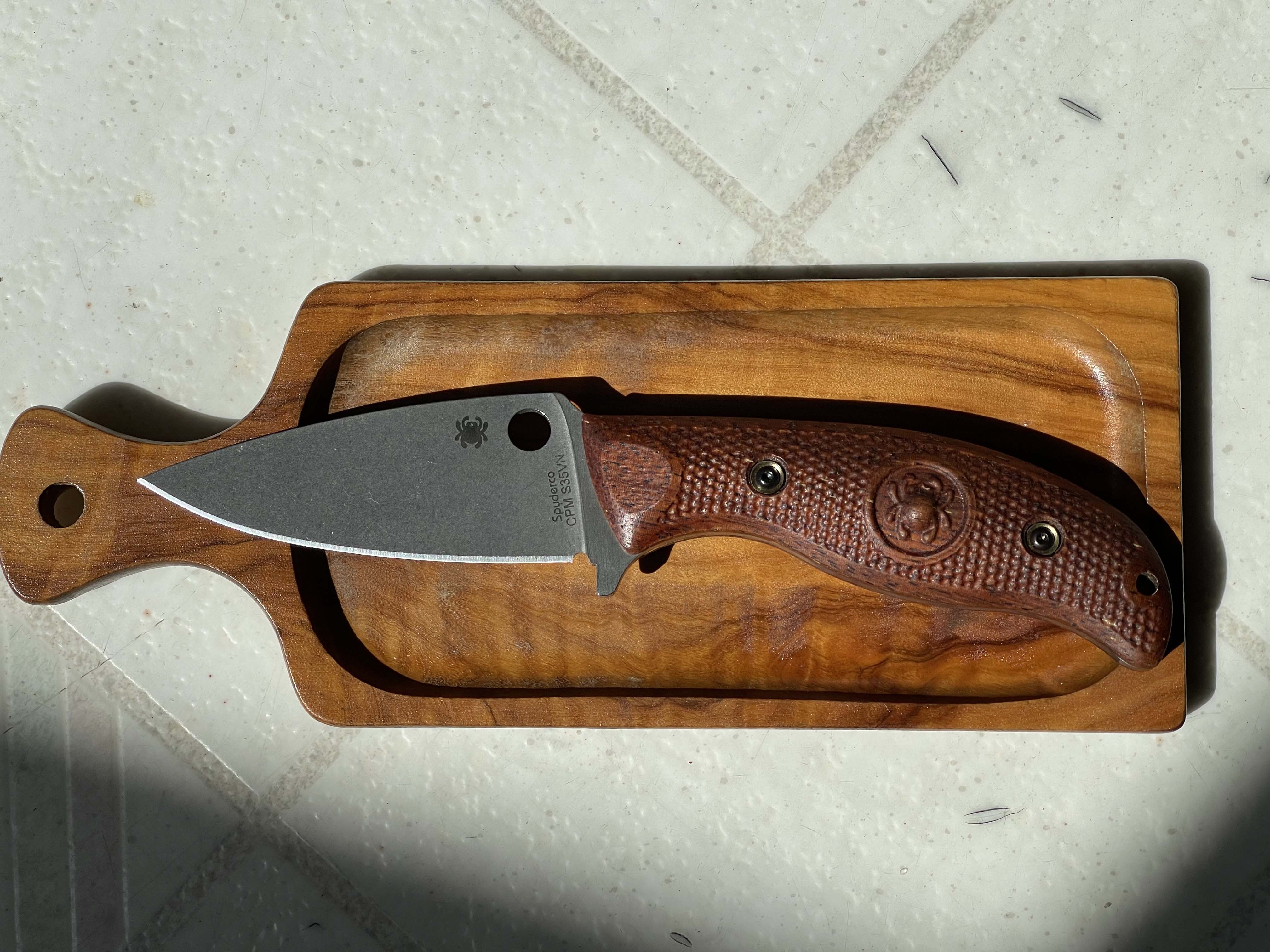

Factory second 52100 Mule I finally gave handles to. Since the small holes are a different size from other Mules the Halpern scale hardware doesn't fit. I had tried to expand the holes to fit the hardware but it was a futile attempt with just a hand drill, so I got different hardware and modified the scales instead.
