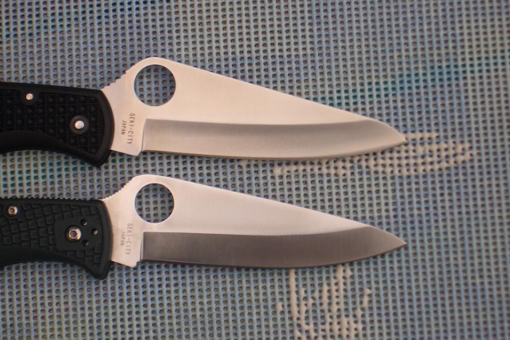

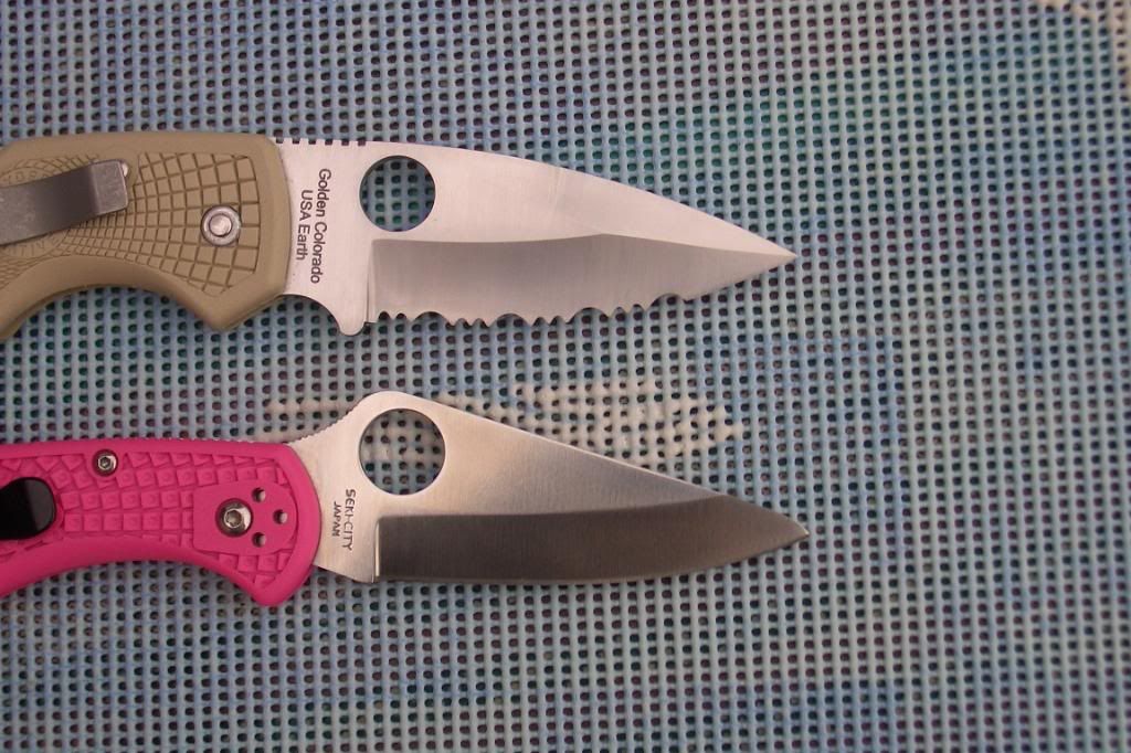

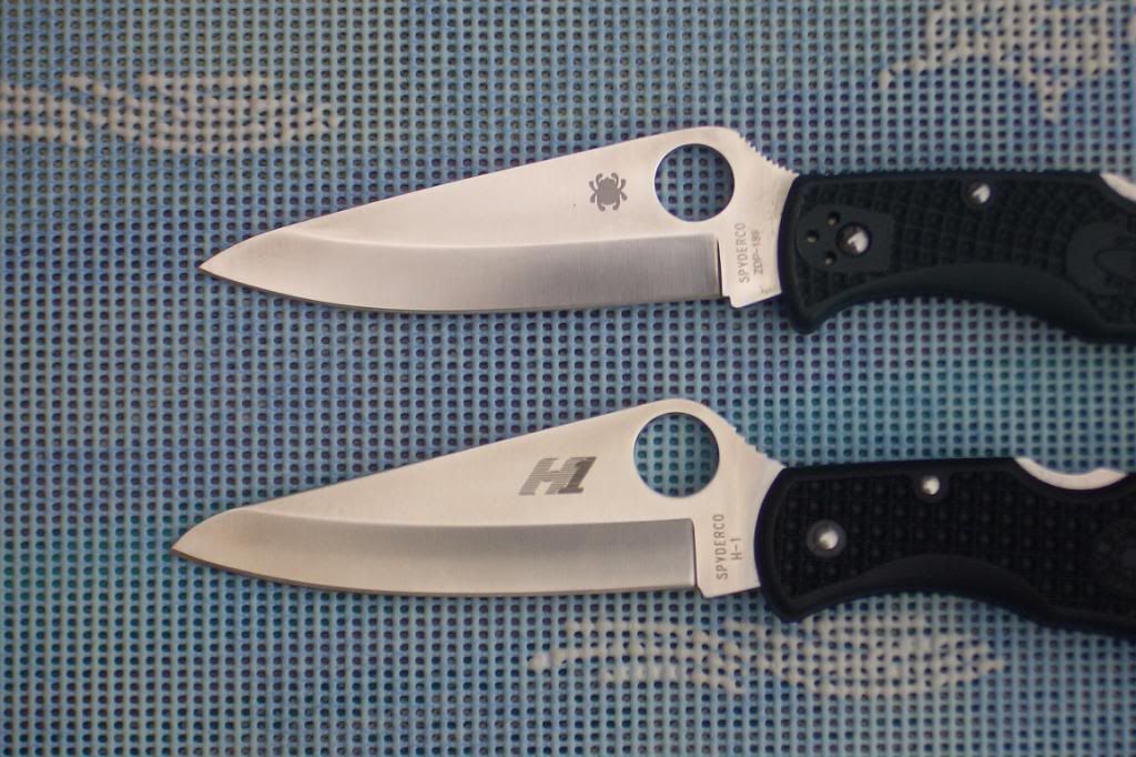

Ok, my OIF Native is here, and I love it!
(I'd want to be the purchase seen as an act of respect for the soldiers who risk their lives everyday, not as a disrespectful pretension or arrogation on my side.)
Anyway: NOW with the non-coated blade, the HOLLOW grind couldn't be more obvious :eek:
And as a sidenote, the action of this Native is SO MUCH better than that of the Black bladed Native! It opens smooth and without the "roughness" I was used to with the C41BBK. I think that this problem is due to the coating, but it is kind of annoying sometimes...and on top of that, the OIF Native is clearly on a different (=better) sharpness level. I'll call this "Scary Sharp" anytime!
@enyong112, if you want to, I'll happily post a pic of the hollow ground Native (and Salt :-)) next to a saber flat ground Delica or Endura to show the differences on a picture. In fact, I never paid too much attention to this difference before :o
Dennis
Dennis
