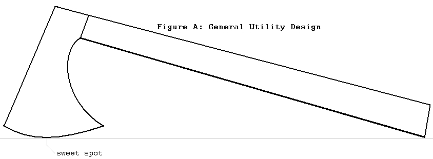

One thing that is important in the design of an axe* is the sweet spot. For a general purpose design this means the middle of the edge.
Because the axe describes an arc during chopping, the edge must not be parallel to the handle but parallel to a line that runs from the sweet spot to the butt of the handle. So the edge has to be canted towards the butt of the handle. See Figure A.
The edge can even be more acutely canted for a "draw cut" effect. The "draw cut" is a mix of push cutting and slicing. Chopping is a kind of push cutting, however, if the edge is presented at an angle the cutting power will increase (IIRC by 40%), that's why cigar-cutters and guillotines have an oblique blade. See Figure B.

The edge must not be canted towards the top as this can lead to accidents. During a careless strike one may hit short causing the edge to slide off the tree and come back towards the user. :eek:
A favorite design of mine is the Francesca. See Figure C. It combines draw cut capabilities with good sticking potential when thrown. The upsweep on the top allows the Francesca to stick when other axes have already overrotated. See Figure D.
