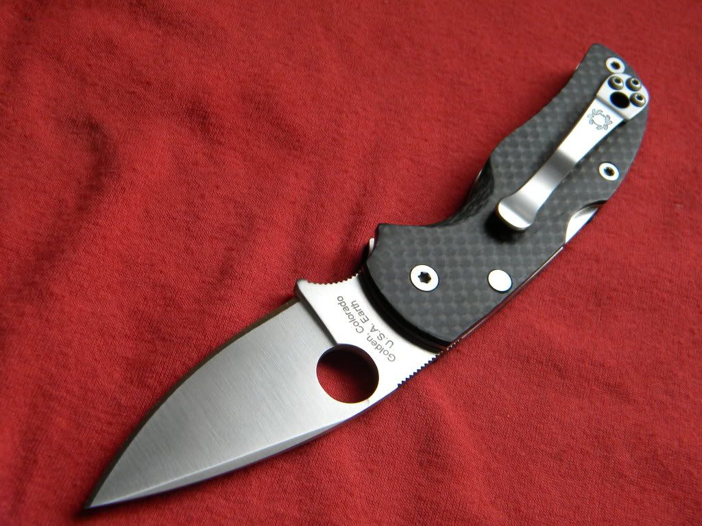

Here is a pic a friend sent me of his Manix 1 dye job, to hold everyone over. I think you will be amazed at it. I was.
This is from our friend Korbiak. Gorgeous, isn't it!
A follow up on the Manix 1.
I am stupid. My eyes kept telling me TI scales, but my brain was in denial as I just couldn't get a full custom TI for the Manix. 1.
I just found out that that this is an STR custom TI knife from 2006-7. I learn something new everyday. Isn't life great?
The only reason i am posting is to say that RIT dye remover will work about 90%. I almost have it back to the original green. I don't think it will go totally back, but it will be close. 20 minutes in the soup "on the bile" as my father would have said..
I have to go get the Denim Blue like I should have just left alone in the first place. When I post pics, I will also give you guys a clue about dying the scales. pretty neat. I just blew it because I didn't know it would work and over did it. Will post pics later on this morning.
I am still learning

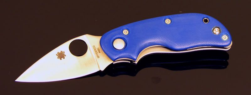

Flamed TI. I overheated the TI a bit and got it too dark, and there is a faded line of Magenta under the clip. Scale has been dyed Denim Blue.
