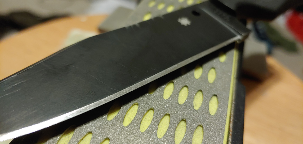

Vivi you're a sharpening mad scientist, man. I bought the Xtra coarse DMT stone a few weeks ago because of your video and now I happened to have that Harbor Freight 4 sided sharpener laying around. Did one knife with 300 and another with 400 and they're both screaming sharp! They were S35VN and 154cm. Thanks again man for constantly testing new things and sharing it with us!
Glad they're giving you good results!
My Siren lost its aggression pretty quick with the 1200 grit edge. Broke down and gave it the 300 grit treatment last night. Cutting much better.
This week I plan to fully reset the bevel on that and the S110V Para 3.

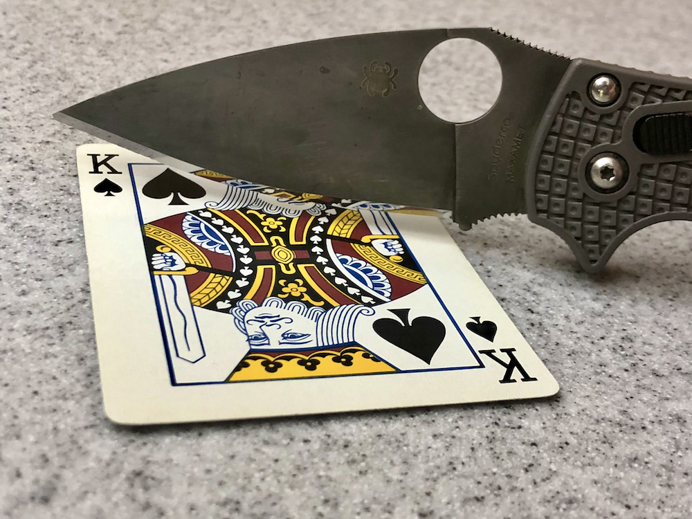

These two knives have been seeing the most use over the past couple weeks. The Native 5 in REX 45 is in my shorts pocket after work. Most recently it's been hacking and pruning small plants and woody things. Diamond Matrix stones are the answer for this material. I can leave it at 250 or take it up to 4k, depending on my mood. Either gives a satisfying edge. Today I rubbed it on some 1 micron and 0.25 micron CBN, just because. It's kinda sharp now.
The Manix 2 in Maxamet is for work, and it sometimes it touches copper or brass. That's how it gets those little chips towards the tip. I don't clean it up completely because that would use up a lot of material. Consider the chips like serrations -- Maxa-rations. I use the same diamond matrix stones as on the previous knife. Normally I leave this edge at about 650, but not today.
Sometimes I'll use diamond plates if I want to remove a lot of material fast, but there's a downside. Even when using fine plates, there are deep scratches and microscopic chips. I think this is because the diamonds, even the small ones, sit high on the plate, so they gouge deep. With a matrix, the area between the diamonds is filled up, so they don't sit as high, and are gentler on the blade.

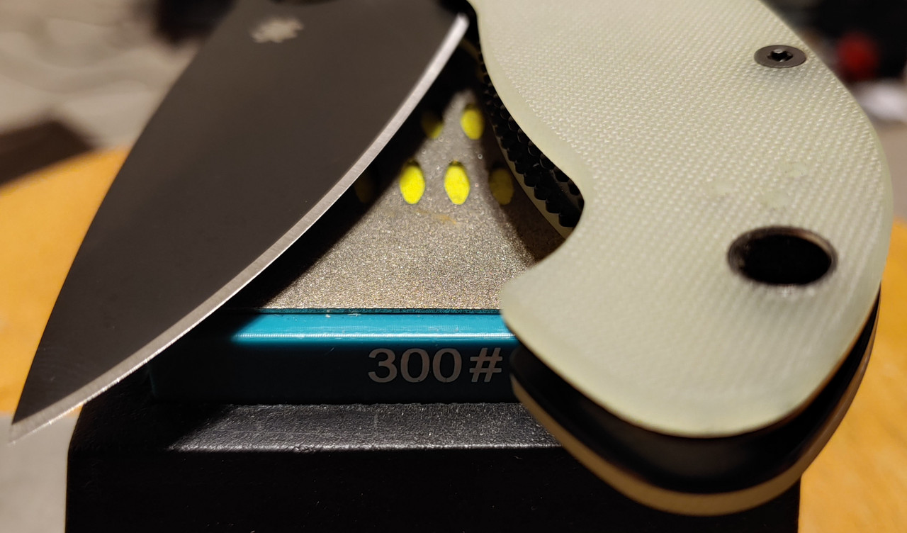

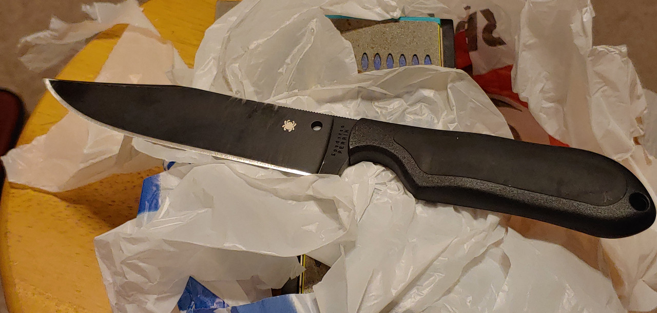

Been going through my collection and converting all but a few special use knives for low grit edges.
Tonight I did my Street Bowie. 200 grit diamond plate for the bevel at roughly 12dps, then I switched to 300 grit for a roughly 15dps microbevel, then stropped with 7 micron diamond paste twice per side. Hair popping sharp and slices very aggressively.
I've been testing my edges on plastic shopping bags instead of paper lately. They give me a good idea of how refined the apex is by how much effort it takes to initiate a slice into them. Poorly formed edges require holding the bag with tension to help start the cut. Coarse, well apexed edges don't care about that and bite right into it.
On deck I have my M4 Manix XL, S110V Para 3 and Siren, all set to get similar edges.

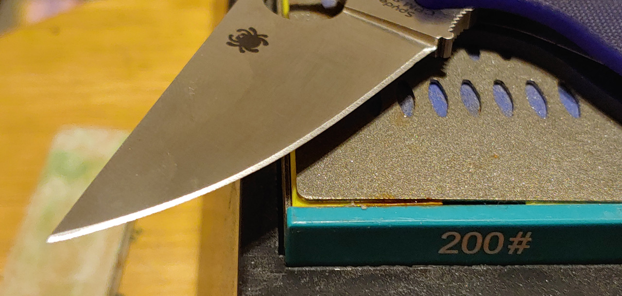

Just knocked out the Siren.
Cut into a DMT fine to dull the edge.
Grinded each side on the 200 grit plate until I raised a burr on each side.
Slightly more obtuse angle for three strokes per side on the 300 grit, alternating sides each pass. Edge leading.
Two strokes per side on the strop.
Here's me testing it out on a plastic shopping bag - https://streamable.com/oq9zzf
One more. As soon as something slides across these edges they're cleanly sliced - https://streamable.com/p242lb

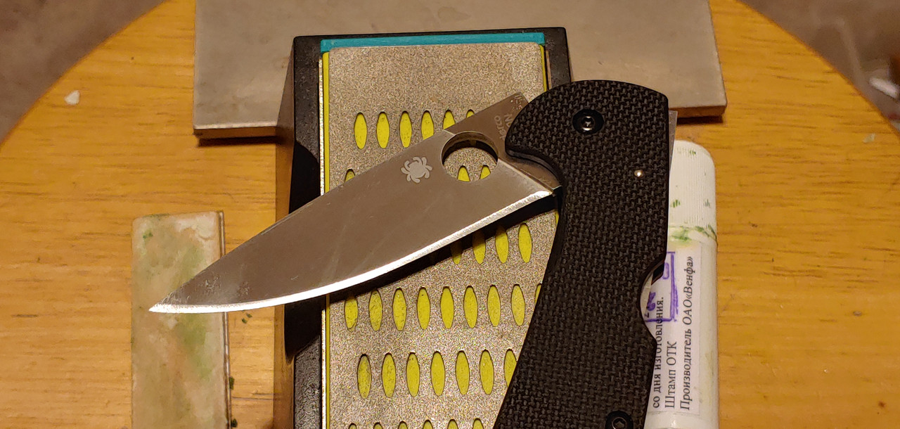

Well this was interesting.
Got the bevel on this S110V Para 3 about 90% reset in under five minutes. I thought it would take a lot longer but it didn't really feel any more time consuming than S30V on this stone.
I'm going to work on it more tomorrow. It needs a bit more grinding to repair some chipping by the plunge line. But I'm pleasantly surprised at how quickly S110V is grinding for me on this stone.
I'm excited to see how it cuts when I'm done. The plan is to finish resetting the bevel and repairing the edge tomorrow, then give it a finished edge and test it out. I want to see how the toothy S110V edge holds up to slicing large quantities of cardboard.
From there I'll probably just touch up the microbevel with a handful of strokes at either 300 or 400 grit, strop, then mail it back to where it belongs. I'll update my Para 3 thread this weekend.
