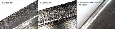

Ok, I decided to give it another go on manual sharpening this material. After the first session, I think I did not change my technique enough and was likely applying too much pressure in general. So today's plan was to do a 16k (1um) stropping on how I left the Rahven, and check under the scope, just to see what it might look like. Then start low again and work my way up from 1200-4000-8000, then re-strop on the microfiber block loaded w/16k.
Spoiler alert - I got set-back at each grit change, essentially back to baseline. So, somewhat rookie mistake here, but my 4k and 8k diamond plates were new, and they cut far too aggressively before being broken in, despite the super light pressure used. I did, however, get some positive feedback on the 3-finger test (indicated in each pic either + or -), which, unfortunately didn't necessarily translate into smoother cuts on paper tests. The knife was always able to push-cut paper, just varied in smoothness.
First, the 1200 worn stone probably had the best overall results. It will be interesting to see how the other plates do once they wear in.
Round1 - 1200k (well worn from previous session):
Set back after trying to progress to the 4k plate.
Round 2 - 4k (new):
Again, set back a bit, but you can see progression in both the preceding 4k series, and this 8k series.
Round 3 - 8k (new):
So initially the stropping seemed to decrease the sharpness, maybe due to the give of the microfiber, allowing it to curl over a bit on the apex, the pics seem to indicate this.
Round 4 - 16k stropping (new block and media):
I went much lighter and decreased my angle a bit, and I got it back up to 3ft+ grippy.
Round 4-2 16k stropping to 3ft+, +bonus pic:
I am starting to think a very high grit, somewhat worn diamond abrasive may be the way to go, start to finish. By hand it will take a very long time, so might need to try some belts in the shop.
Also, for giggles, I tried to see if I could use my hardest waterstones to do anything, maybe polish, or rid myself of some of the toothiness. As expected, absolutely not. Don't even bother.
I might add some additional commentary to this or just do another round of testing, but either way, more to come! The edge on this material isn't just a ghost, it's ethereal. I need to find a proton pack to get this thing honed in...
-burly

burlyspyder wrote:
Sun Feb 18, 2024 12:26 pm
I got a nice mirror polish from my Shapton Kuromaku 2k. It seemed to get a lot of the micro-chipping out as well, but after a certain point it just kinda stops doing anything to it.
I tried for I don't know how long to coax a decent edge out of it with a 9 micron DMT hone. Tried super light pressure, edge-trailing only, etc. Best I could get it to was 200 BESS and too smooth to really pass a 3-finger test.
I'm over this one. If it's this much of a pain to get it decently sharp, it's not worth it to me. I figured that the real challenge would be on actually abrading the material, but it just doesn't work like steel, and I am not really keen on learning to sharpen it. I've just decided to resell it.

kennbr34 wrote:
Mon Feb 19, 2024 9:36 am
Interesting - I only tried stropping on the stones given the previous advice. So, I spent an hour or so working the material on some waterstones. First, I tried 1200, and it does actually cut, but the edge becomes very chippy. Then I tried the 4k, and it started to polish reasonably well. Still pretty chippy though.
Then I thought - if the edge is so thin and brittle, we should NOT have slurry on the stones. So I left a very light stream of water on the stone as I worked on the 4k, and the results are promising, albeit slow. I am polishing out the previous grit scratches, and the cuts are getting smoother. Following the same line of thought, I can feel tiny chips/grit on the stone develop if my angle gets a bit too high or I get too close to an edge on a stroke, and they are very tiny pieces of the HIC. My hypothesis: When you go over a tiny HIC chip while sharpening, it creates new chips on the apex, leading to perpetual chipping...UNLESS, you keep the stone very clean during the process. This feels right to me.
Here is the 1200 progression:
Then, switched to 4k. Notice the polishing as it progresses. I wish I had a 2.5k stone to have something in between, but this shows that the waterstones do actually work, and the 1200 worked surprisingly well in a short time:
All that said, I am now thinking that essentially polishing this to sharpness is the way to go, similar to my previous thought of very high grit (50-100k) on a leather belt. I also strongly suspect I need a more obtuse angle at the the apex to reduce the micro-chipping. I might get into the shop today to play around some more and will post results.
-burly
